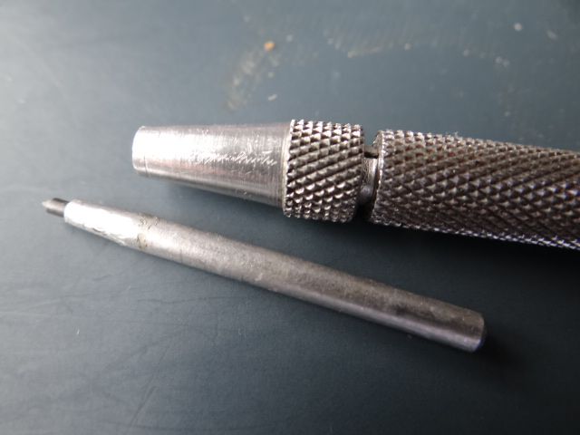

      Photo is of my inexpensive scribe, a tool specifically made for scratching lines in steel.
      No doubt here, but even a scribe isn't expected to last forever. And unlike a Mitutoyo this one came with a spare carbide tip…
      More dubious advice. As Digital Calipers are made of stainless steel, I confirm its OK to stir Sulphuric Acid pickle with them. Not having to find a plastic spoon will save loads of time, but who wants to take the risk…

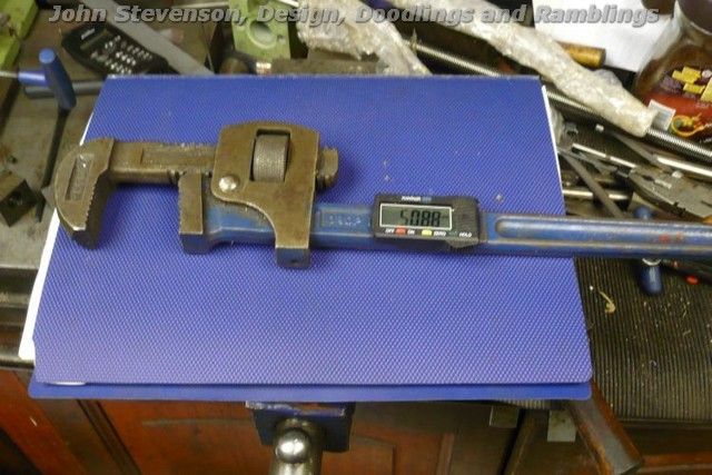

                                Didn't John Stevenson modify a digital calliper as per Jason's link? I've looked through a hundred of his posts but not able to find it before boredom set in! Best I could find is the picture below just to show his sense of humour.
                                Cheers Michael

                                      Hi Michael Horner, second post down John's El cheapo digital is the one your thinking of I believe.
                                      Regards Nick.

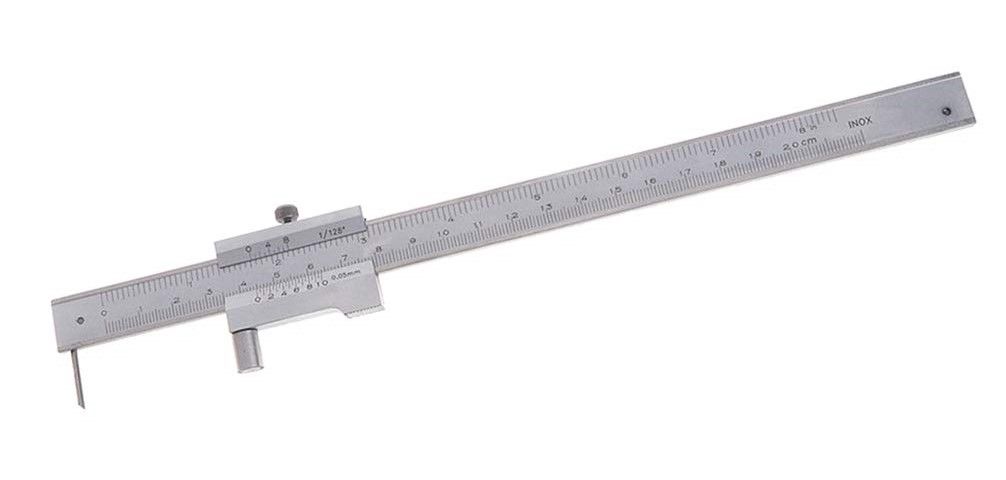

                                                I bought one of these a few years ago, was very cheap then, about 10 euros, complete with sheath and spare scriber:
                                                it has a couple of advantages versus modified regular verniers, the roller and adjustable scriber "height".
                                                Massimo

                                                  A small world: I bought one as well a week or so before Christmas. About £13.00 on Amazon.

                                                      You could always purchasing one of these: https://www.banggood.com/0-200mm-Measure-Scale-Ruler-0_05mm-Accurate-Parallel-Line-Digital-Vernier-Caliper-W-or-Case-Woodworking-p-1425961.html I have one and have used it a ton. Works great and comes with an extra carbide tip, I repurposed into a handheld scriber.
                                                      Edited: I just noticed the one I purchased is discontinued, but there are plenty of others that sell the same thing.
