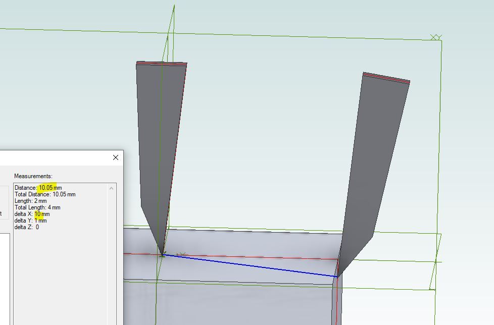

                                        Not really a bad smell just pointing out that it may not do what the Doc wants.
                                        " Transferring a reading to other calipers or dividers would seem to introduce an error, so"
                                        This would seem to suggest he wants a fair level of accuracy as even the cheap callipers compare quite well with name brand ones in the accuracy of their measurements. As a couple of members including myself have pointed out unless the calliper is modified to have the fixed leg shorter you won't get your scribed line positioned from the edge by the amount shown on the calliper so may as well use an oddleg or Jenny set from a rule.
                                        Look at this sketch, 20mm wide bit of metal and wanting to mark a line down the middle, if you set the calliper to 10.000mm it won't mark down the middle, it needs to be set to 10.050 assuming moving leg 1mm lower than surface. It's basic schoolboy geometry.
                                        Certainly more error than you are likely to get between two callipers so won't suit the Doc but often good enough for a bit or roughing out.
                                        What you actually do with your tools is upto the individual but if you think you are getting a line the distance in that is shown on the screen then think again or modify a cheap Aldi/Lidl pair.

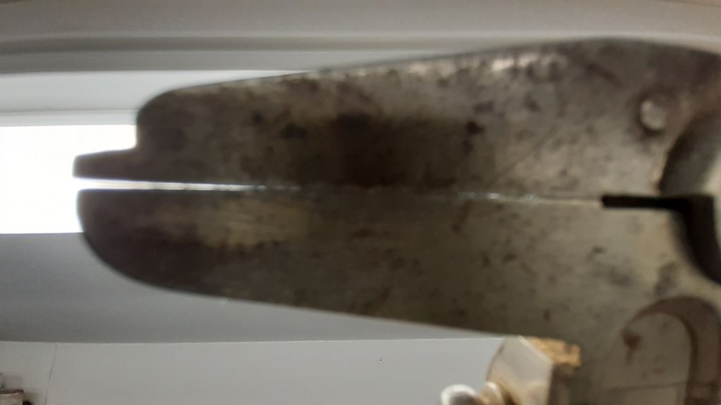

                                          I suppose this is what can happen if you use them to scribe too much or take live measurements off rotating work, my Dad must have bought these 70 odd years ago but I don't know if they were new then or seconhand/surplus.

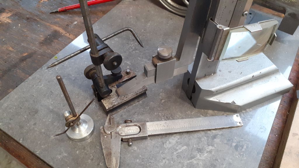

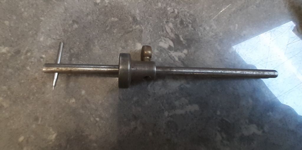

                                          While on the subject of marking out I have had a dig into the back of a draw and this is how my equipment has evolved over the years, on the left a homemade scribing block from "unimat lathe projects" then an import one and finally an import height gauge.
                                          And for marking along an edge this one again from the Unimat book which is similar to a carpenters marking gauge
                                          I certainly used the Unimat items and even that old vernier calliper to build my 10V as schoolboy pocket money was limited and that will run simply by blowing into it. Most of the Stuart Beam would also have used them and I think they were superseeded during the Minnie build
