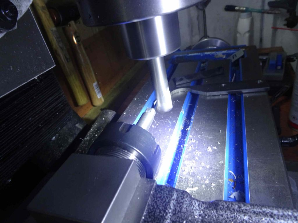

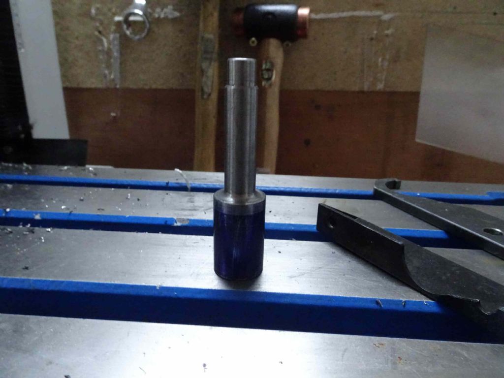

                                                I confess that I still don't think I've 'got it' as far as threading is concerned and my initial go at internal threading was a mess.
                                                So I thought I'd make a tap for the inside.
                                                I had some nice silver steel spare from my Steam Engine crank. This was lathed into a basic shape
                                                Then the end squared off
                                                Then a thread put on

                                                Next I used a ball nosed mill to cut some slots and prepared for heating
                                                Tap here on the hearth, wrapped in wire and gummed up with Boric acid with a bit of meths.
                                                If it's good enough for Chris of Clickspring, it's damn well good enough for me.
                                                Next a heat up and a dip into some sunflower oil.
                                                In a spirit of full disclosure, my first go at this didn't go se well and a file could cut it, so once more into the heat. This time it worked better and I cleaned the boric acid in boiling water and then dipped it in Acetic acid for a day or so to get the scale off. I think I could probably have left it in for longer.

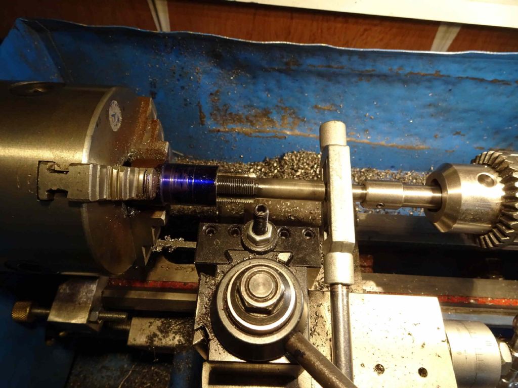

                                                And here we have it cutting a thread. Again in a spirit of openness, I actually cut the bulk of the thread with a lathe tool and mainly used my new tool as a plug tap. It seems to have worked well enough
                                                And here is the piston gland inside and outside! The two parts screw together well, though I fear that the outer part (this bit) got a bit nudged in the process and may not be fully concentric. We'll find out when I put it all together!
