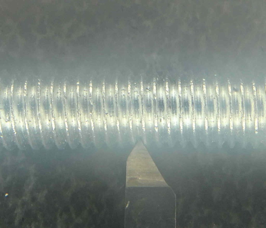

      Sounds like you have the correct setting for 29 degrees. The other issue will be spring in the bar. It is usual to need a number of spring passes with the tool. If you keep all settings the same and do more final passes is the tool still touching the bar or removing material? For long threading jobs a moving steady is useful.
      Martin C

                This thread is pointless without pics of your threads and of the lathe set up and tooling you used to make them. Otherwise we are just guessing in the dark.
                It's like the 10 blind men describing an elephant from feel. (I'm usually the one at the back saying "An elephant is about the size and shape of a football but warm and steamy.&quot

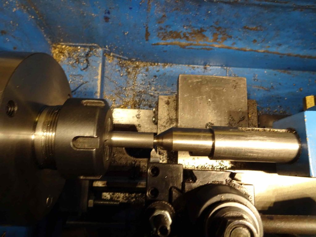

                    So I took some photos.
                    This is my topslide / cross slide setup and I think it's right.

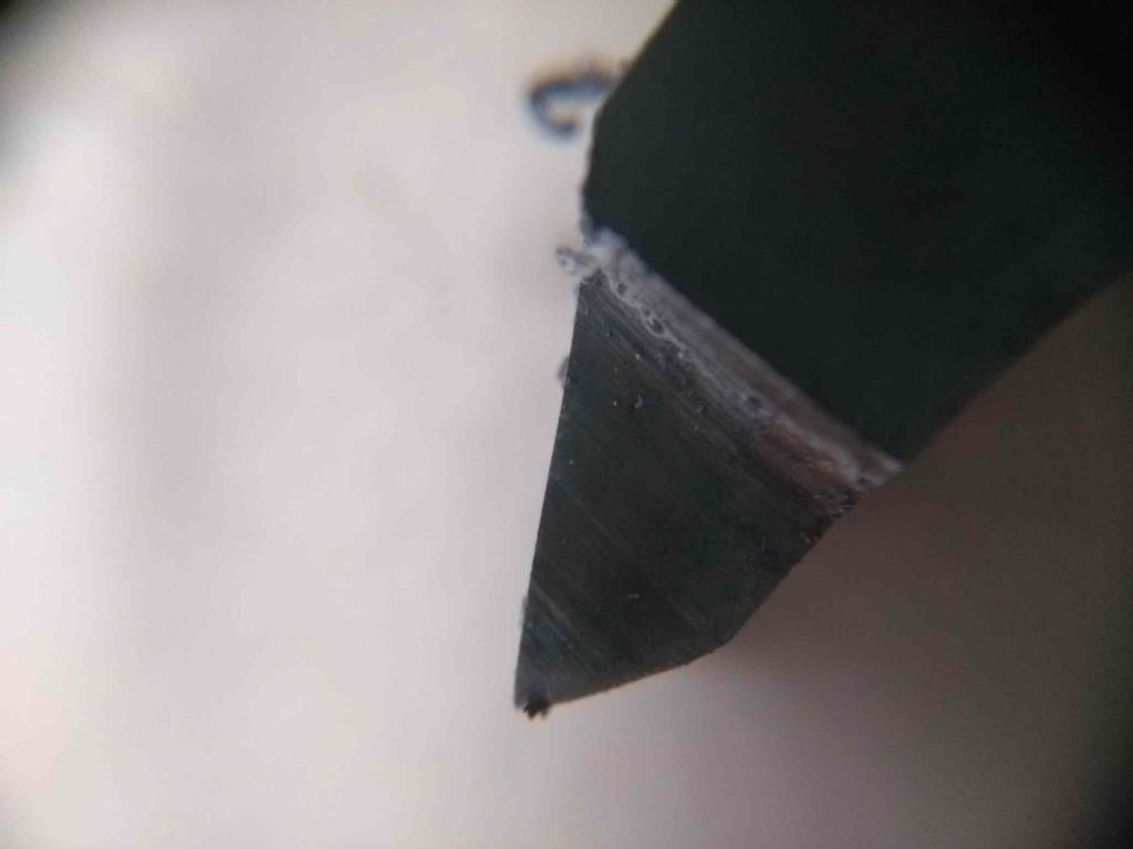

                    This is a close up of the cutting tool
                    Which I think you will agree looks like it has quite a sharp point.
                    To give you and ideal of scale here it is in a QCTP holder (a 000 type). I think the main body of the tool is 6mm across.
                    So I expect I need to round the end. How do I know when I've rounded enough?

                        Did you use a tailstock centre while cutting your thread? If not, deflection of the job away from the tool is almost certain, which could be the cause of your problem or at least part of it.
                        Threads in the pic, although a bit blurry, do look about half depth or so.
                        Is your cross–slide handle one of those that has the graduations that show reduction in the job's DIAMETER rather than the actual distance the tool is moved inwards on the radius? The way you set your thread depth described in an earlier post would result in a half-depth thread if this was the case. Check toolpost movement vs cross-slide collar measurements with a dial indicator to be sure. Or take a cut on a piece of scrap and compare reduction in its diameter with the cross-slide graduations.
                        Give screwcutting a try using the method NDIY outlines above: Set your tool on the unmachined job surface and set the topslide dial to 0. Then proceed to screwcut using the topslide measurement until you get to .92mm (or whatever your desired depth is) on the topslide graduated collar. As NDIY says, this should be about 95 per cent of the actual "straight in" thread depth and within a few hundredths of a mm of being finished. I use a felt pen to mark the full depth point on the graduated collar so I don't forget and miss it.
                        Can't tell much about the tool from your pic as it seems to have a large booger right on the tip. But probably OK. Usually on a small thread like that, a couple of rubs on a bench oil stone is enough to create sufficient radius. Radius on a small thread like that is tiny and not enough to create the half finished thread you are getting.
                        If you are not confident to grind your own HSS toolbit you might invest in a carbide insert thread cutting tool, one that will do different pitches of thread, so it does not have the groove in it to machine the crest of a specific pitch. But I don't think this current tool bit is the cause of your problems. I'm rather keen on the cross slide collar graduation theory.

                          "I've moved the cutter forward with the top slide until it just touches the bar. I set the zero on the top slide and advanced it 0.92mm (3 and a bit divisions off a full turn).
                          Next zero the cross slide and the top slide. Move the topslide back until it just touches the bar again (a bit over one turn)…"
                          Your tool point looks fine – when you say "move the topslide back", you need to come much further back, and then go forward again to touch, in order to remove any backlash in the feedscrew..
                          ..at present it sounds like you are touching off, turning less than a full turn (to achieve "full depth" zero), then coming back over 1 full turn to touch again.. try coming back, say, 3/4 of a turn, and then go forward again for your final touch..
                          sincere apologies if I have misinterpreted…

                            Posted by Iain Downs on 02/12/2019 20:20:11:
                            Have a good look at the picture here: **LINK**
                            https://en.wikipedia.org/wiki/ISO_metric_screw_thread
                            [strong coffee might help with interpretation]
                            The tip of the tool should ideally fit the profile shown [twice, in pale grey] for the external thread.
                            … If it is more pointed, you will need to cut deeper to compensate
                            … if it is more rounded, the nut might bind

                                  l just looked at the pic above. How much stick-out from the chuck is that? Looks horrendous. Needs a centre as a minimum requirement! No excuse to say the tool would not fit without fouling the centre – one thinks ahead and leaves a length of blank turned to, or less than, minor thread diameter to avoid any interference and remove it later. Or maybe simply use a half-centre.
                                  #439984
                                  Graham Meek
                                    @grahammeek88282
                                    I for one can see a centre in the work!
                                    I also suspect the amount protruding from the chuck is to allow time to dis-engage the half nuts before a collision. A wise move if you are doing screwcutting for the first time.
                                    Also having the tool set around at half the thread angle means you do not have to remember what your last cut was, as when the cross-slide is returned to zero, the cut is already set at the last movement.

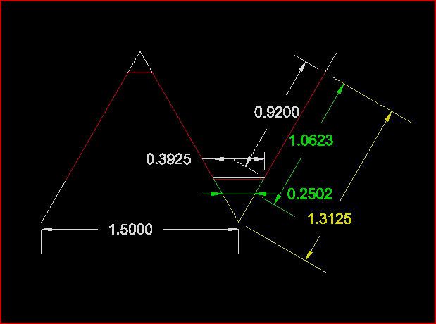

                                      Iain I've done a little drawing in cad today and your 0.92mm infeed at 30 degrees comes up slightly short of the minimum depth you'd need to reach the minor diameter for the nut so it would never go on, and it would require a 0.4mm flat to attain the proper flank width at that depth anyway. Obviously you don't want that because your thread is 1. not quite deep enough and 2. has no root clearance.
                                      If your tip width was 0.25mm (10 thou) you could infeed 1.06mm and you would have a usable thread with good root clearance.
                                      With a sharp point you need 1.31mm infeed, at 30 degrees to achieve the proper thread width at the pitch line. This is not very desirable because the sharp point makes for a much weaker thread.

                                        Right now I am totally at a loss. And apologies for the gap – a new mill got in the way.
                                        I had another go.
                                        The first thing i did was to compare the cutting tool against an M10 bolt (1.5mm pitch).
                                        Apologies for the quality of the photo – it's one of many things I'm no good at!
                                        by eye and even here, the tool matches the profile of the thread quite well.
                                        Then I set up the lather to screw cut – centre in the headstock and all.
                                        Then went straight in. None of this angled nonsense.
                                        What I found was that at 0.9mm or so a nut would not go on the thread. this is the theoretical depth of the thread. I kept going in 2 though (0.05mm) increments. The first point at which the nut would go on was at a depth of 1.3mm.
                                        Even at that it was a bit of a struggle. And when I ran a M10 die over it there was still swarf coming off.
                                        So. It looks like I've misunderstood the various postings and I need to cut about 1.3mm deep not the 0.9mm I'd understood from reading).
                                        Incidentally, applying O Level maths the depth of a 1.5mm wide 60degree angle triangle works out to be 1.299mm – roughly in accord with what I've found.
                                        The other thing I found was that I was cutting in increments of about 2 thou (0.05mm) all the way up from about 0.8mm or the lathe would stall. Even at that I hard to run a little faster then I was comfortable with (250 rpm) to be sure to get the cutt – which meant more of a struggle to get it to stop at just the right place.
                                        I remain confused about why ALL the books I've read on screwcutting seem to miss out the the depth calculation as it it were easy.

                                            Metric threads are quite easy, at least if a calculator is handy and you have a good memory!
                                            The depth of cut is always 0.87 × pitch, so M10x1.5 is
                                            1.5×0.87 = 1.305mm (approx)
                                            My usual mistake is forgetting my cross-slide is graduated in reduction of diameter, which is half depth of cut.
                                            A confusion may be because properly formed metric threads have flattened tops an valleys which suggests a smaller doc than ×0.87 does. Maybe I'm lazy, but I just go in full depth and then finish off by flattening the tops slightly with a file as it spins. Also helps to give it a quick final polish with a coarse plastic pan scourer,
                                            #451504
