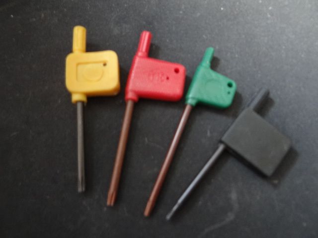

              #658489
                For info, Torx screws for holding inserts come in different sizes and the keys are colour coded:
                #658508

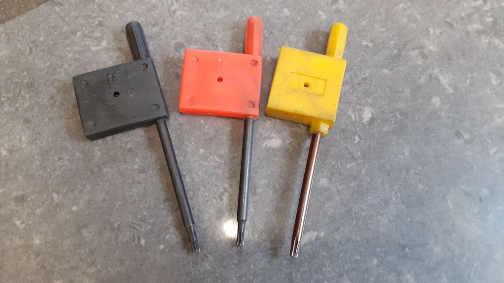

                      'Just bent metal'
                      Not sure that is how Unbrako, Wiha or PB would like their products described!devil
                      As regards colour coded Torx keys, I've answered my own question as I have found out that not only are mine different to SOD's, I also have T8's that are black and red.
                      Ian P

                        #658806
                          Posted by Ian P on 01/09/2023 20:44:40:
                          Ian P
                          I'll match that and raise you one, all T8

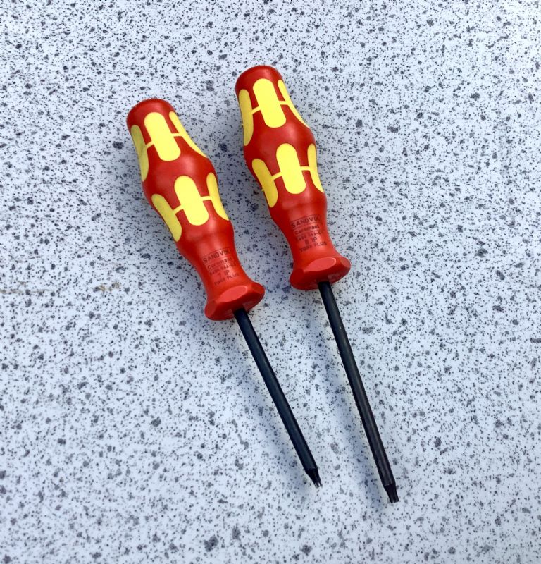

                            #658828
                            Vic
                              @vic
                              As a point of interest not all insert screws are Torx, some are Torx Plus and not interchangeable. Sandvik use Torx Plus.
                              The best place in terms of quality and price I’ve found so far for Torx Insert screws is eBay. Just look for the ones made in Taiwan, they normally have a matt grey finish. Many of the not so nice ones made elsewhere appear to be painted black?!
