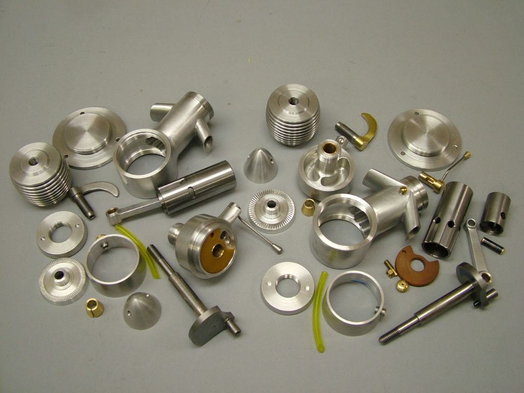

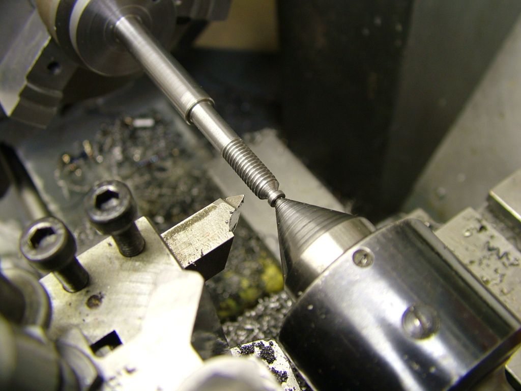

          Hello Phillip,
          Over the years I have screw cut many items on my S7 without using the compound slide.
          This is permanently set at 15 degrees for normal turning for no other reason than to give clearance to the tail stock. I only change this position if the specific turning warrants it so it remains at 15 degrees for screw cutting too but of course is not used to apply a cut. You can see the corner of the compound slide still at that angle in this image.
          The image is from the build of an Atomatic 5cc diesel which required several parts to be screwcut – L&R/H all done as above which can be seen in this view of the parts.
          I usually coat the part with a felt tip pen and scratch the surface with the tool to check the pitch then depending on material and depth of thread required take at least a 10 to twenty thou cut reducing as the depth increases and taking spring cut passes at stages without putting a cut on – I have no aids other than the cross slide movement so speeds are a bit slow to prevent mishaps if working to a shoulder. One tip I was shown at work many years ago was on that last cut or so if the gauge/mating part won't quite go on is to make a cut on the same setting but apply a very slight drag on the saddle handwheel by hand – this will give a scrape to the rear face of the thread without digging in. An acquired skill but one worth trying to master – try it out with plenty of material to go first!
          BTW – Shouldn't that 29.5 degrees in your image be 27 .5 Jason wink

                      Posted by Ramon Wilson on 17/03/2022 09:55:15:
                      Hello Phillip,
                      Regards – Tug
                      Edited By Ramon Wilson on 17/03/2022 09:58:30
                      Beautiful work Ramon. I am in awe. And great tip about dragging on the handwheel to clean up the trailing flank. Much less faff than winding the topslide back past the backlash and then back a thou or two before the 0 mark. YOu learn something new on this forum every day.

                          Ramon Wilson
                            @ramonwilson3
                            Posted by robjon44 on 17/03/2022 13:55:35:
                            I have to agree with Andrew Johnston's comment above about people who insist on living in the past where slavishly adhering to ancient practices on the off chance someone might award you some brownie points is a complete loser, there is no real way to shift some peoples mind set out of the single furrow they insist on ploughing. Having served an apprenticeship as a skilled manual turner from 1960 I moved up through the ranks of automatic lathe setter & eventually Programmer Setter Operator of CNC lathes the size of a Transit van, all along the way this mind set was evident, even though change gears, flat belt drives & putting chalk marks on the moving parts had been consigned to the dustbin of history. One day, not long before he retired my dear old dad who had served his apprenticeship as a Fitter/ Turner prior to WW2 & was now the Chief Planning Engineer of the company where we both worked was in the machine shop, he looked through the armoured glass window where it was all happening & said "bloody hell boy, I wish we'd had all this in 1938" So I can keep internal & external CCTV cameras, 3D graphics when running simulations of new programs & my own personal favourite Iris Recognition then, if that doesn't keep meddlers out nothing else will.
                            Bob H
                            Well yes I guess I do live in the past where conventional machining is concerned – on basic kit found in the home workshop. I too have had my time on transit van sized Haas machining centres but when I step into my workshop with my Super 7 that has served me well and the post war Linley Milling machine the same then reality strikes home and I use practices that suit the kit and the skill level required for the job.
                            I've always tried to help people on here who are beginners or are struggling to achieve something by giving an example to go by. Never thought I'd be considered a 'Medlar' nor that I might be seen as attempting to score brownie points but there you go – something I guess I'll have to live withsad
                            Thanks for the comments Hopper – just for interest all done on my S7 and Linley mill and from solid – no castings were harmed in the making. A full build log is here if you are interested. Oops there I go again, looking for brownie points – bugger.
                            Jason – some progress has been made – basic assembly all okay and all cast finished. Control Line currently has the upper hand over and yes some serious developments in the garden too but hope to be back on it in the Autumm. Hope you are keeping well
                            Regards – Ramon

                                It is common to drag your hand on the hand wheel of the saddle at the start of all the passes, especially on older lathes with plenty of back lash everywhere. Also to nip up the top slide to reduce it from moving, unless doing the angled topslide way, or the Hardinge way as I call it. There are many ways to skin a cat as they say, and nothing like experience. We are very fortunate for the likes of Ramon who have gone out of their way to record and keep such a great build log of not only how it's done, but shows the equipment it is done on. Now days we are spoilt for choices to learn, and youtube I find has some great things, but there is also some rather nasties their as well. If you never know anything about engineering, I always think some of the old books and booklets are always a great starting place, then move onto where ever for the knowledge. Apprenticeships are no longer what they used to be that is for sure and most it seems are just too keen on the newer ways than learning the old skills. A simple example is making a thread cutting tool, either internal or external.
                                #590329

                                        Posted by Ramon Wilson on 17/03/2022 14:25:58:
                                        All brownie points fully deserved. Thanks for the link. Awesome work. And a beautiful little engine design.

                                                  Ramon, That is a lovely set of parts for your Atomatic 5cc Diesel. I am not familier with this design. Are drawings available or is it another of your re-design projects?
                                                  Keith
                                                  #590423
                                                  Ramon Wilson
                                                    @ramonwilson3
                                                    Hello Keith – how are you? Still beavering away I hope.
                                                    I was smitten by the Atomatic '4' as soon as I saw Les Stones version on Model Engine News. The drawings I did for mine were pre CAD (for me) and simple pencil on paper. Ron Chernich was going to re draw them in CAD for MEN and a set were sent to him. Sadly his illness got the better of him before he was able to do so.
                                                    There was an Atomatic '5' as well so drew it out without the need for scaling
                                                    I still have the original drawings I did so if you would like them I can either copy you a set or take some images of them – unfortunately I am now not able to scan them to send digitally.
                                                    Regards – Tug
