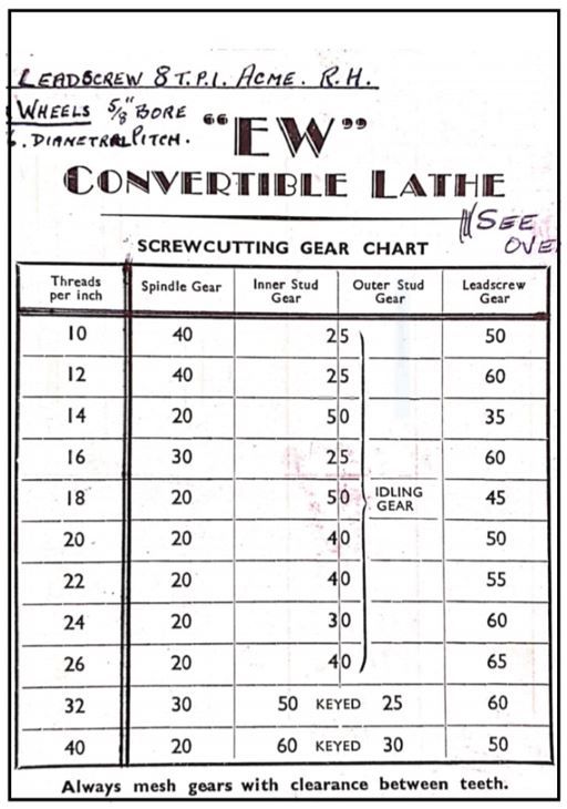

                      Try this site for a various ideas on EW lathes and mods if you want for improved screw-cutting
                      http\modelengineeringnorge.weebly.com
                      There is a screw-cutting table for EW on the site (I would post it here but it is too much of a bloody faff)
                      M.
                      (had a memory refresh!)
                      note this is for the original 16DP change gears (why 16  wtf? had they lost the smaller cutter?)
                      Edited By Martin of Wick on 17/07/2023 09:00:26
                      Edited By Martin of Wick on 17/07/2023 09:02:44

                            Thank you Martin for that table, which looks as if from the original EW Stringer manual for the lathe.
