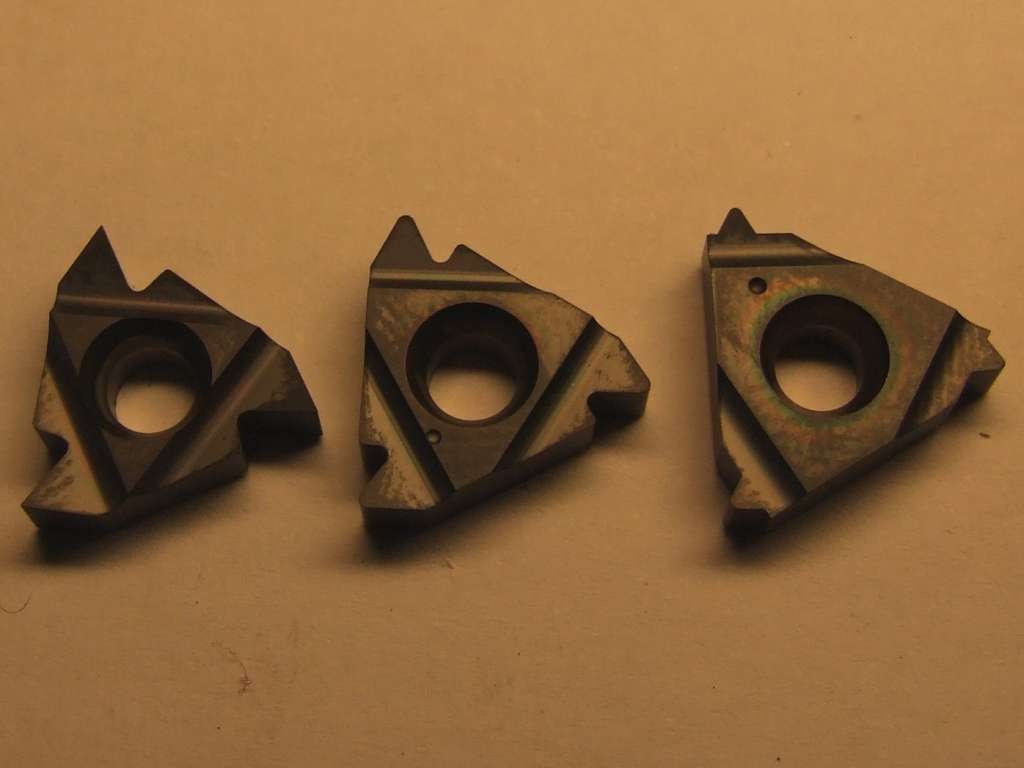

The reference to “Full Form Inserts” immediately made me think of a 60 degree Metric thread!
Whitworth form threads are not flat topped (truncated like Metric or Unified) but have rounded crests.
Being idle and a coward, if there is a Tap or Die available, they are used instead of screwcutting the thread. And less hassle with withdrawing the tool for winding back and ren engaging the half nuts (Although my practice is to withdraw the tool and reverse with the half nuts still engaged, but far enough to take out backlash on the Leadscrew when running forwards again)
Plus it avoids the risk of errors in selcting change wheels, (Not unknown!)
A Tap or Die is likely to cut a more accurate thread form than I can produce, even using a cutter grinder.
The 3/4″ BSW thread shown in a previous post was screwcut using a full form insert; the roots and crests are formed correctly. Here are some inserts:
On the left is a partial form insert; note the ‘sharp’ point that will form the root. The middle insert is a full form Whitworth, with rounded root and crest. On the right is a full form ISO metric insert, note the flat to form the crest.
