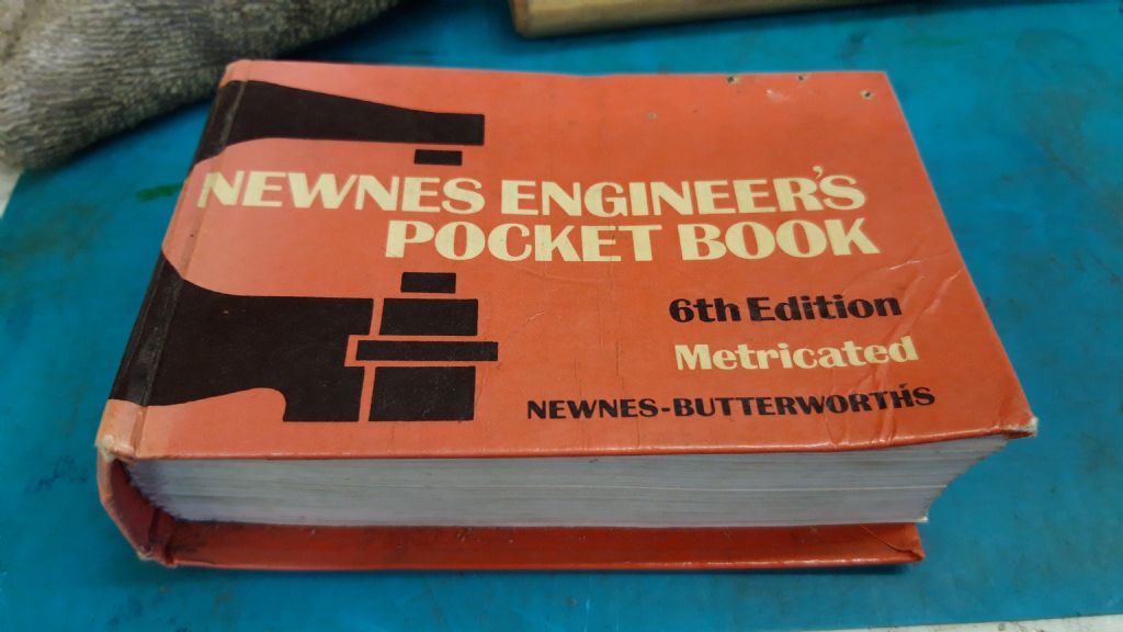

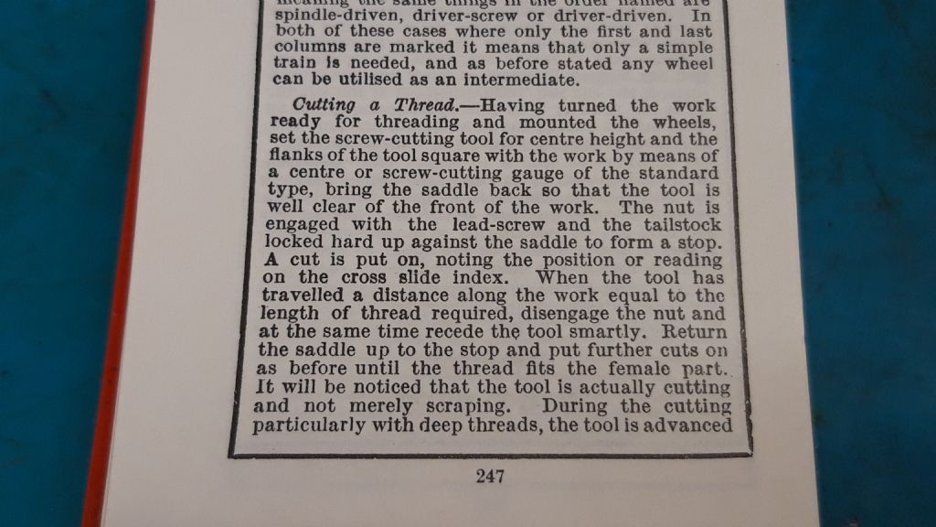

                                    #429245
                                    Ian Johnson 1
                                      @ianjohnson1
                                      Right! Had a rummage around today when I should have been doing something else, and found this 'Newnes Engineers Pocket Book' its the posh 'Metricated' version. I bought it around 1980 ish.
                                      Here are a couple of pages describing the method I and many others use. Annoyingly the text is spread over two pages. There are some very good methods in these old engineering books which are still very relevant today.
                                      I still think there is no need to over complicate things, keep it simple, if it's good enough for Ruby it's good enough for me!laugh
                                      Ian

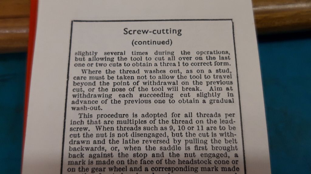

                                              #429281
                                              Ian Johnson 1
                                                @ianjohnson1
                                                Although the Newnes book says to 'advance the tool slightly several times during the operation' I tend to move the top slide in by a third of the depth of cut. I don't have any scientific or mathematical evidence to back this up, only that in my brain a screw thread, particularly metric or unified, is an equilateral triangle, so a third of the depth of cut sounds about right. And the important cuts are the last two or three where the tool is cutting on both flanks of the thread, so the approach angle is irrelevant, as long as it doesn't rub too much.
                                                Another thought. It will actually be half the equilateral triangle, a right angled triangle, with a stepped hypotenuse when the tool is moved down and along at each cut, if that makes sense? I'll have to do a bit more research and if I was any good at CAD I'd do an impressive drawing, but I'm not, so I won't!
                                                Ian
