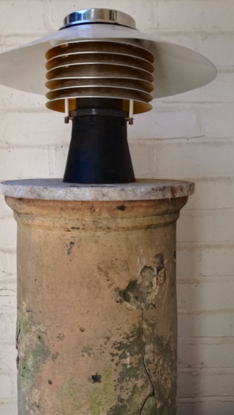

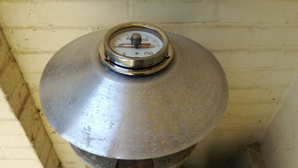

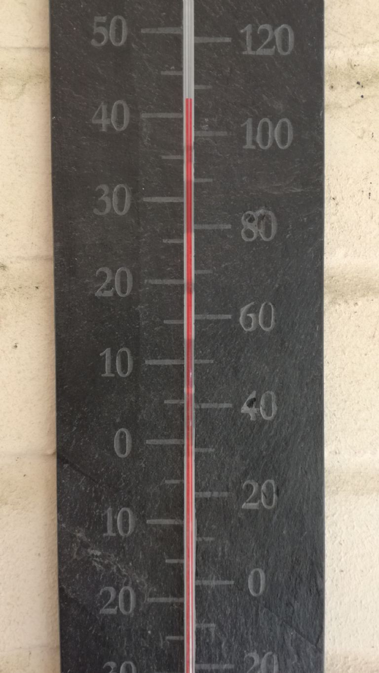

Hi, it was definitely hotter in my porch today, however this morning I reconfigured an old aluminium lamp shade that's been hiding in my attic forever. I made a sun screen, loosely based on the Stevenson's Screen, to shade an industrial temperature gauge with an integral probe and stood it on a steel camera lens hood I made years ago, this was then placed on an record player platen which fitted nicely on the top of an old chimney pot which was on a couple of breeze blocks and a plastic pipe flange just below the bottom section of the lamp shade to help stop any whimsical draugths at the bottom of the probe.

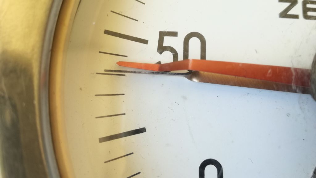

OK, it isn't very scientific I guess, but it seemed to work just fine. The highest temperature I photographed for this and my thermometer was at 14:35 and I think the industrial gauge was closer to the real temperature as that was comparable to a GALLENKAMP GRIFRFIN mercury thermometer that I have.
I didn't take any readings outside the porch, but it was noticeably slightly higher, just like yesterday.
