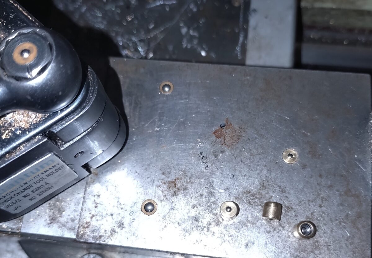

      A few of the ones on my lathe have lost their balls (I ‘m sure that’s a metaphor for something) and need to be replaced. Can I just buy the cheapest crap on ebay or do I need to pay for known quality?
      And how do I remove the old ones? I’m thinking either tapping them or a tapered wood screw (redneck engineering).
      I’ll also accept recommendations for cheap yet reliable  push button oilers.

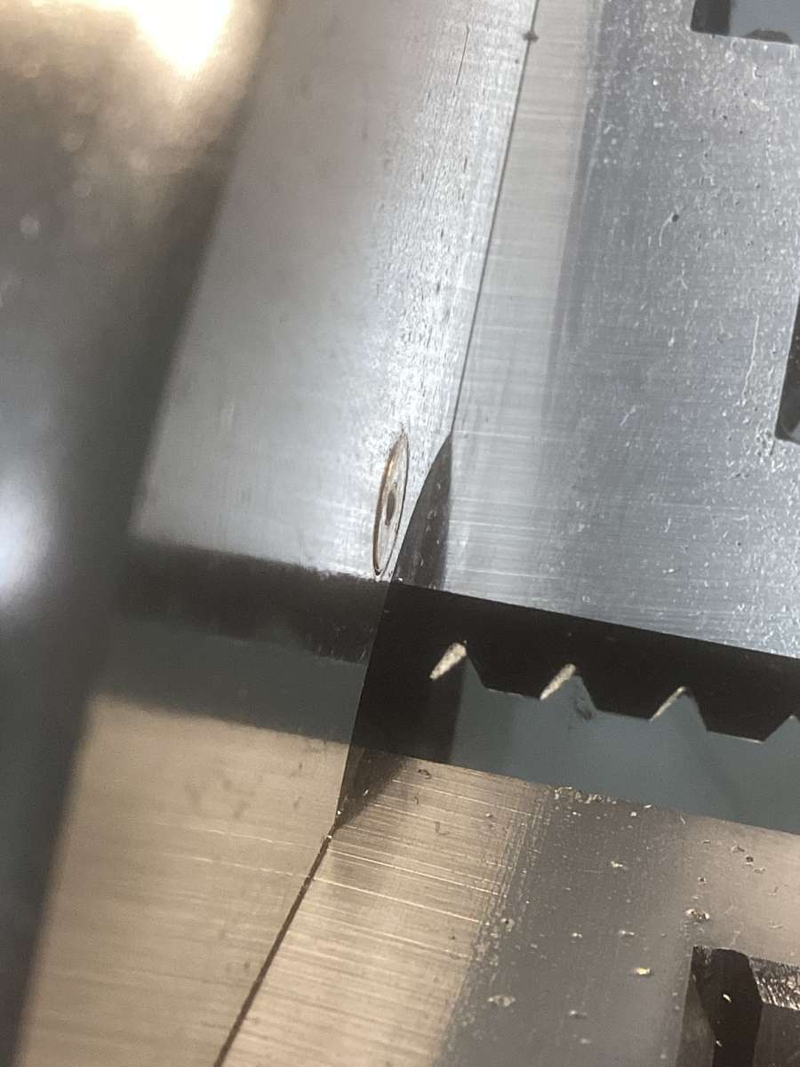

        Forgive me for piggy-backing on to your thread, Fulmen, but I want to be schooled too.
        My 125mm 3-jaw lathe chuck’s oiler sits proud of the chuck body. This is annoying when you want to put large material in the jaws and use the chuck body as a reference surface.
        I’ve tried using a small hex socket to drive the oiler below the surface but it ain’t having none of it.
        Answering Fulmen’s query may answer mine.

            Removal entails brutality, but since they are now useless, that doesn’t matter.
            Tapered woodscrew, lever out with a small screwdriver, wriggle out with a tap, even an Easyout!
            Quality, they will probably all be much of a muchness.
            When I needed a replacement, I went to WARCO, (Got 6, although have only used two, so far), but Arc Euro offer them.
            Thery seem to be for 6mm holes, but come with two sizes of ball, (Judged by my machine) so you have a choice
            HTH
            Howard
              I think the type you have is DIN 3405 D1A (look it up on Google to see pictures). They are known as ‘Type D’ or ‘Form D’. The oiler sits in a counterbore. If the counterbore is not deep enough, the oiler will project.
              Destructive removal, measure the hole, adjust if necessary and insert new one.

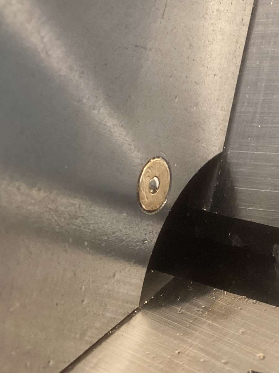

                #722458
                Bill Phinn
                  @billphinn90025
                  Thank you for the advice.
                  Below are two images of my oiler in situ. I’m not sure what type it is. It doesn’t look like it is DIN 3405 D1A. It seems a little too flat-faced for that.oiler 1oiler 2
                      You are correct. It is not to that standard. Maybe it is specific to the chuck manufacturer. The DIN standard one would be the closest replacement. Dismantle the chuck and see if you can access the back of it. If you are lucky, you might be able to drive it out non-destructively with a close fitting punch. That would enable you to assess why it is proud of the chuck face.

                          The one on my lathe topslide handwheel failed, I just made another one using a slightly larger ball, rest from a piece of brass I had, it still works like a charm, can’t remember exactly what I did, but it was not a big deal, I think I just googled and looked at different shapes, old one came out easy..

                            I did consider making them myself, but I didn’t have any suitable balls (pun optional). So I ordered some cheap ones from China, we’ll see how that decision turns out.

                              Fulmen
                                @fulmen
                                So the oilers came surprisingly fast, and they fit well enough. Not a fan of the small balls (stop it), but at least it stops chips from getting in.
