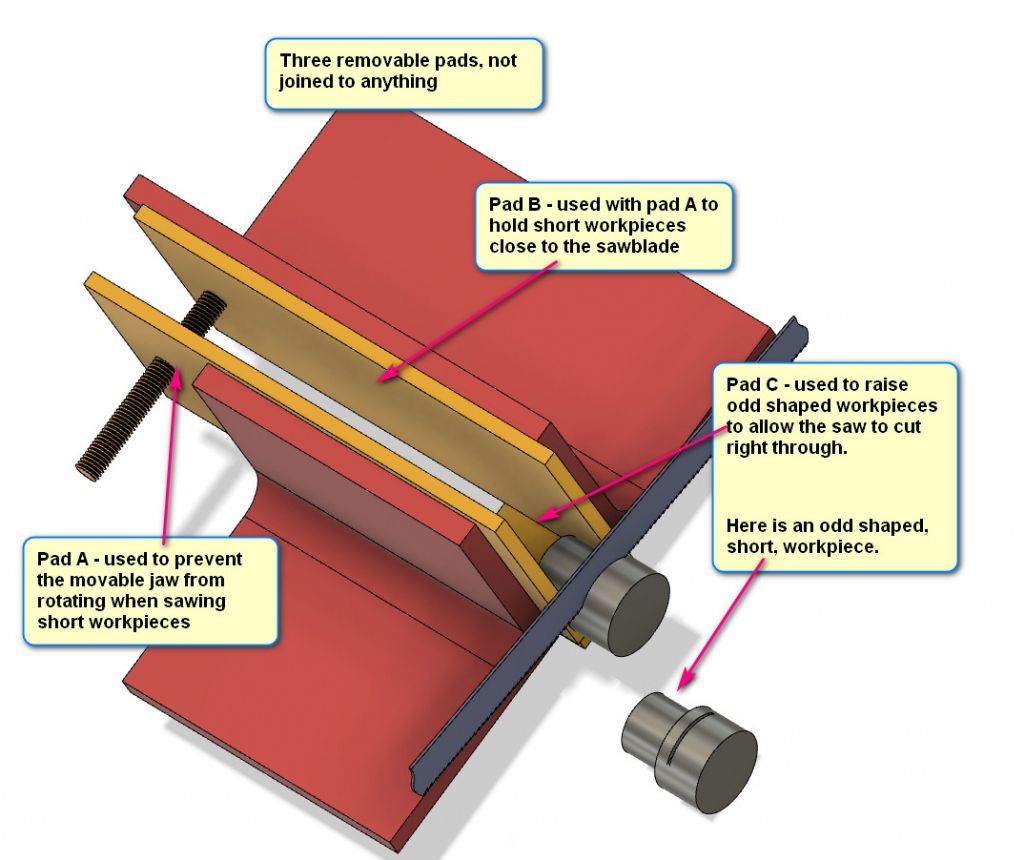

        With my 4×6 bandsaw I, and many others I would think, have discovered that the movable vice jaw tends to rotate when trying to hold short length workpieces. This method completely solves this problem, and requires no changes to any part of the bandsaw at all. It's just a metal plate the same size as the fixed vice jaw, about 6mm thick. I used some aluminium sheet. A hole is drilled and tapped near one end to accept a suitable length of threaded rod that is used as a jack. I used M10. That's it.
        The plate is positioned against the moveable jaw and, with the workpiece clamped tightly near the pivot point of the moveable jaw, the jack can be adjusted to meet the other jaw. The vice is released to allow the workpiece to be positioned properly and then clamped firmly. The jack stops the movable jaw from rotating.
        If another plate is made but without the threaded hole, the two plates can be used together to hold short items very close to the saw blade.
        A third plate of appropriate thickness can be used to lift odd shaped workpieces to allow the saw to cut right through.
        The diagram illustrates all three uses. Works for me.

            Thanks for a wonderful diagram, I have ordered parts and will be putting this together when they arrive!

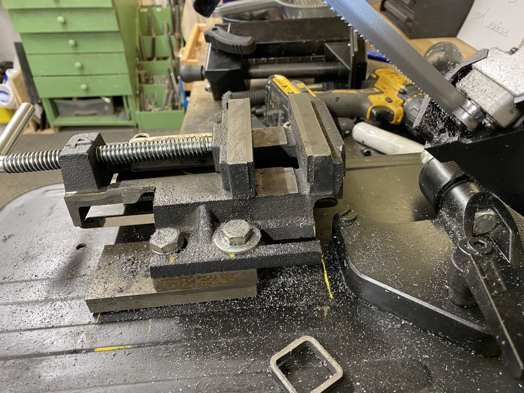

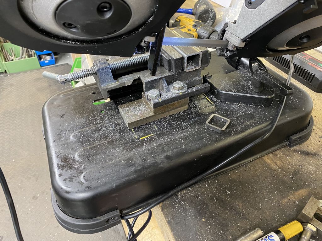

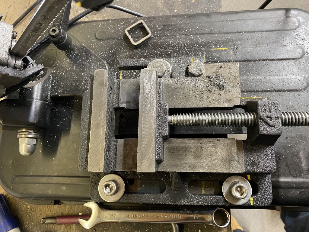

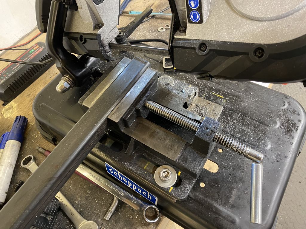

                      e4b47397-8a82-45d5-a463-3b2ca17d61c2.jpega4c86e2d-356d-4935-b416-77e0021dc40a.jpeg75ac37d0-f183-4ac4-907a-9ef638a6ed75.jpegI have read this thread with much interest as I have exactly the same machine. It has been a revelation to have it in the workshop and I have been very happy with it. (And only about125 quid IIRC). It’s clear the clamping system has been made down to a price though! On one occasion I pushed my luck with what it could do and of course it let go and bent the blade. Arghhh. I decided to do something about it. I am now quite surprised that instead of just taking advice and guidance from the large font of knowledge on this forum and now I am actually sharing something I have done! My solution was to buy a cheap 4 inch vice from machine mark and hack it into shape. A few slabs of steel and hay presto a decent clamp. I did a few Harold Hall inspired tweaks to the vice to make for a bit better fit and smoother movement. Future mods may include making a new set of jaws which are higher. To be honest I didn’t think it all through as I haven’t checked I can still rotate the blade by 45 degrees. I’m hoping it will,all work out in the end. Hope this is of some use to someone on what is (apart from the clamp) a great value addition to a workshop.5efc48a8-eb8f-4530-b1d9-18fd738abcec.jpeg
