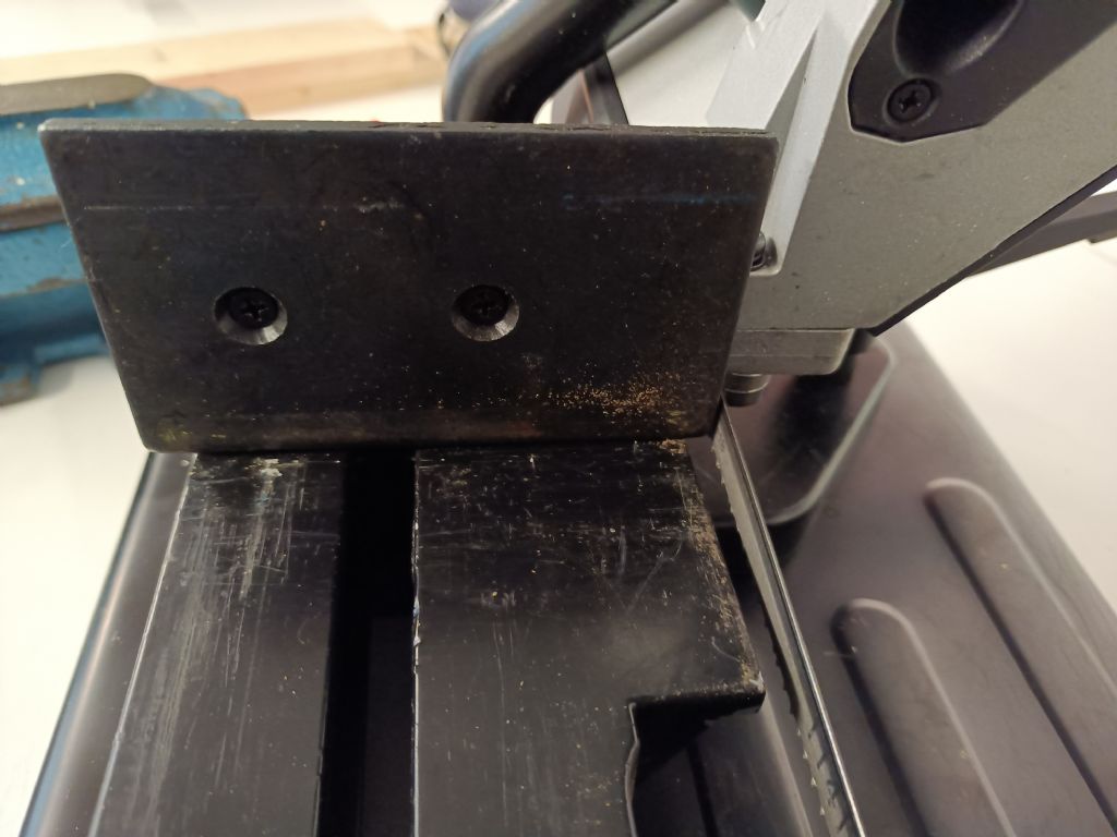

                        79b2c1a6-aaa5-49f3-9fa8-b0d84b82cad4.jpegJust fit two plates to the existing vice using the screws already there, fit a jack screw if you think you need one.
                        Cuts 30 mm steel with little waste.

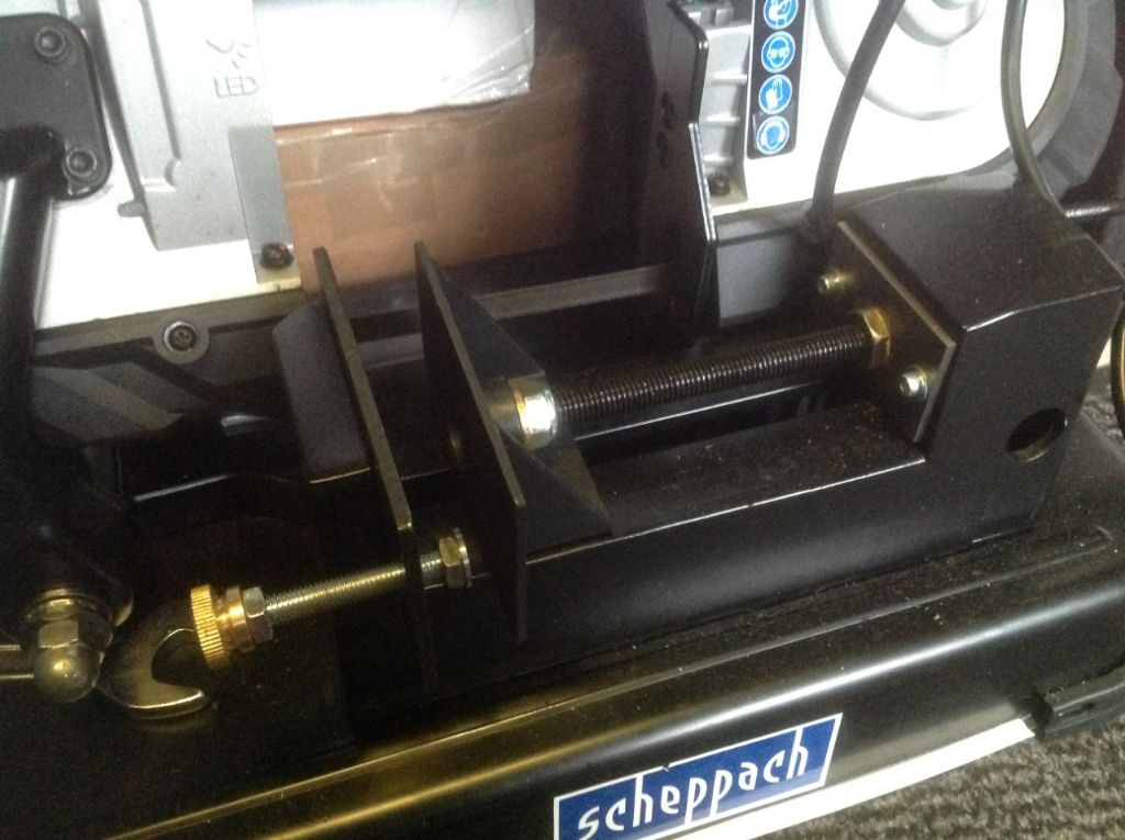

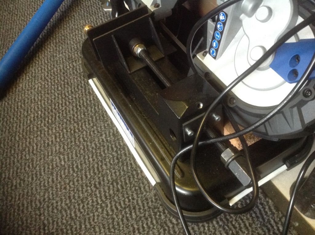

                          Hi Andrew, I have the same machine, and you are right, it is annoying. But there is a quick fix.
                          On the fixed side of the vice – just turn the piece of sheet metal around – and you are there. Probably you need to grind away 1 or 2 mm from the edge not to touch the saw blade (This is what I needed to do)
                          Scheppach MBS11005 2
                          on the movable side of the vice I grabbed a piece of rather thick sheet metal I had in the bits box and screwed it to the existing jaw (of course you need a few holes and thread them n the existing part)
                          Scheppach MBS11005 3
                          If somebody asks why the additional jaw doesn't reach the end of the original jaw – I said the part used is from the bits box and I didn't have any other, longer part. On the next photo you see that you are almost touching the sawblade. So – problem fixed, took me about one hour to do it.
                          Scheppach MBS11005 4
                          By the way I do love the saw, after a proper set-up it saws absolutely 90 degrees to the vice. This allows me to go close to the final dimension I need and this helps saving time (less filing or milling…)

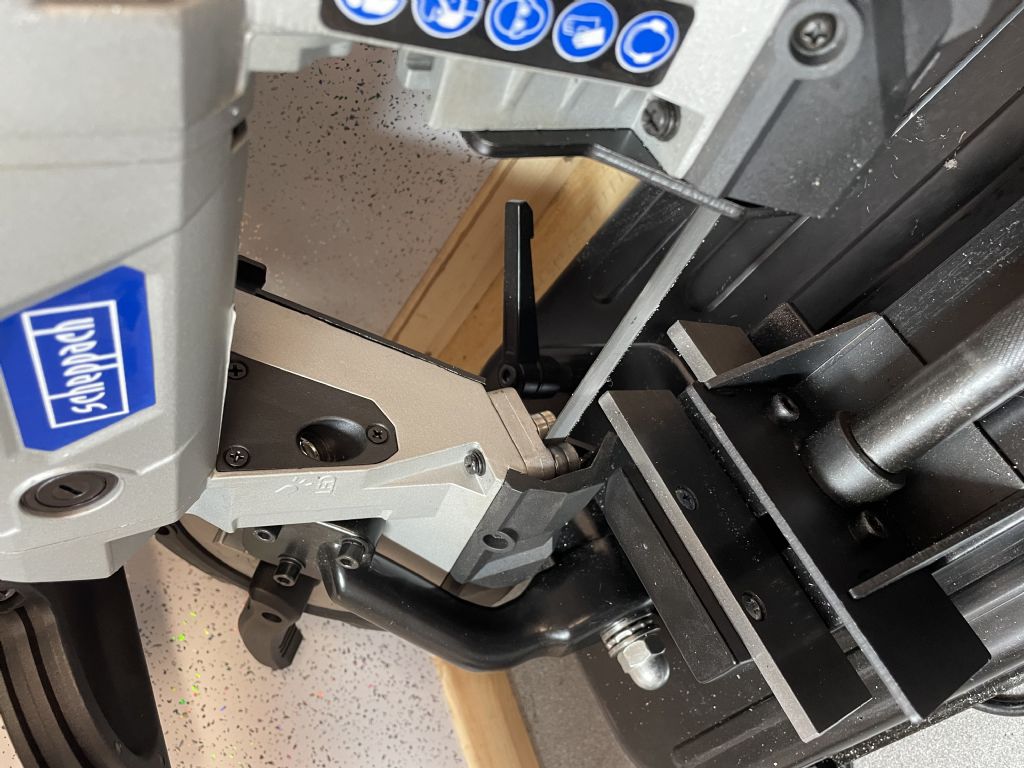

                                  Andrew, for when small parts are being clamped, besides extending the vice jaw[s], as others have suggested, you can add a jaw stop on the far side of the fixed jaw to keep the moveable jaw parallel at all times.
                                  My jaw stop is M8, and both the cap that bears aganst the moveable jaw and the brass thumb wheel are removeable for when I don't need the stop or when I want to fit a longer M8 rod.

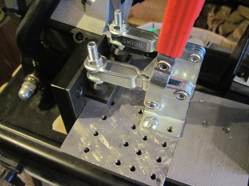

                                                    My Aldi bandsaw looks very similar – and as sold – also had a poor vice fitted to it. It moved several times on my early cuts.
                                                    So I removed the sliding jaw and fitted steel base plates with 6mm tapped holes instead. They extend support right out under the work to the blade. The clamps shown are quick acting but as the blade runs away from the jaw – the work can still move if I'm not careful. I've found conventional slotted clamps/hold-downs (as used for milling work) hold much better and you can also then clamp & cut things at angles if required. Sorry, I don't have a photo of these in use but hopefully you will get the general idea.
                                                    Regards, IanT
                                                    PS I used two steel plates as I didn't have anything in the scrap bin big enough to fit the job – but you could obviously just use one plate if you have a large enough piece.
