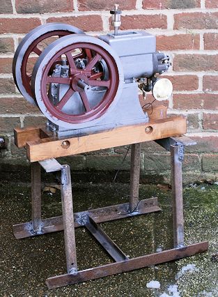

          Here is the stand I built on Tuesday before the “real” snow arrived !!!!
          It is designed to bring the crank handle to about 24″ from ground level. I may also fit it with wheels.
          Regards Charles

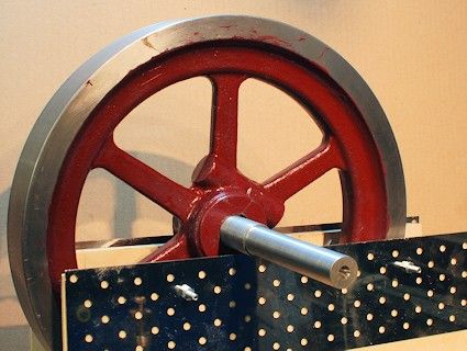

                                  Balancing of the flywheels is completed by using the crude but effective set up. They now rotate right across the 12″ of metal edge  with only a gently push. The holes are driled in the top ede inner side as there was not sufficient material to drill where painted red. Sorry about the paint smudges I will clean then off one day !!!
                                  It will be interesting to see if the amount of vibration is reduced when next run.
                                  Regards Charles

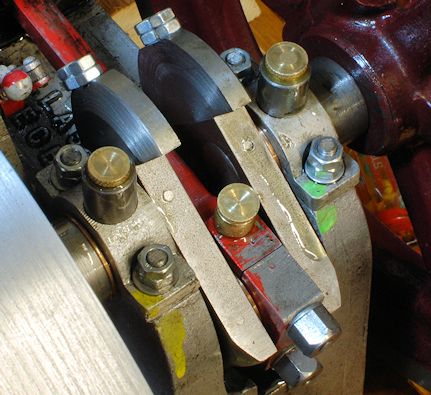

                                            Edit, pic of the machined balance weights on the IHC Famous I’m currently working on
                                            Jason
                                            Edited By JasonB on 14/12/2010 16:51:58
