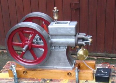

      Here is the engine ready for testing

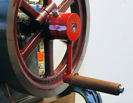

        I have now made a starting handle with atuto disengage …
        I hope it will help the starting of the engine …
        I will remember to keep my thumb out of the way !!!

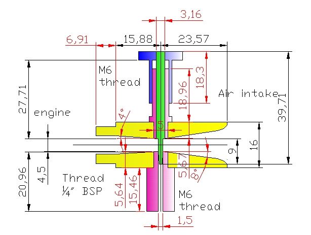

          I have redesgined the carb and made it to my own drawing below .
          You can see more picture in the album.
          The most important points I think are:-
           that there is a great deal more air flow around the needle,
          that the fuel entry is at the base of the carb
          So I agree with the other poster that the carb as designed with the engine could well be over engineered.
          There is still much to sort out as the hit and miss does not engage so likely to be a spring problem as mentioned by another poster.
          Regards Charles

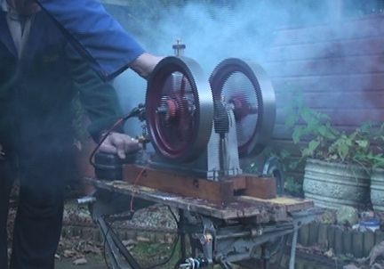

            Well here it is running
            The smoke soon cleared when the excess oil had burned off – honestly
            The lower hand ( of a friend ) is steadying the ignition box and the upper hand (mine)just steadying the engine  which made the “workmate” rock about a bit too much !!!!
            Regards Charles

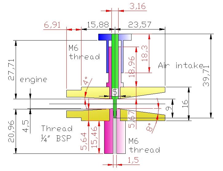

                                                  This is an improved drawing showing the “bell mouth air entry”  angle not important but create a smooth curve …
                                                  The lower unon is part of the the  non return valve, and as such has a CROSS filed into the flat to allow fuel to flow past with a lower section  that screws onto the M6 Thread with a small stainless steel ball bearing.
                                                  Regards Chalres

                                                    Anonymous
                                                      Hi Charles,
                                                      Thanks for the updated carb drawing. I’m not sure I understand the purpose of the non-return valve. I assume that air drawn thru the carb causes fuel to be sucked from the tank? Does the non-return valve stop it running back? At what level do you think the fuel tank should be relative to the carb? I’m planning to TIG weld an external stainless steel fuel tank, so I’ll have freedom to set it at what height I want.
                                                      Regards,
                                                      Andrew
