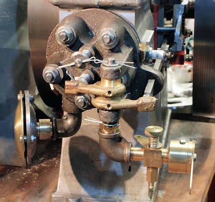

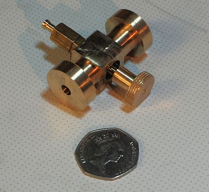

          Hi Jason
          Thanks for the info..  I do have a selection of springs…  so nothing to do with the actual timing of the engine?
          I have posted some more photos …
          This is as far as I have reached with the carb.
          It is modified from the drawings as I could not achieve and hole of the right size through the jet of M3 so I have made if M4.
          Regards Charles

                                Well it was all a bit hit and miss.
                                 We all gathered at 11:00 and established that fuel was being drawn into the carb so the ignition was attached and on the first pull over it popped and smoked but nothing more than one fire.
                                 Then during the next 90 minutes everything was tried and we had a second firing of about 5 ignition strokes and then nothing.
                                After lunch one friend came back round and we fitted the third piston ring with careful attention to width and depth  AND the fact the the rings have a top and a bottom which I did not realise … was taken in to account and properly fitted.  This gave much more compression than when we left it before lunch.
                                Then on the first pull again engine did run for 12 revolutions and the stopped and then another pull and it fired and nearly got up to speed but finally petered to a stop.
                                That was a bit of luck as I then noticed that the crank shaft has moved …  The Loctite 603 had let go …  So the repair was made by reapplying 603 but the crank will need to come out and I will be pinning it in all 4 places to stop that ever happening again …
                                 We also found at that too much fuel was going into the engine …
                                 There is no disappointment on my part for had it run without problems one would not have to work out why will it not run and learn nothing …  Even motor engineer friend and all his experience is at a loss as to why is does fire but then does not continue to fire….
                                 We have spark, fuel, compression but that is it …
                                Any ideas …  may be a rebuild of the carb to a simplier design???
                                Regards Charles

                                    It is thought that it is a fuel problem …  The carb has an integral non return valve that I added to the basic construction so it was not a case of too little fuel we think it might have been too much fuel !!
                                    As soon as I have more news I will let you all know ..
                                    ragards   Charles.

                                          I have been looking in Westbury’s book and he suggest a simple carb and I think I may try that …  I hope my sketch does justice to his idea
                                          This does away with the throttle and  ..  A hand can act as the choke.
                                          So I am working on that !!!
                                          I have pinned the crank and all is well as it went back together easily .. the key ways do not alingn but that does not matter !!!!
                                          I will check the tension  of the spring but at the momenthe engine has not reached speed to throw the MISS into gear…  it is fun waiting …
                                          I wish i knew how to make a nice tapered jet screw !!!

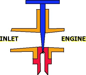

                                                    Charles, that diagram of a carb , the design that I use, but I just made it up as I went along, did’nt  realise it was a published design, its really just a mixer valve and it works well on full size engines, and I’m going to use it on an engine that I’m building. Ian S C
                                                    #59127
                                                    Charles 2010
                                                      @charles2010
                                                      Hi Ian
                                                       I wonder if you have any ideas on dimensions.
                                                       I have been discussing this with other friends with engineering back grounds and they think the the original 4.75mm air entry hole is way too small to feed the engine with an air and fuel mix.
                                                       They are of the opinion that the opening at the centre of the venturi should be say 50% that of the  outer bell which would be about 10mm for this engine.
                                                       Any thoughts on what  you  have tried?
                                                       I am just out to go and buy stock so that I could make up several mixer carbs  that sounds like over kill but a lot of engineering fun .. Thank goodness I am retired.
                                                       Another friend is working on an electronic ignition system where the spark can be advanced and retarded by electronics. I know that gets away from the simplicity of the engine but again will be a lots of fun as I am also a Radio Amateur
                                                         Regards Charles
