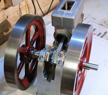

      I wonder what the dimensions of the timbers are I guess about 38mm x 60mm
      I like the cross members to give strength
      Nice see such a fine picture too.
      Regards Charles
      Edited By Charles 2010 on 18/10/2010 20:44:42
      #57098
        Much smaller than that, the model has 7″ flywheels and the timber is 20×26 finish size, for your slightly bigger engine something like 25×30 would look OK.
        Have a look at some of the sites with photos of full size engines and base your design on that, wheeled trolly would look good The Florida Freewheelers photos here are a good place to start

                      I decided that the safest way to hold the cylinder head for machining was to make up a suitable base to which the head could be bolted using the stud locations tapped M6.
                      This all works very well …  I have posted some photos  of the piece .

                        Thanks for posting the pictures. Looks like a nice solid arrangement.

                          And I now realise that it will be used to machine out the valve seatings etc ..  They will be aligned in the 4 jaw chuck and all the finishing achieved for  each eg size and angle and 6mm ream.
                          At the moment I am waiting for tools to arrive so that  can continue …!

                            That is very practical…it would be an awkward piece to hold any other way.

                              Had I thought ahead more clearly such as I have done chatting away to a friend to night I would not have drilled the two valve guide hole from the top but marked them to be drilled from the inside.
                               That would have relieved me of having to do very careful lining up to drill through correctly and I will not know that I have done so until I have the valves made and lapped in and proved concentricity.
                               I have added to the photos my acetate drawings done on Autocad and printed out 1:1 that I used to pop mark the drilling positions – I used this as I could think of no other way of accurately drilling hole on a pitch circle with my limited engineering workshop..

                                I’ve used the printed template idea myself, in my experience it can give excellent results. Probably not as good as coordinate milling, the use of a rotary table, and so on, but as good as most work needs.

                                  More photos have been posted …  The Cylinder head is nearly completed.
