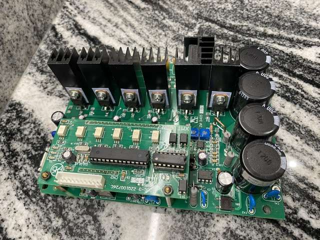

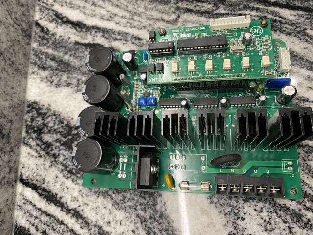

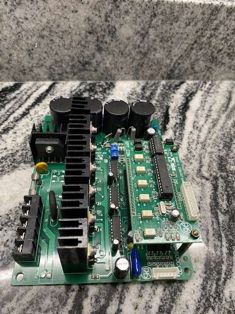

        Just to add some more meat to the bones
        What I have tried
        disconnect motor = still blows main garage fuse
        disconnect output wires from the kill switch  = does not blow, green power light lights up while I hold the power button but won’t latch on (as expected)
        reconnect wires from kill switch to the board. Motor and speed dial disconnected so literally just the board connected = blows.
        must be something on the board but nothing seems obvious.

          I wonder whether an interference suppression capacitor connected to earth has been ‘blown up’ by an inductive voltage spike caused by the 5A fuse blowing.

                Wot Peter said, plus several other components.
                An RCD detects a current imbalance caused by something in the system connecting to earth.
                The capacitors mentioned by Peter keep the mains clean by deliberately earthing noise.  If they fail, the RCD will pop.   The capacitors are specially rated for this so don’t substitute them.  No need to because they are widely available and inexpensive.   Look for X and Y rated suppression capacitors.
                Although burning and melting may be obvious, components often fail without visible damage, in which case  electronic diagnosis is needed.
                When a controller board fails whilst taking a heavy cut, it’s usually one or more of the power mosfets that’s failed, and replacing them isn’t too difficult.  Unfortunately, the initial overload and extra stress caused by the FET(s) burning out may have damaged other components, which also have to be identified and fixed.
                Though I have the gear, diagnosing faulty boards gets up my nose. Unless it’s obvious, I’d replace the board with a new one.   Someone on a tight budget who enjoys debugging and learning new skills can have go!  Can you provide some photos?  The forum can probably help more than I have!

                  An RCD detects an imbalance in the in and out. This can be caused by numerous faults. You mention a 5A fuse, is this the original value ?
                  I’m with Dave on the power mosfets. take them out and test, it’s worth a punt for what they cost to change them. Noel.

                                yea both scenarios make sense, I found a test for the mosfets and need to complete it but the ones I tried on the large heat sinks seemed okay (need to complete the tests)
                                just a pain these boards are fairly expensive, I believe I ruled out the board that takes the power from the mains (guessing it’s a step down from 240v to 12v? ) by having the control board unplugged and getting the green power light to come on and nothing tripping.

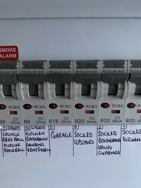

                                    Hi Peter
                                    this is what keeps tripping
                                    IMG_0590

                                            Technically, that’s not an RCD, that’s an RCBO. Not an electrician, but I understand an RCBO to have the same current imbalance detection as an RCD PLUS an over-current protection.
                                            So it may be being tripped by either of those conditions. Whether that helps or not, unsure, but if it blew a 5A fuse to pieces, I’d suspect over-current.

                                              Hmm,
                                              Andy said: “yes I belive the one that blew (literally smashed the glass) is a 5amp”.
                                              That is a indication that (typically) the fuse fitted is not suitable for the application. I suggest replacing it with a 5A HRC (high rupture current) type. These have a ceramic body and sand filling..
                                              The device that tripped is an RCBO. This will trip on either overload or leakage current, you can’t tell which caused the trip. It may not be a short to ground.
                                              Robert.

                                                      But would the fact it trips without running now mean leakage or no? Every time I hit the power button with the board plugged in.
