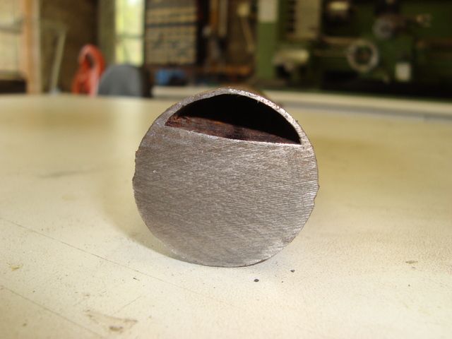

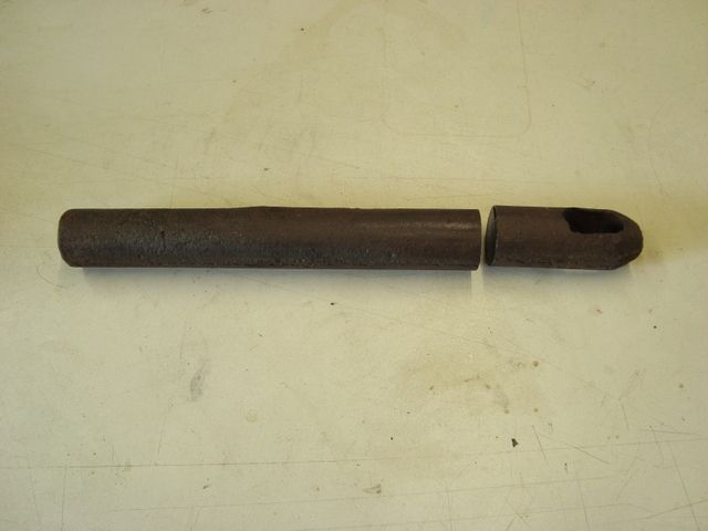

                                              Aestus57
                                                @aestus5782081
                                                Here's a couple of photos of a sash weight with a "problem"!!
                                                I cut this in half hoping to get a couple of cylinder covers out of it but I'll have to get another one. The hole goes almost right down to the end!
                                                Probably not completely ruined as I can still see a slide valve cylinder in there.
                                                Regards to all
