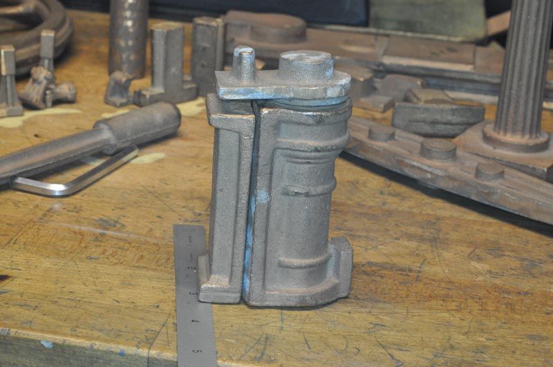

                It looks like your castings are the same as mine were except that your base appears to be CI were as mine is Ali.
                If your castings are the same vintage as mine one thing you might want to check is the top cyl. cover. I found that the distance between the piston rod and valve rod gland bosses was about 3/16" too short. So I cut it in half just shy of the valve rod boss and silver soldered a piece of steel ~3/16" wide between the two pieces to give the required 1" dimension between the piston rod and valve rod. See pics.

                  Roderick Jenkins
                    @roderickjenkins93242
                    John,
                    I'm not really familiar enough with this engine at present to fully understand the bits you are referring to. Is this the part you mean?
                    Thanks for the heads up on the cylinder cover, mine looks OK.
                    Even my baseplate is bronze – I suspect the scrap value may be more than I paid for the castings surprise
                    Rod

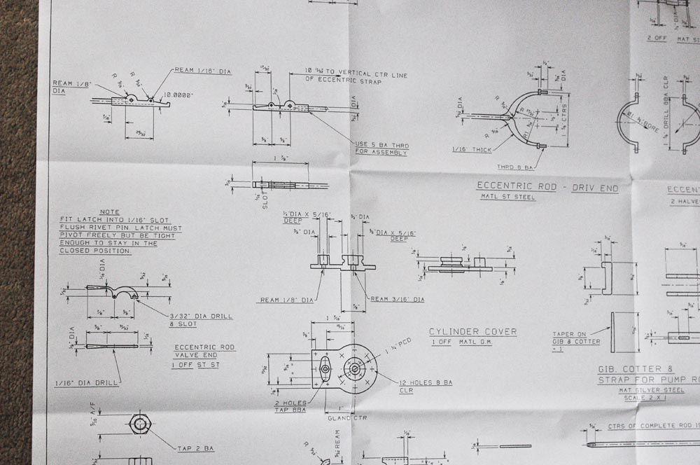

                        Hello everyone. I'm new to this forum, so please forgive any lapse of etiquette.
                        This seems to be one of the only, thread regarding the 1/12 scale Sanderson beam engine produced by Clarkson & Son.
                        Some time ago I was donated a box of stuff by an old engineer, and amongst the contents was a partially assembled Sanderson (mostly the cast parts) on a makeshift wooden base and a full set of drawings + a company catalogue. On closer inspection (after chasing all the spiders out) it would appear that all of the brass parts are missing; whether robbed for scrap or just separated from the kit and never passed along, at sometime in the past, I'll never know.
                        I've already helped out a chap in America by sending him the blueprints to copy and return. I thought I would 'spread the love' so to speak, and offer up the same to anyone on here who needs a set of original blueprints to work from. I know there is a new classified 'want' ad for these, but the site won't allow me, being a new subscriber, to view or respond to that person. Perhaps, if he's on here regularly, he will know who I mean and make contact through this thread.
                        There is too much missing from this model for it to be a feasible project for my retirement, as I now live in a tiny flat with no workshop space. So I will have to pass it along to someone with the facilities to resurrect it back to working condition. This isn't an advert for it – I don't want to break any forum rules, but if someone on here with more experience could advise me on how to go about selling what I've got, it would be most appreciated.
                        #250201
                          I think Blackgates still hold the copyright to these drawings and may not be too happy with you spreading the love.
                          They can also supply any missing bronze castings.

                          Maurice Cox 1
                            @mauricecox1
                            If these are Clackson's castings, beware of chill spots! I built their table engine many years ago, and they were a nightmare, especially to a novice. I didn'tb know about cooking the castings in a solid fuel stove to anneal them. Also, if you wish to refer to the original drawings, I believe they were published in "The engineer and machineist's assistant" about 1845. The Science Museum library has a copy.
                            Maurice Cox.

                                  Posted by Maurice on 10/08/2016 18:35:24:
                                  Maurice Cox. When I said it was mostly the castings, these aren't raw ones. They're all painted up in the original colours, which I assume (from their catalogue) means that these were part of the factory kit, finished and ready to assemble. The drawings have a date of 1968 on them, so I don't think the model itself can be much younger.
                                  #250260
                                    It is generally said to be OK to make copies for your own personal use, making copies for others is not whether for free or payment.
                                    There is nothing wrong with selling on the original drawings.
                                    #250384
                                      Posted by Bob Johnstone on 11/08/2016 08:48:00:
                                      I think the term 'copyright' in this situation would apply to me trying to pass the blueprints off as my own design or copying for monetary gain. Making a free photocopy of them hardly constitutes infringement, but perhaps there's a lawyer in the house who could correct me.
                                      Copyright is very definitely intended to stop people photocopying/scanning things and giving away free copies.
                                      You are unlikely to get in trouble for something that is no longer available, but where someone is still selling the plan each copy you give away potentially deprives them of a paying customer -and they will have paid the original designer for the right to sell those plans.
                                      Please don't use this website to distribute pirate drawings (ours or any other publisher) – the internet threatens to make the sale of model engineering plans unviable and in the long term the result could be that many rare designs are lost for ever.
