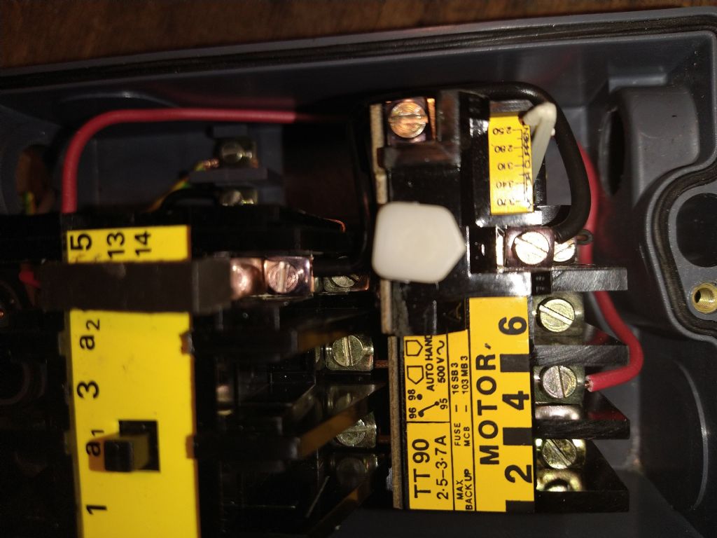

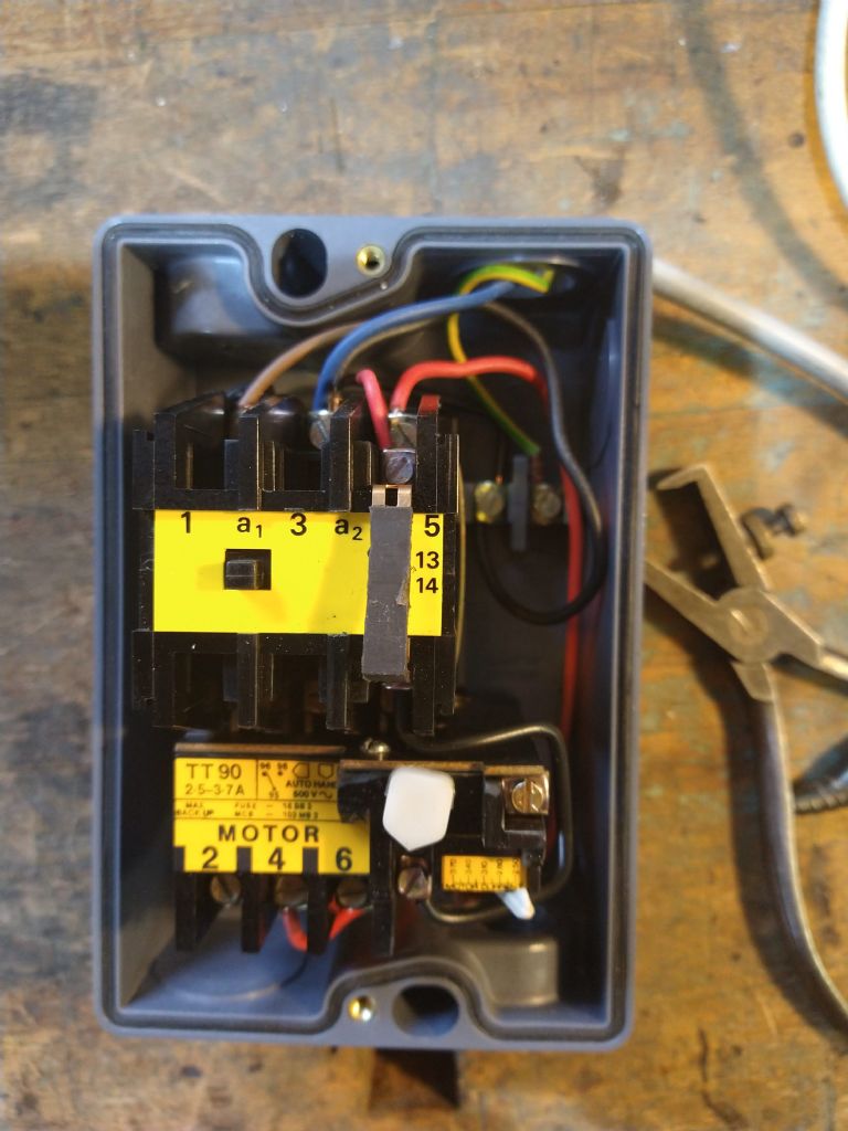

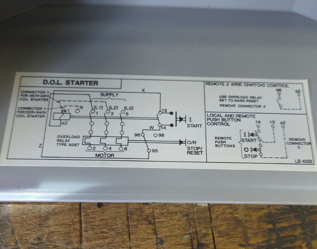

      img_20210427_165153684.jpgimg_20210427_165129027.jpgimg_20210427_165113860.jpgimg_20210427_165057044.jpgimg_20210427_164918214.jpgI am trying to wire up this switch to a small single phase lathe. I have followed the diagram, but the magnetic switch does not operate/energize. If I activate the switch with the manual button, the output to the motor becomes live as expected. Can’t see what I have done wrong, help!img_20210427_164909776.jpg

          I am trying to wire up this switch (above) to a small single phase lathe. I have followed the diagram, but the magnetic switch does not operate/energize. If I activate the switch with the manual button, the output to the motor becomes live as expected. Can’t see what I have done wrong, help!

            Check if the coil voltage is for 380 or 220 volt, that may be your problem.

              You need to connect a neutral to the coil as it is a 240v. Live to 1, link 2 to 3 and also neutral to 5. connect the motor to 4 an 6. Set the overload to the full load amps as stated on the motor. That should work, according to the diagram. Noel

                Thank you both, all working now. I connected neutral supply to the coil and left everything else as was. Motor connected to 2 & 6img_20210428_112554444.jpg
