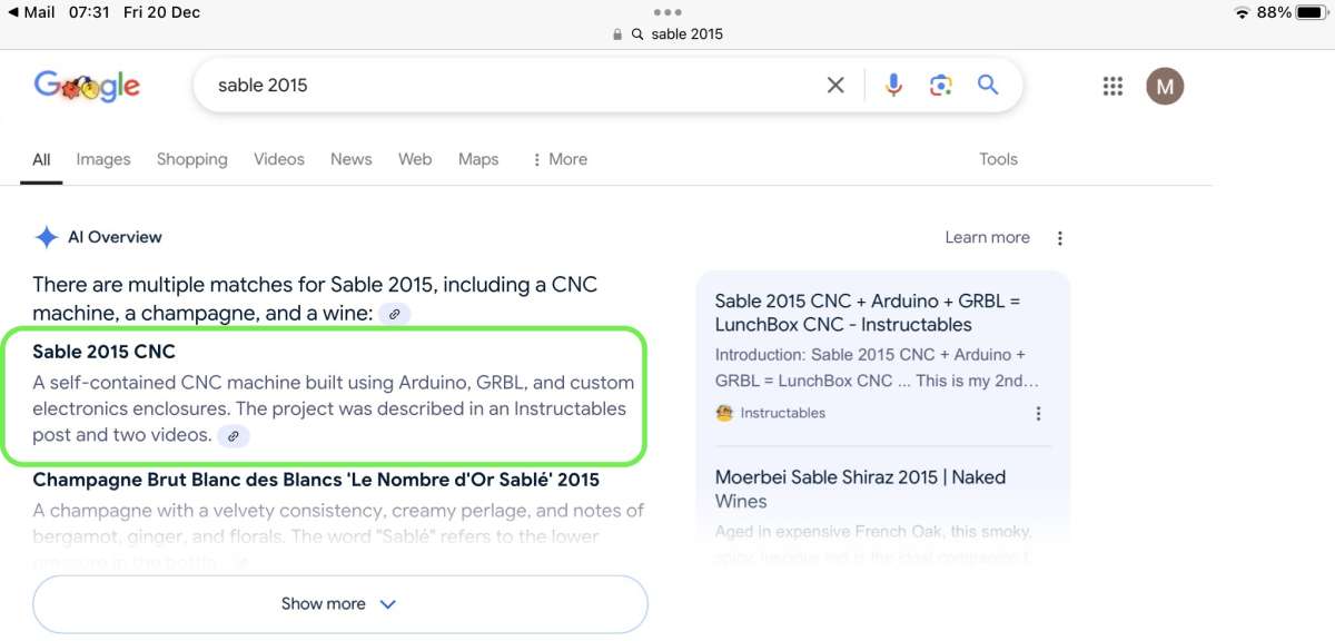

          Google’s AI overview did rather well:
          IMG_0415
