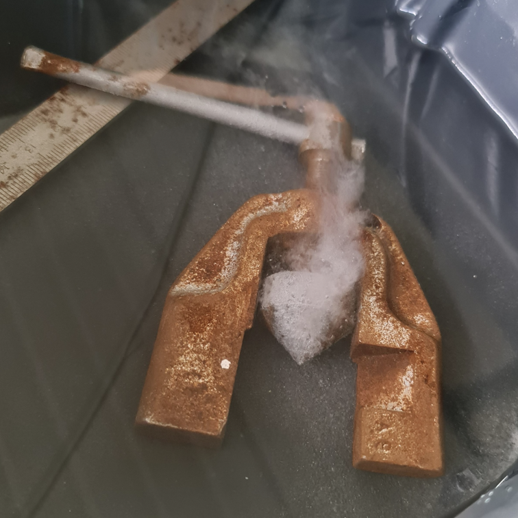

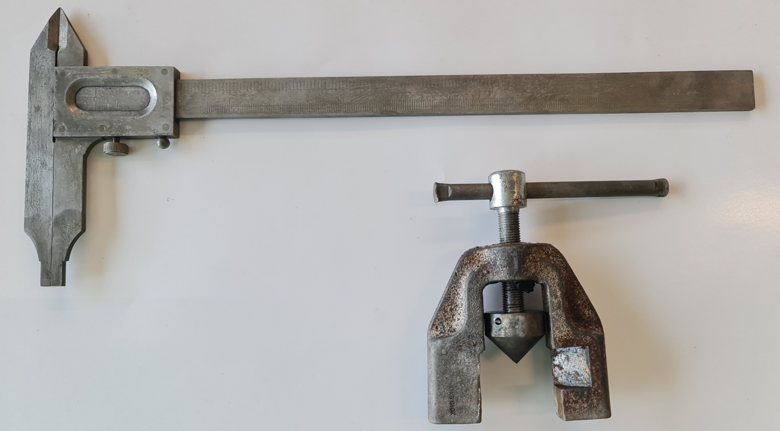

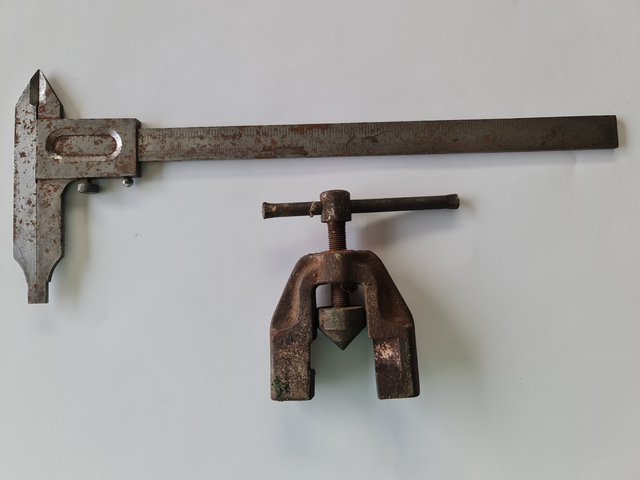

      I’m always looking for new chemicals for my restoration projects so I rubbed a vitamin C pill to a rusted metal part. The result was promising so I bought a few kg of citric and ascorbic acid in powder form. They are very cheap. The citric acid is ~2 euro/kg in small quantities from food suppliers. Now I understand why the put so many additives in food.
      I diluted about 0.3kg of mixed acids in 2.5l of water and give it a try with these two parts. Before I clean them with sodium hydroxide.
      One interesting thing is that the cone part reacted strongly with the solution. First I thought that maybe there is sodium hydroxide left on it. But the reaction continued for hours!
      I let it overnight and this is the result:

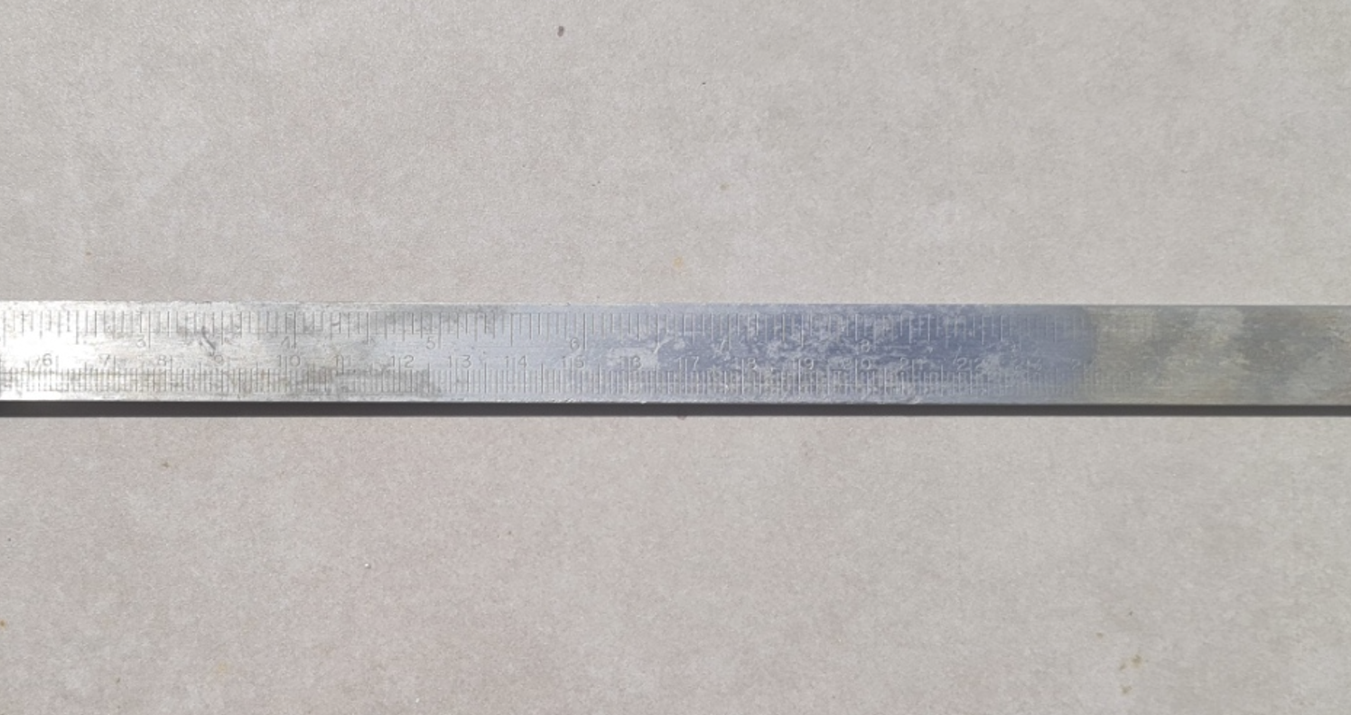

      The metal looks a like it was sandblasted with a fine powder. Maybe I let it for too long? I tried some Autosol paste on a small area it seems to restore the metal color. From what I understood these acids are transforming the rust in a water soluble substance. It is working also if you use the citric acid undiluted as a cleaning powder. The bonus is that it is also a little abrasive. I think this option is worth considering if you want to clean big parts that would require large quantities of Evaporust.
