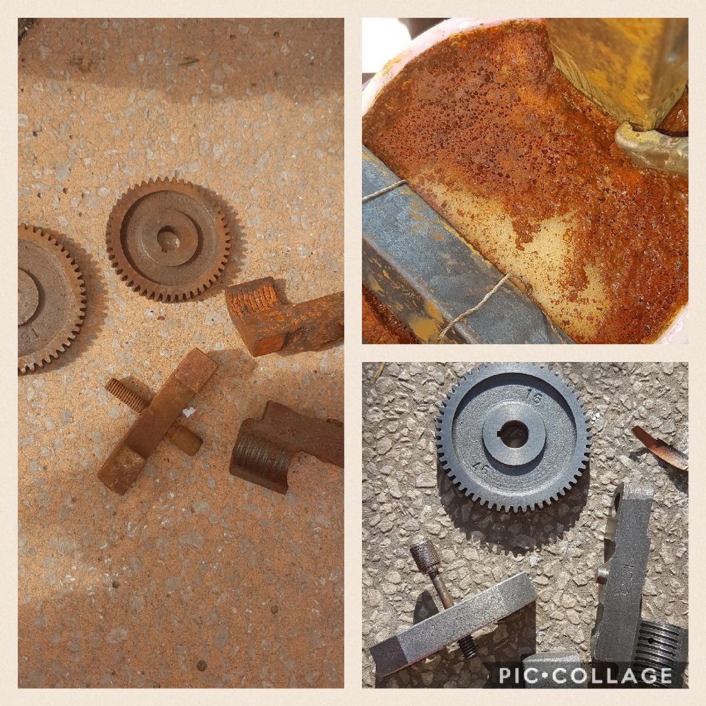

        Made a start on cleaning my lathe up and all the bits to go with. Here is a sample by the way of electrolysis. For those of you that have not tried it and want to see results. Here you arecollage 2017-04-17 17_46_04.jpg

          Hi Martin
          Having used this technique for a number of years on various restoration projects can I point other readers to
          http://antique-engines.com/electrol.asp
          Wire brush of Blackened oxides under running water and remove excess water the spray with WD 40 Or CRC Water Repellent.
          A Blackening process to finish off.

              I've used Electrolysis for cleaning rusty stuff quite a few times now. It works great and doesn't etch the surface like citric or other acids do.

                I use hot diluted phosphoric acid and that works well too.

                    Posted by Andrew Tinsley on 18/04/2017 09:56:01:
                    Andrew.
                    Not heard of that one, does it require scrubbing after the hot acid process and does it react or eat away at the good steel?

                        I am sure it does attack the steel, but only if you leave it in too long. It seems to go for the rust first. I did put in a large reamer with some rust on it. I left it in too long and the bright steel went a satin colour, but the rust was long gone.
                        I purchased 5 lts of conc stuff on Ebay. I dilute this down approx. 10 to 1 with very hot water and dump stuff in. It seems that hot is the key. Once it has cooled down a bit, then you can fish stuff out by hand and the acid doesn't affect my skin!
