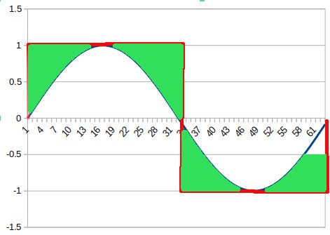

                            Posted by Jelly on 10/11/2022 18:30:16:
                            Posted by JasonB on 10/11/2022 17:12:23:
                            Posted by Tim Stevens on 10/11/2022 15:55:36:
                            A Q for Jason – can you explain what is the distinction you make between a brushless motor (for a lathe) and a 3-phase motor with inverter?
                            Tim, it's not so much the technical distinction so much as people being wary of "brushless" equiped machines.
                            I was under the impression that "Brushless" refers to a Electrically Commutated DC Motor whilst a "3-Phase Motor" would be generally taken to as referring to an Asynchronous Induction Motor.
                            That's my understanding too, and the main physical difference is the way the rotor is magnetised.
                            A typical 3-phase motor has a stator with three windings and a solid rotor with shorted copper straps running end to end. When the stator is energised, creating a rotating magnetic field, currents are induced in the straps, causing a magnetic field in the rotor late compared to the stator, so the rotor spins trying to catch up. RPM is related to the AC frequency except the rotor slips so the motor is asynchronous. Many advantages, notably simple reliability. but power is 'wasted' generating the magnetic field in the rotor, and doing so by induction across an air gap. It's possible to do better.
                            A brushless motor also has a stator with three windings, but the rotor's magnetic field is provided by permanent magnets. Thus no power is wasted by induced currents and the motor is synchronous. This type is relatively new on the scene because they depend on powerful permanent magnets that can take heat. Not easy – although super-magnets were invented in the late 1970s, they took nearly 30 years to become affordably bullet proof.
                            Early brushless motors with older magnet technology couldn't compete with 3-phase induction motors because the magnets weren't powerful or permanent enough, plus the electronics needed to drive them were expensive in 1970! Now good affordable super-magnets and electronics are available, brushless are supplanting 3-phase induction motors in many applications. In comparison brushless are lighter, more reliable, more efficient, and have better power, torque and speed control characteristics.
                            Another difference is 3-phase induction motors prefer to be powered with something approaching a sine wave, which limits how much oomph they can take. Brushless are powered by DC pulses with a higher power density. In the graph, the area coloured green is the additional power delivered by a square wave compared with a sine wave, about double:
