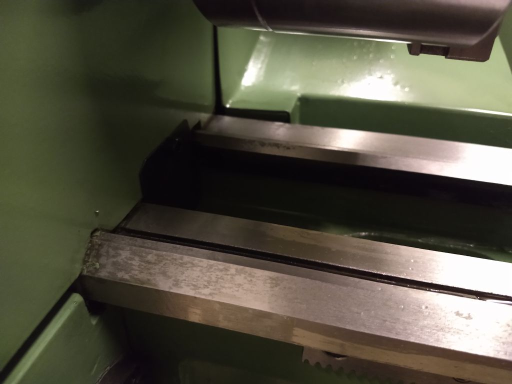

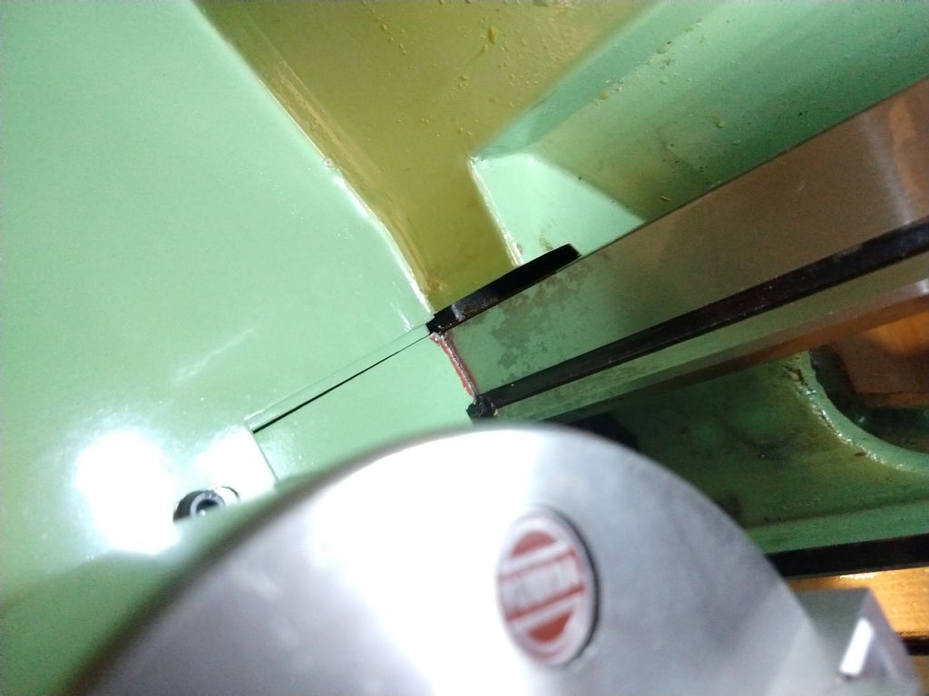

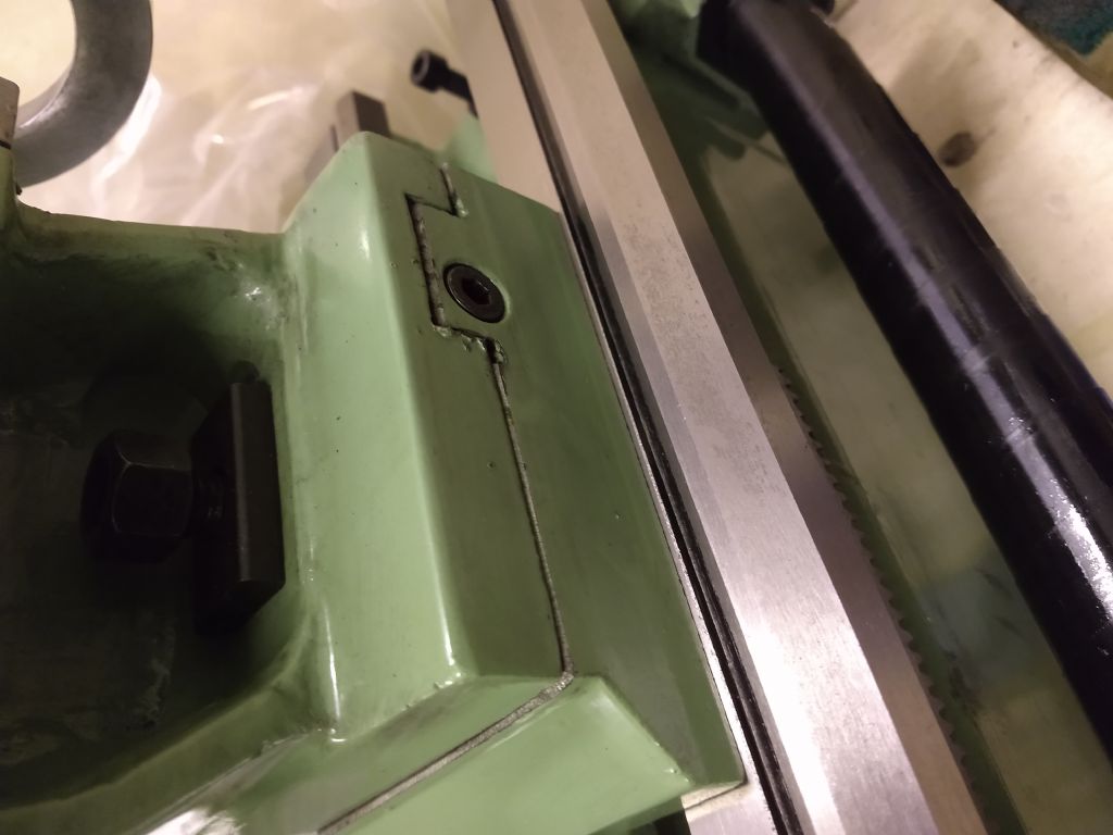

              It looks like light rust to me too, but from the photos it's mostly on parts of the prismatic bed that don't matter!
              This lot is under the chuck where the saddle never goes:
              And this patch is at the tailstock end; no effect on the tailstock which runs on the opposite prism, and unlikely to effect the saddle unless it's taking a very long cut:
              The bit to worry about is on the centre of the front prism which aligns the saddle in a normal position.
              My take:
              • This amount of rust on a second-hand lathe wouldn't worry me – it wouldn't effect the accuracy of the lathe and could be tidied up with a quick gentle clean. Rub down with an oily rag maybe. A China Basher would find this level of damage completely unacceptable, whilst being completely happy to restore a badly rusted Adept that wasn't much cop brand new in 1925!
              • But this is a new lathe. Personally I don't expect perfection from machine tools costing less than a sixth as much as the professional equivalent, but I would be worried that this one has been damaged in transit. (Michael noticed what look like water droplets in the first photo: maybe the box was caught in the recent heavy rain.) So I'd check it runs correctly and have a good look for other problems. If nothing else is found, I think the minimum hassle route is to clean the rust off.
              The kind of Model Engineer you are makes a difference! It's a hobby to be enjoyed, and some find it important for tools to be in tip top condition. At one extreme lie the "Fusspots", folk with gleaming workshops full of neatly organised brand-name tooling, and a Myford Super 7 dated accurately from it's serial number, and restored accurately to the exact colour used in 1951. Possibly no actual work is done, the workshop is enjoyed in it's own right. At the other extreme are "Slobs" like me. My workshop is a mess and I care little about my tools unless they fail to do what I want of them. My enjoyment comes from making practical things and learning to make them, everything I do is 'good enough' and rarely needs to be well-made.
              A hobby workshop should match the personality of it's owner. If John tends towards being a 'fusspot', then this is an emotional upset and he should contact Warco even if the problem is only a bit of easily fixed light surface rust. If John tends to being a 'slob' and just wants to get on with cutting metal, the best course is to make sure nothing else is wrong, clean the worst of the rust off, and put her to work.
              Edited By SillyOldDuffer on 09/11/2022 10:22:04

                    As another Warco WM250V owner I'm broadly in agreement with Dave. Handsome is as handsome does. I was and am very happy with my Warco, but mine came neither bare and rusty nor thickly covered in chicken fat. The bedways carried a light, clear(ish) grease that was readily wiped off with a rag and white spirit.
                    I wouldn't be scared of using green scotchbrite and WD40 on that rust, at least on a trial basis on the worst bit on the far flat chuck-end bed shear. I think you'd work all day without abrading a tenth off the bearing surface (even if it mattered there), but you might find the rust vanishes like scotch mist after a dozen strokes. Nevertheless it shouldn't be there on a new machine.
                    I'd want to know what the darkish out-of-focus marks on the chuck body are – mine still shines like silver after more than 7 years regular use, I've scotchbrited winter garage rust off it more than once, and it can still hold true within tenths.
                    It's your decision of course, but I'd say Warco ought to sort those issues in a way that's minimal hassle for you – maybe a partial refund if you can bring the machine to good working nick with a little work? I'm anything but workshop-proud, but I'd sooner any rubs and botches on my machinery were part of my story than anybody else's.

                            Posted by SillyOldDuffer on 09/11/2022 10:18:28:
                            It looks like light rust to me too, but from the photos it's mostly on parts of the prismatic bed that don't matter!This lot is under the chuck where the saddle never goes:
                            If the rust is only where the saddle (et al) never goes, wouldn't that suggest a used machine?

                                    Thanks for all the replies everyone, sorry I haven't had time to reply to them all in greater detail. They've been really helpful though and are very much appreciated.
                                    As instructed by Warco I cleaned it up with some scotchbrite this evening, and have attached photos of the result. While the rust is gone, and it feels smooth to the touch, there is still a visible mark. Communications are ongoing.
                                    Hugh, thanks for your PM, I will reply properly to it in the next few days when I have a bit more time and know what is happening.
                                    lathe - post scotchbrite.jpglathe - post scotchbrite 3.jpglathe - post scotchbrite 2.jpg

                                      Posted by John McCulla on 09/11/2022 22:26:13:
                                      Good result. Now get on and make some swarf. smiley
