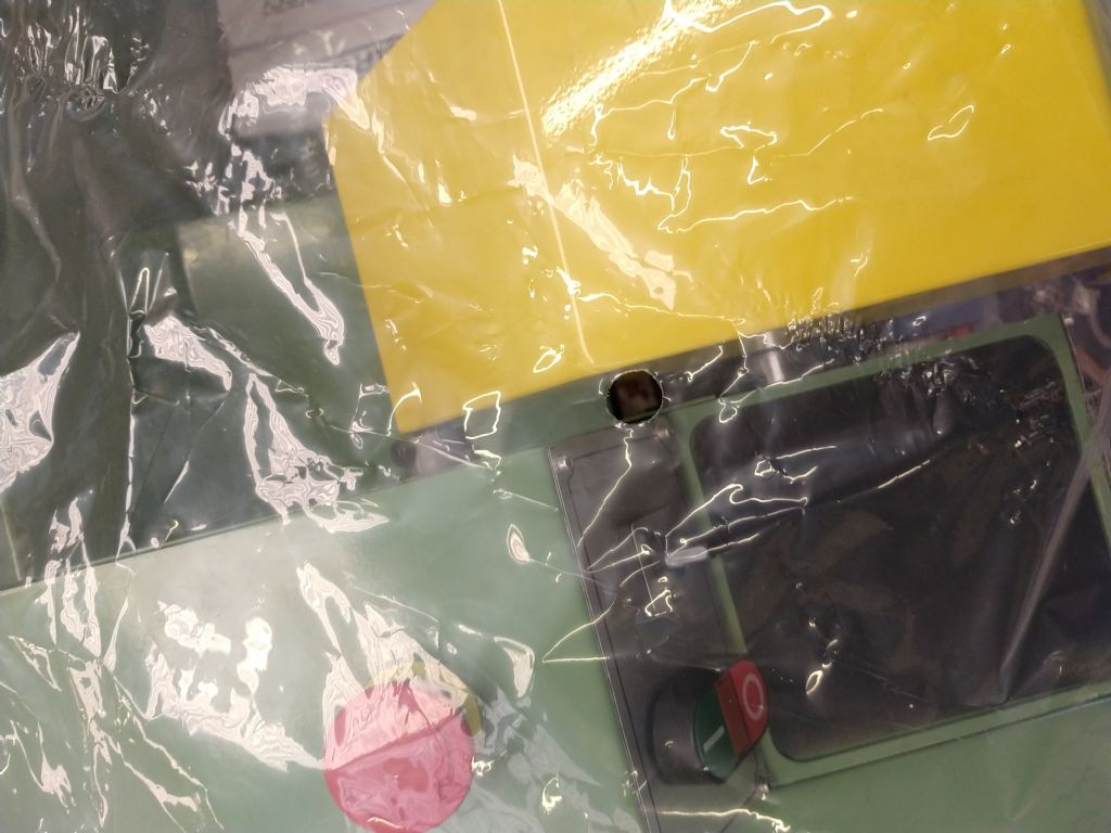

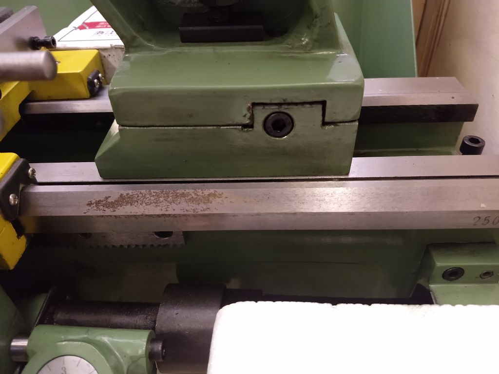

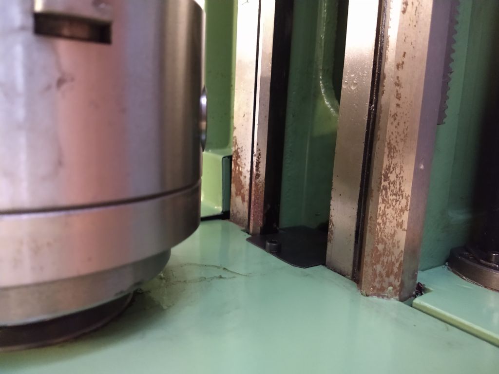

                      I've attached some photos, it definitely seems to be rust.
                      It's a brand new lathe, not second hand.
                      I've already spoken to Warco, they asked me to send them some photos in an email and they'd get back to me. I guess what I'm wondering is should I push for a new lathe or would be fine to just clean it down with wire wool as already discussed. I'm totally new to using a lathe, and I don't want to end up putting any inaccuracy into the bed, the lathe wasn't cheap after all.
                      This all may be a moot point, Warco may come back to me tomorrow and say they'll replace it, but it is a lot of hassle if it doesn't need done.

                        That does not look like a new lathe to me. Apart from the rust, look at the finish atoung the tailstock offset.

                          Posted by John McCulla on 08/11/2022 21:50:15:
                          Dare I ask, John ?
                          Is that water I can see ?
                          … if so, is it Warco’s water ?

                            No, that seems to be the only bit of oil that there is on the lathe bed. The rest seems totally dry.
                            The worst spot of rust you can see under the far side of the chuck seems to be directly under a hole in the inner plastic sheet, as if water dripped through it, but I'm not sure how that could have happened, the lathe was boxed up, there were no holes in the lid and the entire box was then plastic wrapped. It may be coincidence that the holes seem to line up though, it doesn't explain the rust elsewhere.
                            With regards to the finish around the tailstock, I had thought maybe that's just what you get with a chinese lathe, but as I said, this is my first one, so I'm no authority.

                              It does indeed appear to be surface rust, and you most likely could remove it with no consequence… But you should absolutely expect some consession or reparation from Warco if you are going to do that.
                              To Roberts's point, the tailstock offset corrosion of is the most alarming and egregious…
                              I'm not sure that means it's a used machine, my own interpretation of that photo is of long term exposure to moisture during transit allowing moisture to get under paint in a vulnerable area, which would fit with the lack of corrosion protective grease.
                              But it's still not good and that area warrants further inspection if you are going to accept the machine.
                              My working thesis is that Warco has reached a level of integration with their suppliers that they can do their QC (which is generally pretty good, I have been impressed with Warco products when I have used them) in the country of origin…
                              But for some reason that lathe wasn't properly prepared for export after inspection, and has been subjected to high humidity during its sea journey, and was then dispatched to you still in its crate without a second UK inspection.

                                            If this isn't a case of the manufacturer failing, unaccountably, to slather the ways et al. with grease before crating, I'd say it's a customer return that was left at Warco's storage facility for some time in the state in which it was returned [i.e. ungreased] and then re-crated and shrink-wrapped without much examination for delivery on to you.
                                            Is there any indication that on/off switches have ever been pressed by grubby fingers, a chuck key has ever turned in the chuck key recesses, or the chuck itself has ever gripped anything?
