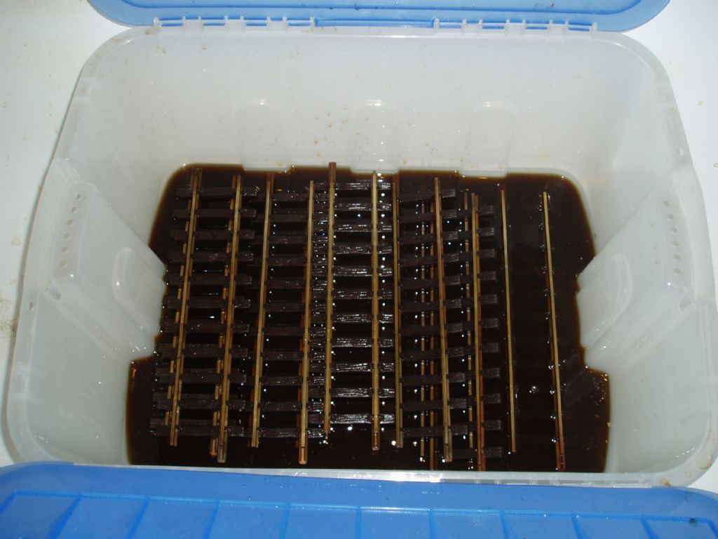

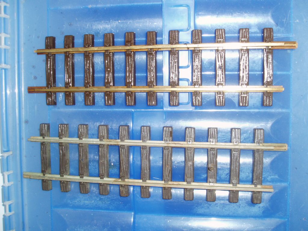

                    londonben10
                      @londonben10
                      I tried the Tea method on some old LGB G scale brass track.
                      The piece above in the photo is the result after 14 days immersion in tea, and no more than a rub down with a dish cloth.
                      The piece below is untreated and in the same condition as the treated piece was before it’s immersion.
                      I’m waiting for a friend to bring over an electric toothbrush which will hopefully finish the job and get to those hard to reach areas.
                      20 tea bags were brewed in a large pot, then transferred to this plastic container.
                      Thanks for the tip.

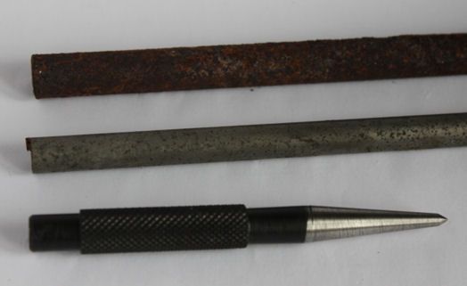

                                    Hi All,
                                    As many of you know, last year I suffered a garage fire which destroyed my workshop area along with tools , materials and projects lost. I actually managed to salvage quite a bit of stuff but it was badly rusted. I have now started to really make a move on setting up my facilities again and much of that involves removing heavy rust deposits.
                                    I have never used Hydrochloric (hcl) acid for de rusting before the suggestion by John Stevenson. Previously I have only used gentle solutions such as ‘restore’ but I decided to try John’s suggestion as I have a supply of hcl and the results have been astounding turning what looked like vague lumps of rust into usable items.
                                    As an example I have a photograph of a centre pundh that I made from some silver steel I managed to save. Along with the punch is an example of the rusted silver steel and a piece which came straight out of the hcl followed by had a wash and brush up (it is a different diameter btw).
                                    As an aside I quenched the red hot punch in motor oil to harden (cherry red) and then polished the end to allow me to temper to mid straw on a heated plate. The interesting bit is that I was always led to believe that the oil should be used motor oil and as dirty as possible. However I had no used oil so I used semi synthetic Halfords oil and achieved the best deepest black I have ever managed!
                                    I will post some other results that I have acheived by reclaiming stuff.
                                    Regards
                                    Terry
                                    PS the punch has been used successfully
