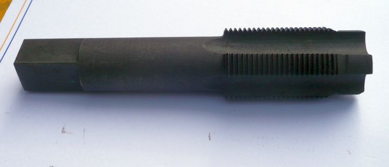

                          I did some experiments a while ago on a related subject that had good side effects on rust removal.
                          I get some plates cut at the laser cutters in 200 at a time in 4mm, 5mm and 6mm thick steel. The plate laser cutters use is made for lasers and has a shiny black coating that stops splatter and damage to the lens.
                          Unfortunately this oxide coating damages the webs on the small drill used on these jobs and drill breakage is an issue. The answer has been to surface grind the top face before drilling but the oxide coat clogs the wheel and wear wear now becomes an issue with wheels costing £80 each. So the answer has been to send them out for Lumsden grinding at 50p per side which soon adds up plus a 3 hour round trip.
                          After asking advise and trying things out I found that Patio and brick cleaner is 90% hydrochloric acid, not 90 % proof. If you place these plates in for 24 hours they come out with a grey sheradised finish on them and no oxide, also works on any black steel like angle etc.
                          Leaving in longer doesn’t do anything unto wards. The solution / fumes does not affect machines, I have had a big 5 gallon tub of this on the floor for months parked at the side of two dividing heads and 3 vises, none have discoloured.
                          Now the spin off, seeing as how it cleaned steel up I tried it on a rusty piece of metal, to whit a tap I found jammed in the base of an old cupboard this was absolutely red rust and to be honest it was scrap.
                          Left in for 2 days and when it came out it had the sheradised finish, was perfectly clean and when you rubbed you finger on the cutting edge it was sharp !!
                          Amazingly the sized etched on the shank stood out like chrome.
                          Since tried other makes and found the most cost effective is one from a big box builders merchants called Selco at about £5 for a gallon which you mix with water about 4:1
                          It’s not a nasty chemical you can put your hands in it just for putting bits in and out but best to wear gloves. to dispose of it you just throw it on the patio and wash down the drain, after all that’s what it was made for.
                          Trick is to look at the label in the big box stores, it needs to say “Contains Hydrochloric Acid” steer clear of anything that says green.
                          John S.

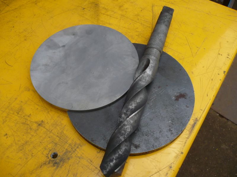

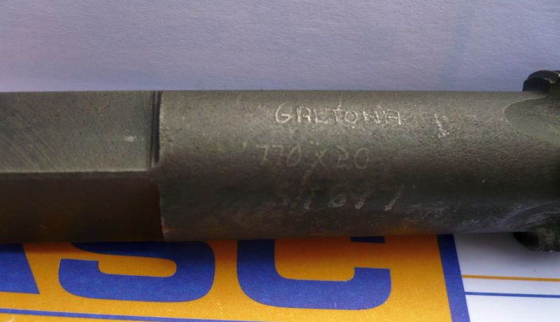

                                John Stevenson 1
                                  @johnstevenson1
                                  Sign of a warped mind replying to ones own post <g>
                                  But I did promise a picture of that tap, as i say i had no before picture but these two are the after pictures of what was a red rusty lump.
                                  Just as it came out the solution, not touch at all.
                                  And amazingly the size stands out. This came from Erricsons telephones and accounts for the weird size, they used to make al their own taps and dies.
                                  Just by chance the body shop guy across the road came over this afternoon and brought a bucket full of Morse taper drills he’d found in a barn he’s just bought.
                                  Not sure if they will be reclaimable but nothing to loose.
                                  This is one of the worst although there isn’t much to choose, can’t read anything on it and I don’t want to start wire bushing. Quick check with a caliper and it looks to be 26mm or may be 1 1/32″
                                  So bunged it into the plaggy tub and will fetch it out tomorrow or the day after and see how it’s come out.
                                  John S.

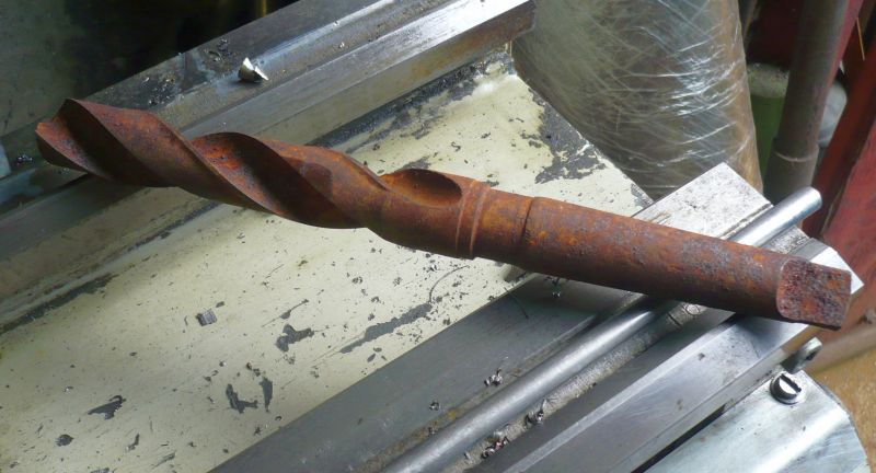

                                  #72081

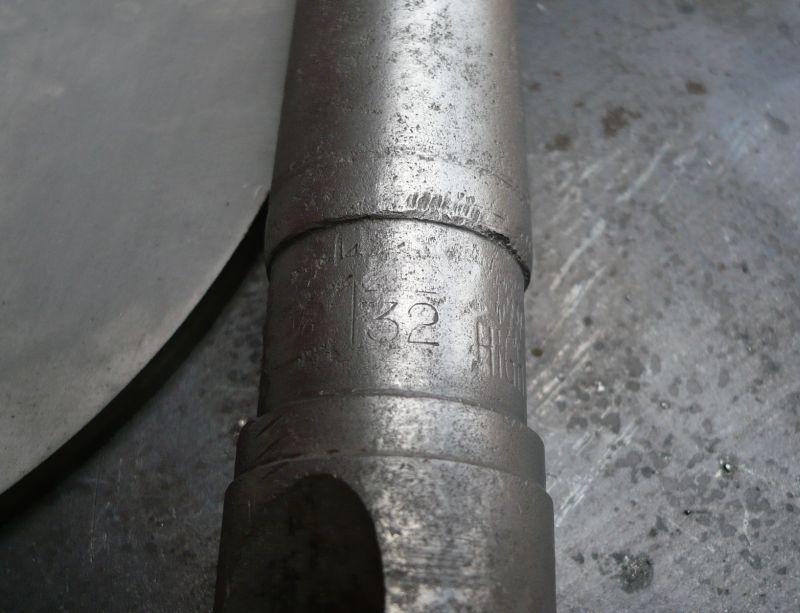

                                      Had a quick look just now at that drill and this is how it’s come out after just a rinse under the tap.
                                      Not the prettiest drill in the box but given the state it was in and about 18 hours later it’s rust free.
                                      The plates with it are the ones that get descaled. Actually that one in the picture has been in for about a month !!
                                      I missed it .
                                      Quick wazz with the loose flap wheel and this shows up.
                                      So 1 and 1/32″.
                                      This stuff costs about £6 -£7 per gallon and you dilute it about 3:1 so very cost effective.
