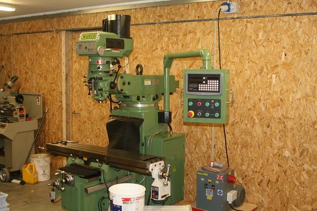

                                    With regard to Stuart's summary above, the VFD option is fine providing the motor on your machine is not too large. On my Harrison M250 lathe, I have fitted a 240v VFD which absolutely superb. The variable speed is used all the time, and even makes changing gears easier, when at minimum speed, (as opposed to turning the motor off).
                                    The mill's requirements on the other hand are too large for a standard VFD, hence the rotary device. The picture shows where it started. It's now moved to an adjoining room, but I can still hear the dam thing.
