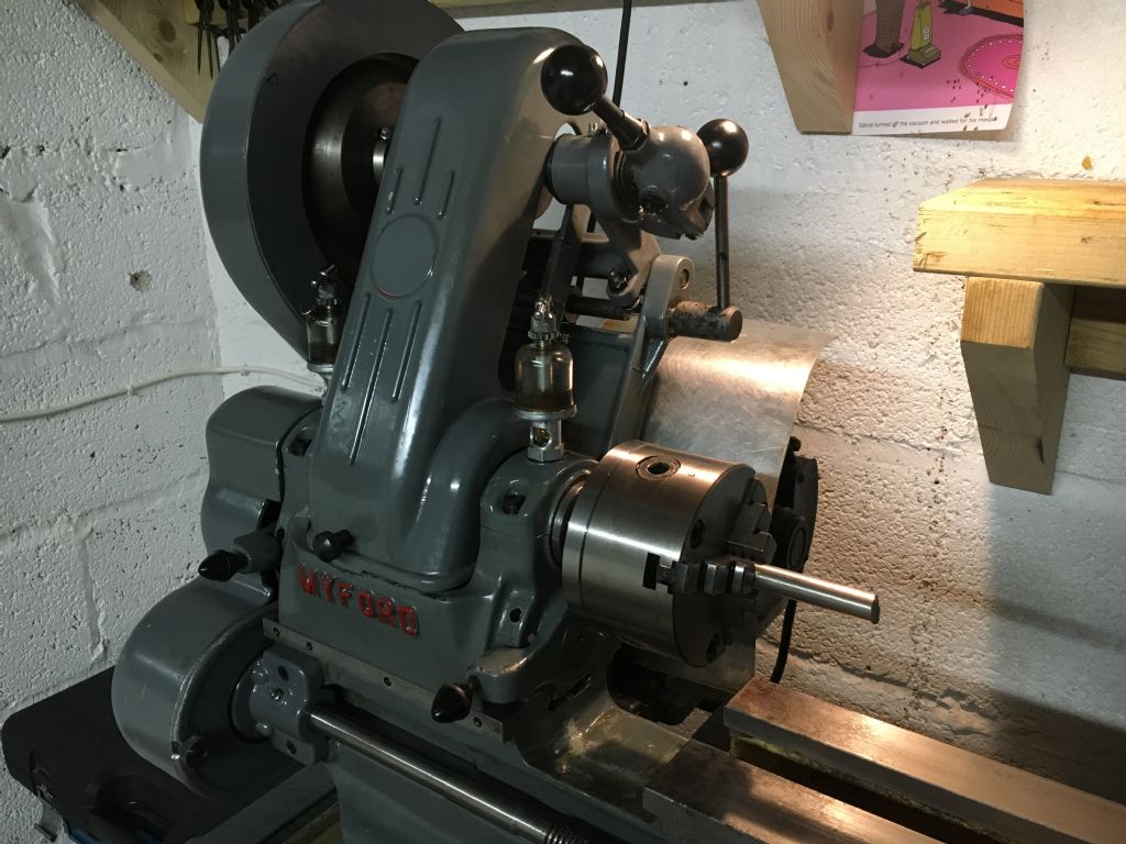

      Hi all,
      I’ve got a question regarding different length bar in my Chuck! Regardless of the length or diameter of bar, I seem to have run out with my dti gauge at the end of the bar. I’ve just fitted a brand new Chuck and backplate as I thought the old Chuck was worn !
      I was under the impression , with a new Chuck and solid bar, it should spin with no run out??
      sorry if this is a stupid question! Complete novice starting out!
      thanks in advance.

          Many more details required before anyone can provide a satisfactory explanation/excuse for that failure to meet your expectations.
          Some photos of the lathe would probably help

              Thanks for link! 1971 ml7! As I’ve never used a lathe before, I wasn’t sure what to expect! I assumed, a new Chuck with a straight bar, it wouldn’t have any runout. As I said, complete novice! Just want to learn.
              Thank you

                Sorry to have to give you the ‘reality check’ but 3-Jaw chucks cannot normally be expected to hold work really true.
                That’s why we often resort to 4-Jaw chucks or to Collets.
                … There will doubtless be a deluge of advice forthcoming !

                  1: First check the runout of the chuck register and also the interior spindle bore.
                  Meticulously clean the spindle and chuck threads.
                  2: Try swapping the jaws around into different slots, see which position gives least runout.
                  Even if you get it close with that diameter bar it may differ at other diameters.
                  3: get a 4 jaw chuck for critical work.
                  A 3 jaw scroll chuck may be better or worse, no guarantees.
                  A 4 jaw can be dialed in.

                    To those who use them regularly it is well known that if you take something out of a 3 jaw chuck and replace it it is nearly impossible to get it back in the same position without some fiddling about. The issue here is that there is friction between the chuck jaws and the bar, the chuck wouldn't be much good without it. At a small angle from the centre line the friction forces will be higher than the forces trying to line up the bar along the spindle centre line. You will find examples on line of people mounting a bearing in the tool post to push on bars to line them up, you will also find examples of people tapping then into line after clamping. If you put the bar in the chuck but not fully tighten it you can position a tool in the tool post and move it close to the bar and than turn the chuck by hand to see where it needs moving back towards the centre. Light taps with a suitable mallet, copper drift or machinists hammer can be used to improve the runout. Once it is in the best position you can tighten the chuck fully.

                        What was the run-out? I would expect up to about 0.1mm close to the chuck (that will increase further away from the chuck, of course) for a decent quality item.
                        Details of how you fitted the chuck on its backplate and to the lathe would be good. Complete novices are known to make mistakes.
                        Apart from chuck jaw aberrations, the spiral which drives those jaws is unlikely to be perfect along its multiple turns, so run-out may be different with different diameters of stock. This is also reliant on the stock being perfectly circular, of course.
                        As above, the general rule is to complete all machining before removal from the chuck if concentricity is required.
                        The ideal mounting of work is between centres, where the work can be removed and replaced between those reliable points, to maintain concentricity. Even then, the drive-end centre would be one turned on the lathe as a fixture for that particular job.
                        Collets can be good for smaller diameters, the 4 jaw independent chuck for larger items. The self-centring chucks are way down the list…

                            I see 3-jaw chucks as a speedy convenience rather than an accurate way of holding work with low run-out. Don't expect too much of them! Chucks get worse over time due to wear and tear. Jaws can be replaced or reground, but damaged slots, scrolls and registers are hard to fix.
                            For many jobs 3-jaw inaccuracy doesn't matter because the lathe cuts relative to the spindle axis. Relatively short jobs held close to the chuck come out OK. However, don't move jobs in and out of the chuck because it's extremely difficult to position work on the spindle axis exactly as it was before.
                            For low-run out, and if work has to be moved, it's necessary to dump the 3-jaw in favour of a 4-jaw chuck or collets.
                            4-jaw chucks can be adjusted with the aid of a DTI to almost completely eliminate run-out, but it takes time to do. Nonetheless, there is a faction who never use anything but 4-jaw chucks – speed comes with practice.
                            Collets are fast and accurate but pricey because lots of different sizes are needed and they suit some types of work more than others.

                                        Round bright bar is neither very round nor very straight, the chuck may be fine.
                                        A new 3 jaw may have a 3thou wobble built in, some may be perfect.
                                        Rotate the bar bit in the jaws and re tighten it may be better.

                                                VERY few 3 jaw chucks will hold anything absolutely concentric, even if very accurately matched to a backplate that has been finish turned and face on the lathe in question.
                                                Expect something of the order of 0.075mm eccentricity for a good one, when new.. The concentricity will vary according to the diameter being held.
                                                You are depending upon:
                                                the accuracy of the scroll location within the chuck body,
                                                the accuracy of pitch the scroll,
                                                and the accuracy of the jaw face relative to the "teeth" that engage the scroll,
                                                not to mention all the clearances.involved
                                                Start adding up clearances, of say 0.012 mm, at each interface, and the tolerances on the dimensions of each part. You should be agreeably surprised at what you have found for concentricity!
                                                (I have only ever seen one 3 jaw that held work truly concentric ).
                                                A chuck that has seen a lot of use / abuse, may well have jaws that are bell mouthed and gripping less well. or accurately.
                                                Bar may well not be truly round. It is not unknown for centreless ground bar to be trilobular, rather than absolutely round. Check some with a DTI when resting in a Vee block
                                                If it has been ground between centres you stand a much better chance.
                                                If you hold the work in a 4 jaw, independent, chuck the eccentricity will depend on the operator; on how much trouble and time they are prepared to devote to bringing the work to run concentric.
                                                Generally, if it is within 0.012 mm near the chuck jaws, I am satisfied.
