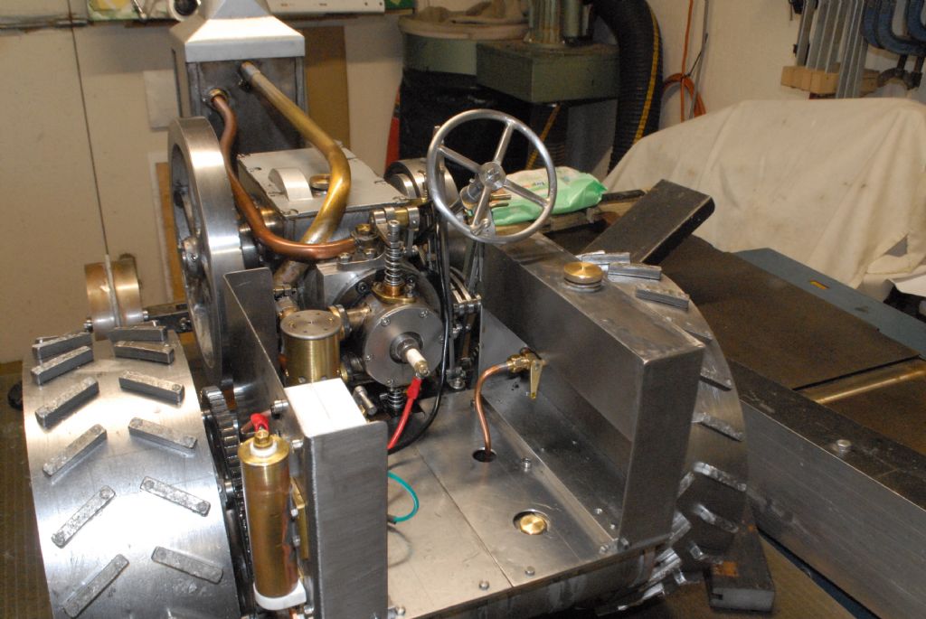

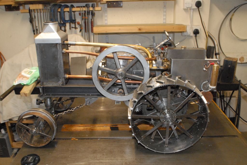

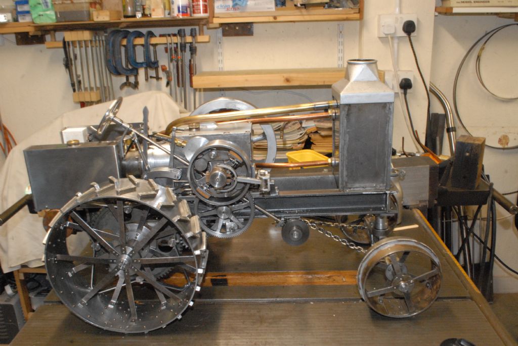

                                            John Rutzen
                                              @johnrutzen76569

                                              John Purdy
                                                @johnpurdy78347
                                                I wonder how many drivers in real life got a shock by accidentally leaning on the spark plug !!
                                                #566978
                                                  That's all looking and sounding rather good, I'm sure it's just a small tweak or two to get it running how you want.
                                                  #566996
                                                  John Rutzen
                                                    @johnrutzen76569
                                                    Thanks Jason, John, I don't know how many of them got a shock but I got one today! Gave me a jolt, I'll have to put some insulation on the nut. The other day the top of the spark plug blew out. The plug is one I made, the insulator is Corian and is just superglued in.
