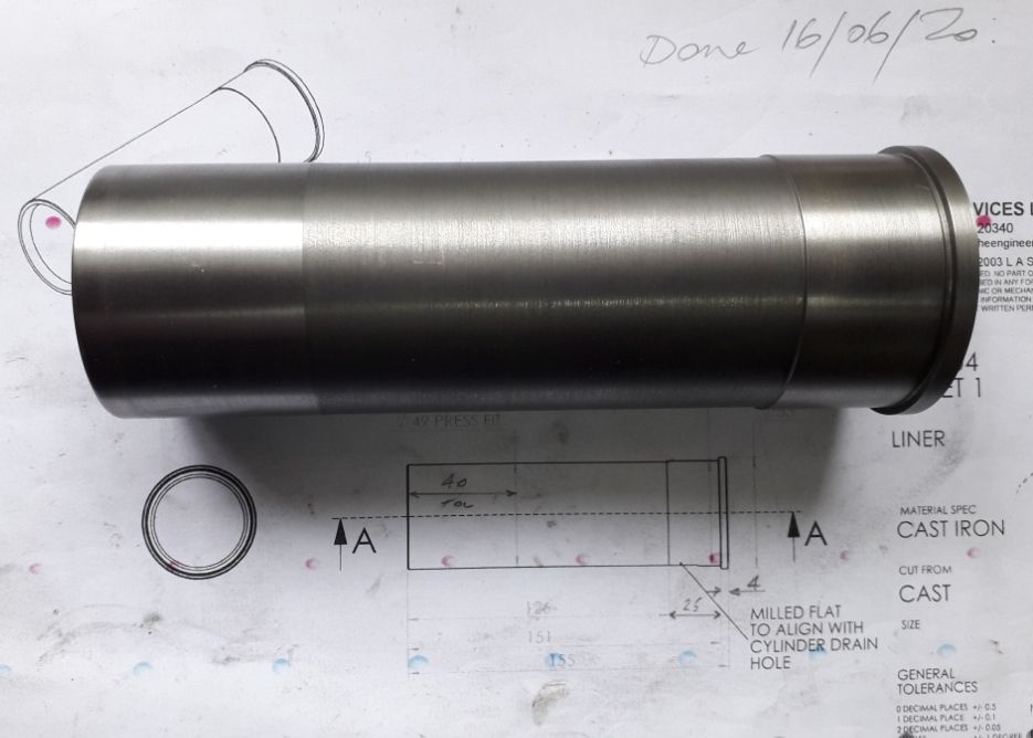

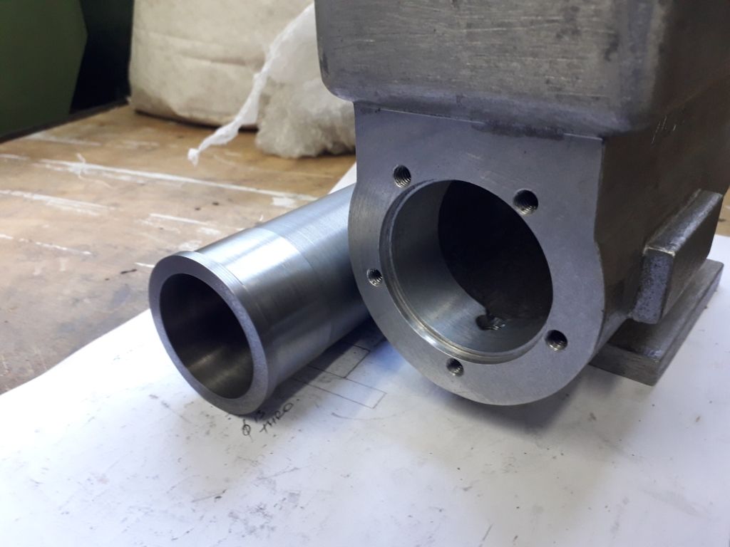

          My Economy Engine from The Engineers Emporium has an aluminium block with a CI liner so I see no reason why not, the block is relieved in the centre so give location at either end of about 30-40mm and has a small flange at the head end for the gasket to seal. I made mine a very slight interference fit and ran a drop of Loctite 638 around each end before using my press to fit the liner. Incidentally the piston is from HE30 bar. I'll see if I can find a picture fo the parts before I assembled them.
          Looking forward to seeing the drawings and the end results!
          #501877
          Henry Brown
            @henrybrown95529
            Forgot to add the bore and stroke is 42mm x 73mm and the locating diameters (polished) are 49 and 50mm diameter for easier assembly.

                  E. T. Westbury's Wyvern horizontal engine has a CI cylinder liner shrunk into an aluminum block/water jacket and works fine, at least in mine. If I recall I made the liner .001-.002 larger than the bore of the block then to assemble I heated the block in the oven to about 400F and put the liner in the freezer. The liner just dropped in with no problems.
                  #501939
                    I've done 3 or 4 open crank ones with CI liner in alloy and even more Ci in CI all a firm push fit and 648 Loctite which makes for a less stressful time joining them together. Like Henry, a step of a few thou in diameter allows the liner to easily slip most of the way in before things start to tighten up.

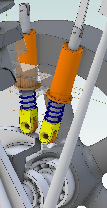

                        Does it use a traditional "cam" shape as we know it or an eccentric? maybe a combination off the two with a strap around a cam shape so it makes contact on the far side of the rod's end and pulls it.
                        Another possibility would be a simple spring between cam follower and rod guide.
                        Edited By JasonB on 18/10/2020 07:38:57

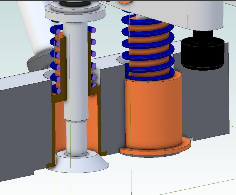

                              I've incorporporated a bell crank into one of the valves and a lever into the other. I would like to use an aluminium alloy cylinder head because I have lots of block of a suitable size. I am basically following E T Westbury's engine design for his road roller where I can. He uses a caged inlet valve and the exhaust valve is seated on the cast iron head. Do you think I could use a bolted on bronze inlet valve cage and loctite a bronze valve seat into the aluminium head? I thought bronze would be better than iron or steel because its' coefficient of expansion is closer to that of the aluminium.
                              Edited By John Rutzen on 06/11/2020 17:27:09
                              #505653
                                You could make the seat and cage all as one and have it a light press fit from the inside adding a drop of 648 Loctite for good measure. Exhaust passage is drilled once cage is in place. This is how the Nemett engines are done.

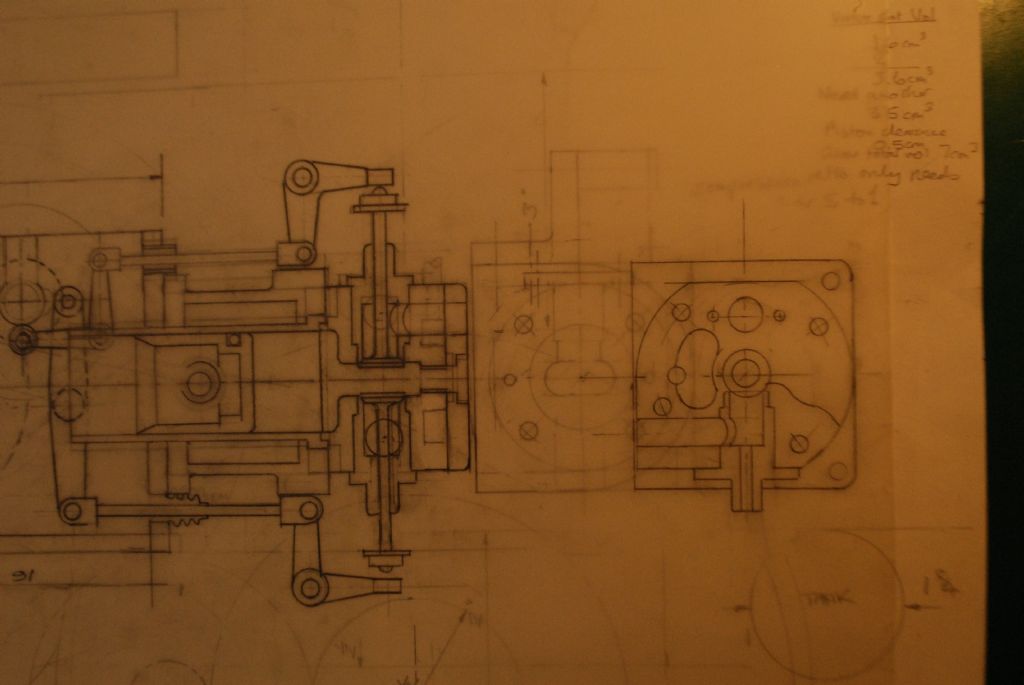

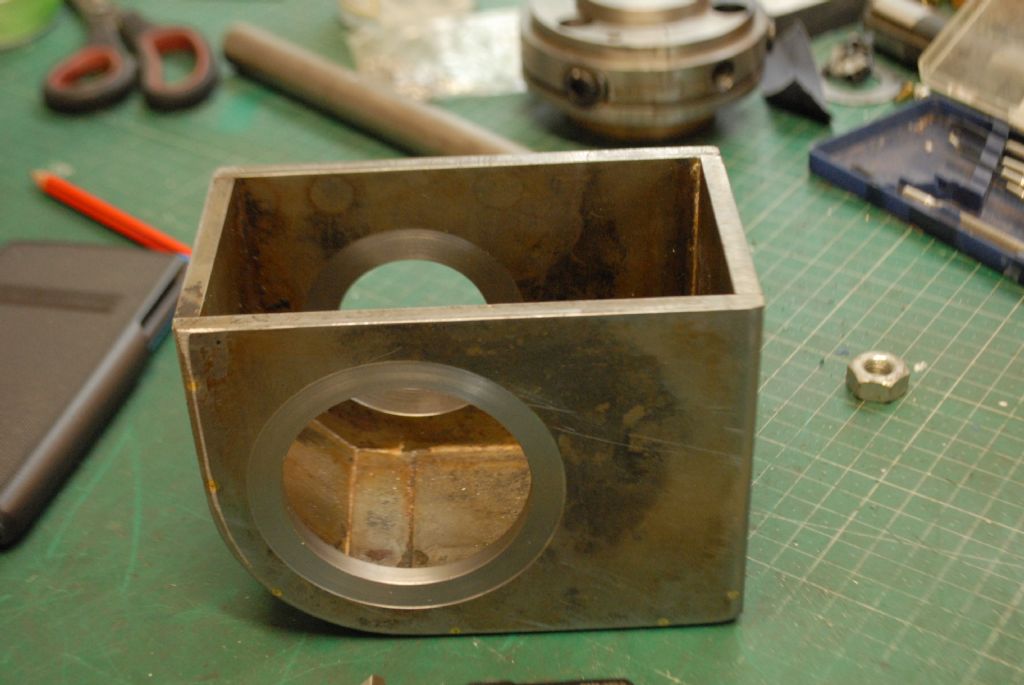

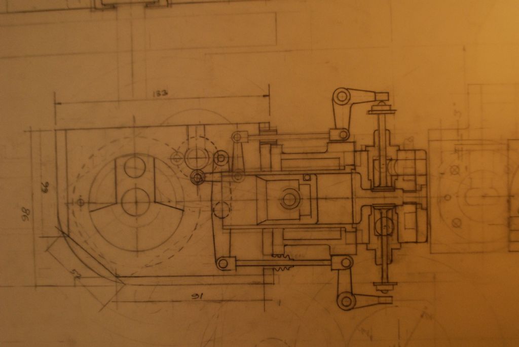

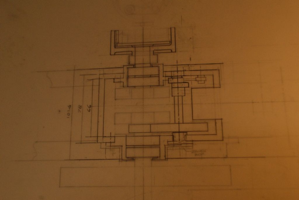

                                  dsc_0053.jpgdsc_0052.jpgdsc_0051.jpgThanks Jason,
                                  i'm uploading some photos of the drawings here and one of the fabricated crankcase that I've just made. I found that 6mm steel is very difficult to heat up enough to silver solder it [with propane]. Much harder than copper and I've made a 5 inch gauge boiler.
                                  #505854
                                  John Rutzen
                                    @johnrutzen76569
                                    Sorry the drawings aren't great but I hope you can get the general idea of the valve arrangement. I tend to draw full size and scale parts off the drawing. Hopefully I'll learn CAD one day but I find drawing much quicker.
                                    #505865
                                      Drawings are clear enough to see, those bronze cages should be fine. Crankcase is looking good too.
