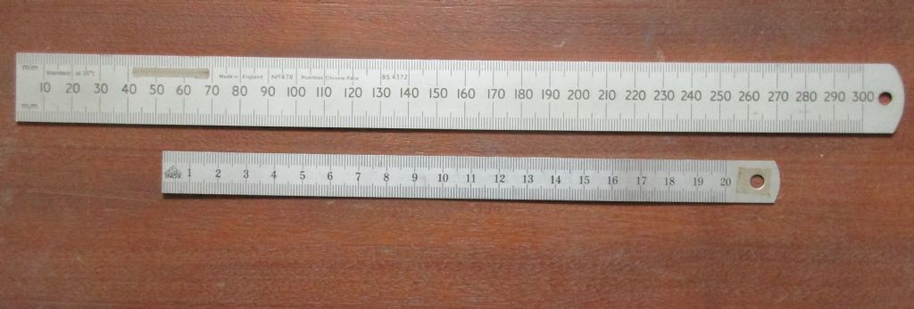

                I like the scale on the rule in Spurrys post , I've seen them but didn't appreciate why the tapered graduations were there.
                I have some rules with slot graduations on the short end, as discussed before, ideal for some jobs.
                I also have some rules with the numbers engraved so that it can be read when vertical without having to crank your neck round like an owl. Fabulous for setting surface gauges etc.

                                                    I happen to like the Axminster hook rule for the same reason I mentioned the rule that kicked this thread off again, I feel that a rule with metric and imperial scales is just too much of a compromise and the chance of having the scale you want on the edge you need is going to be rare. John mentioned he had a substantial collection of rules that didn’t suit his needs but did eventually find a supplier of his dream rule. As with most things our personal preference is likely to be different from next mans, one thing is true and that is there is a wide choice of rules out there so you just have to find the ones that tick your selection boxes.
