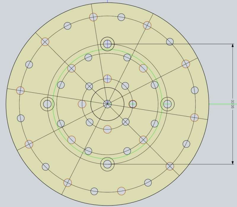

                    I  go with Clive, make a fixture table. I have a SX1LP mill – smaller than yours – for which a 4″ table seemed ideal, however with four big (M10 size) T slots on the small table clamping things soon became a pain. So I made a circular fixture table from a 125mm diameter x 22m thick aluminium billet and tapped it with a circular array of M6 holes. It now suits the mill very well. This is it in use making the table support for the Hemmingway filing machine.
                    I used 125mm because that’s the largest diameter I could turn on my little Taig lathe, and also because that’s the largest size that still allowed me to use the table vertical with fixture plate fitted.
                    Table support
                    And the pattern I used. The 90mm spacing of the four mounting holes was chosen to match the spacing of the mill table T slots so that it is possible to bolt the fixture plate directly to the table if needed.
                    Rotary Fixture Plate

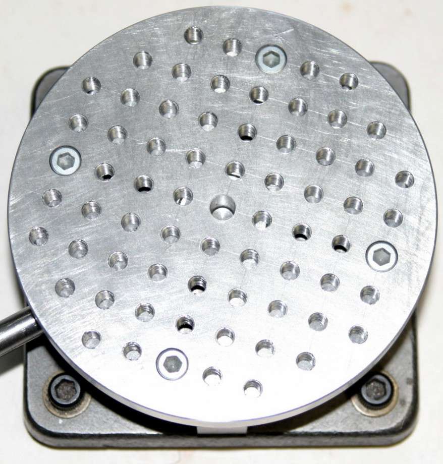

                      I’ll second Clive’s suggestion of a tapped sub table if you opt for a smaller table. Makes clamping so much easier and in some cases the only way possible. Here’s the one I made for my 4″ table, holes are tapped 10-32 on a 3/8″ grid. (My workshop is, for the most part, non metrificated !)
                      Rotary Table 2

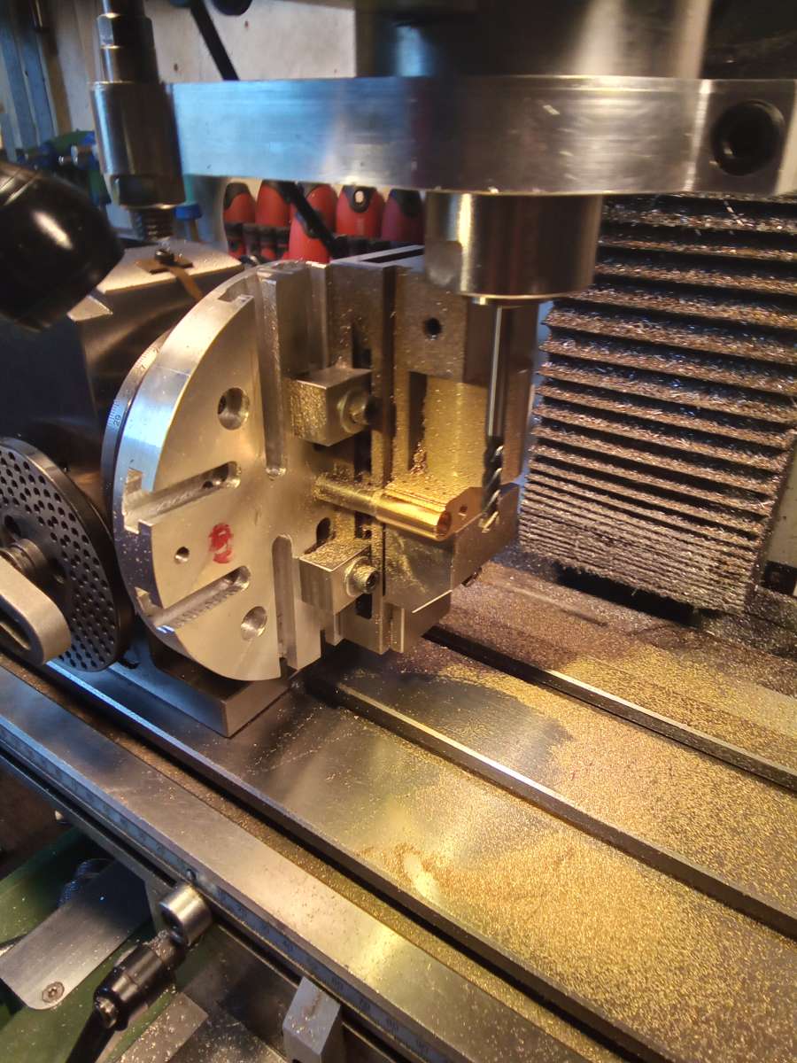

                          A T-slotted plate with parallel rather than radial slots can be handy too (pictured on a dividing head here, but handy on a rotary table too):
                          20241022_155905
                          The dividing head is from Vevor by the way, the spring clip on the sector arms needed a little filing, but good value nonetheless.

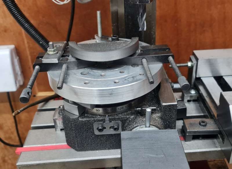

                            Hi, I bought a Vertex 160mm, but 1st thing on receiving I realised, the 3 slots aere imprctical to hold anything, so I went ahead and made a 200mm aliminium plate and bolt it to the 3 slots.
                            1-I then drill & tread multiple holes (Lot of work).
                            2-Made easy centre MT2 location to locate the Rotary table.
                            3-I made my own clamping system.
                            a)For stops of rotary movement, or any other stops required.
                            b)Position blocks to position the object on the table off the table.
                            c)Holding down holders. All of these use 8mm bolts to make the clamping possible.
                            Its now a pleasure to use. The clamping is flexable because of all the holes, and I can drill a few more if needed. I also used short grubscrews to fill holes to keep swarf out of holes not used. If used I just screw the grubscrew down to the bottom, enough thread left for clamping.
