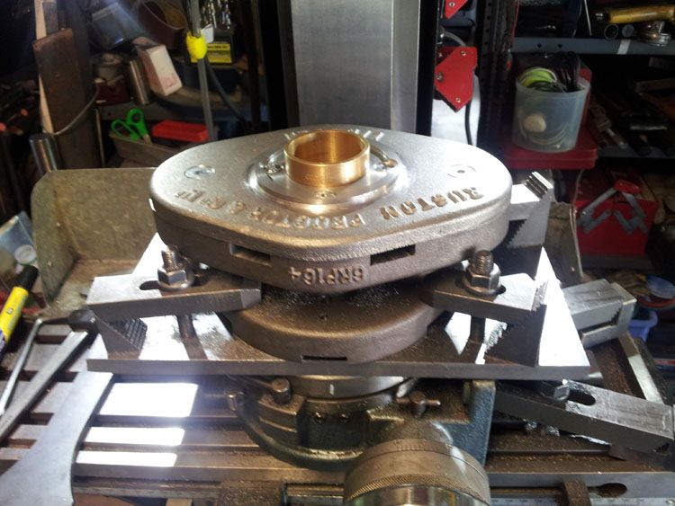

                                      Your mounting plate can be larger than your rotary table. Just depends on how rigid it is.
                                      I have a 6" rotary table on which I bolted a much larger plate. The plate locates on the centre spigot and is restrained by 4 countersunk cap screws and tee nuts. I then tapped some holes and used my mill clamps to hold the job.
