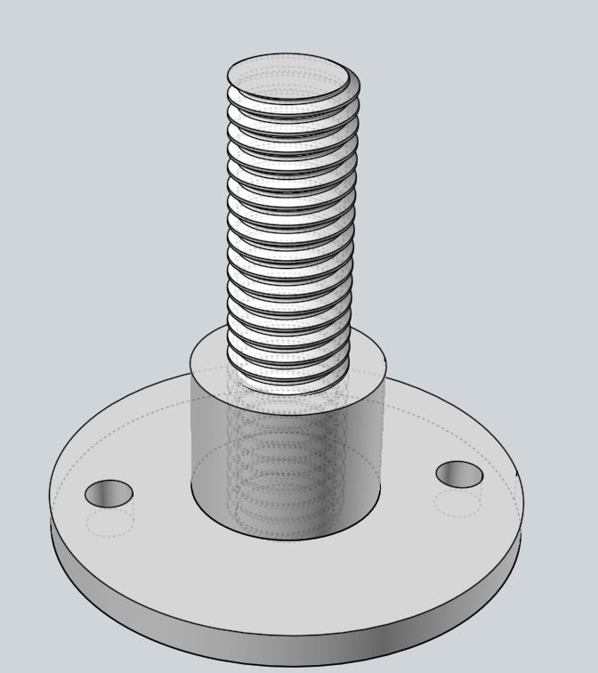

      I have a small rotary table with an MT2 hole in the centre. I want to put my MT2 ER25 Collet chuck in to machine some concentric lands at 90 degree spacings on a small (12mm diameter) part.
      The problem is that the bottom of the central tube is only about 3.5 mm above the base of the table itself – so not enough room for an M10 bolt and washer to act as a drawbar. It's not a problem with the table set vertical, but horizontally it's a bit of a problem.
      I am planning to make up a special which is thin enough on the bottom to fit, and with holes for a pin wrench to do it up.
      However, given that the real grip on a morse tape is provided by the taper itself once engaged, could I get away with installing the collet holder. Use a standard M10 bolt and washer to pull the taper up fairly tight, then remove the bolt before mounting the table horizontally?

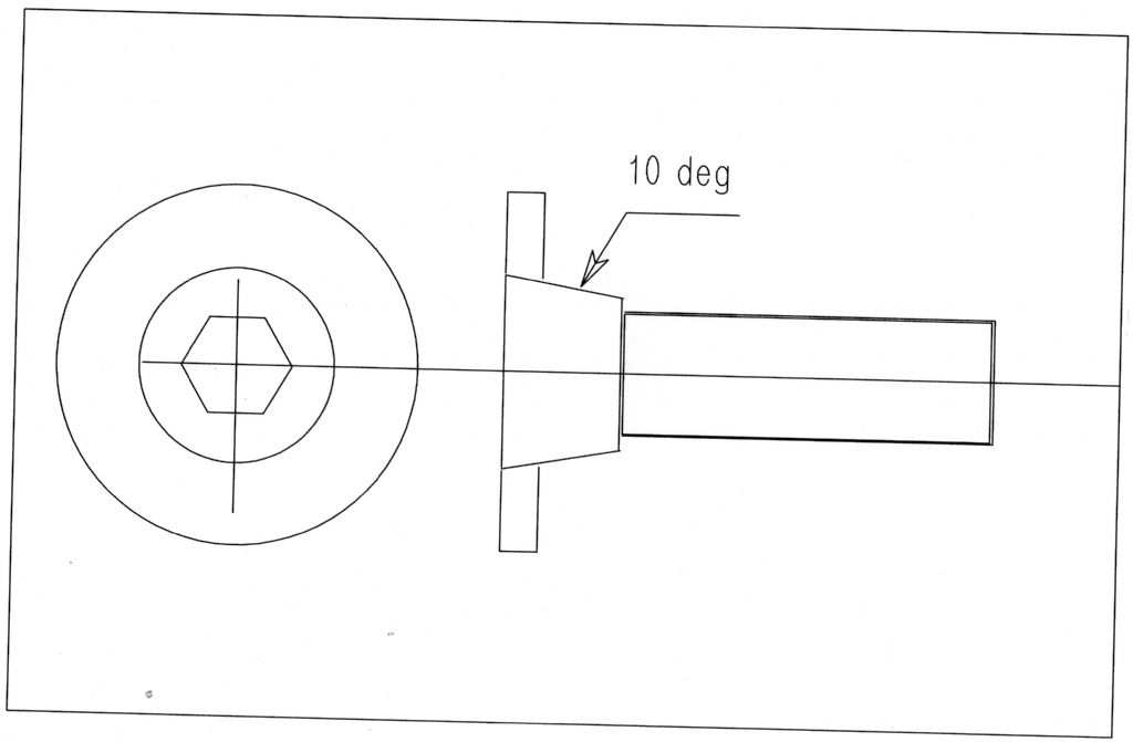

              Sometimes i use modified caphead screws to enable a a low
              profile type of fixing , this may work in the application in
              securing your chuck as a draw bolt .
              A 10 mm caphead screw is turned with a 10 deg taper
              and the washer made after so the head of the screw
              is level with the washer ,is a simple job to do and has a
              8 mm allen key.

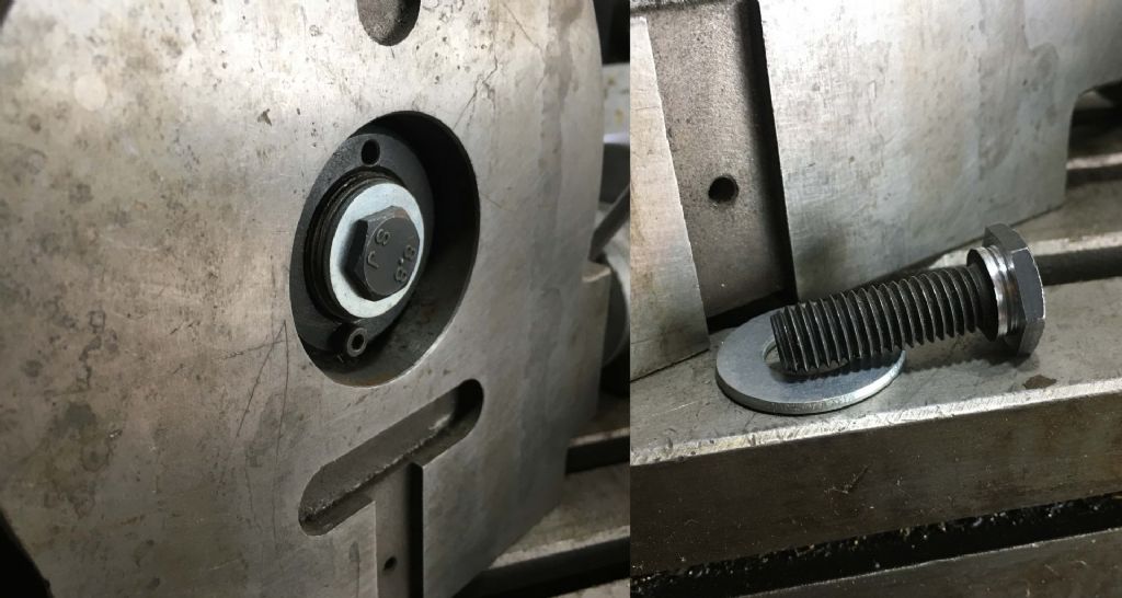

                  The drawbar on my RT is a standard hex bolt with the head turned down (on the threaded side) to accept a flat washer. The thread size is M10 and washer is for M12. (A 2 minute machining job).
                  Paul.

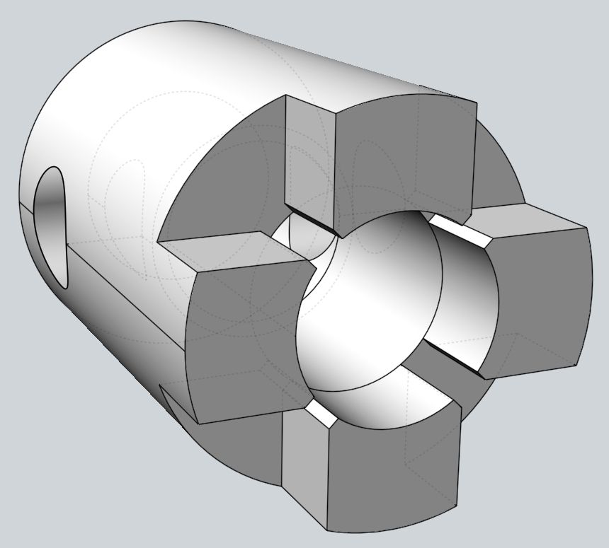

                              To answer the queries, the part is one half of a small dog clutch. Overall diameter 12mm.

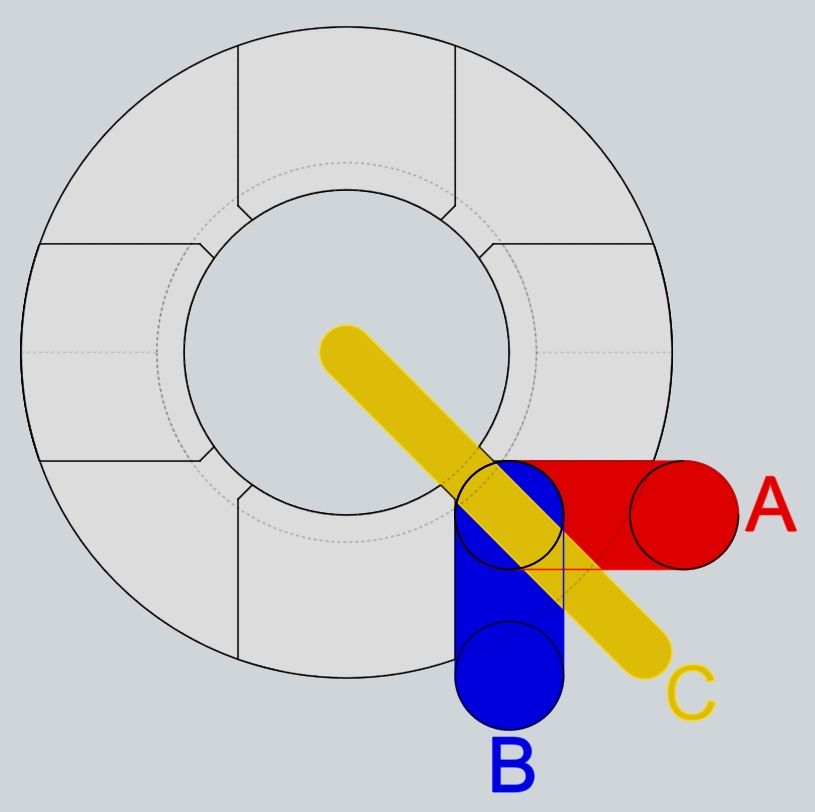

                              I had planned to cut the lands out using three cuts. A & B use a 2mm cutter. C is a 1mm cutter. I was planning to do cut A – rotate 90 – repeat four times, then do cut B and rotate four times again. Then rotate 45 degrees and do cut C – probably going straight across, rotate 90 and repeat.

                              I could do it by holding the part in a Stephenson block in the vice, but given my propensity for error (and scrap production), setting up all the cuts differently seemed somewhat risky. Rotating the block would (probably) loose centre at some point – see above propensity!
                              I could see how to do cuts A & B it with the table vertical by doing A & B from opposite sides, but I can't do C that way ( I don't think).

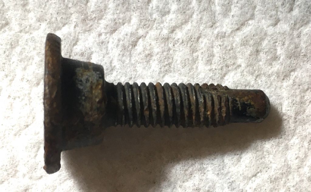

                                    I was out for my walk today, and found this lying in the road:
                                    it is in one piece, has a Torx socket, and appears to be self-tapping … but, in general concept is uncannily similar to your design.
                                    … Looks useful : Does anyone know what these are called ?

                                      Hi Michael,
                                      Tyre fitters bonus.
                                      #547809
                                      Howard Lewis
                                        @howardlewis46836
                                        Looks like a rusty self piercing setscrew!
                                        Intended to be driven in by an air gun or a battery electric screwdriver.
                                        Probably fell off a passing car.
