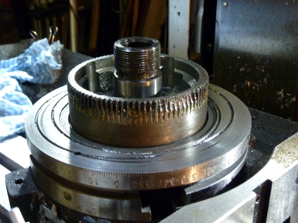

                      Your choice of 36:1 or 90:1 will depend on the type of work that you intend to do.
                      The 36:1 model would probably have bigger, stronger teeth and more suited for machining while rotating the table while the 90:1 model will be more accurate but will have smaller, weaker teeth. No problem if locked in stationary position but not as good while rotating.
                      Many of the smaller RT's have a worm wheel which can be easily damaged. As I found out the hard way. (this was an expensive Japanese made RT, not one of the cheaper ones)
                      Paul.
                      Edited By Paul Lousick on 11/08/2020 23:40:47

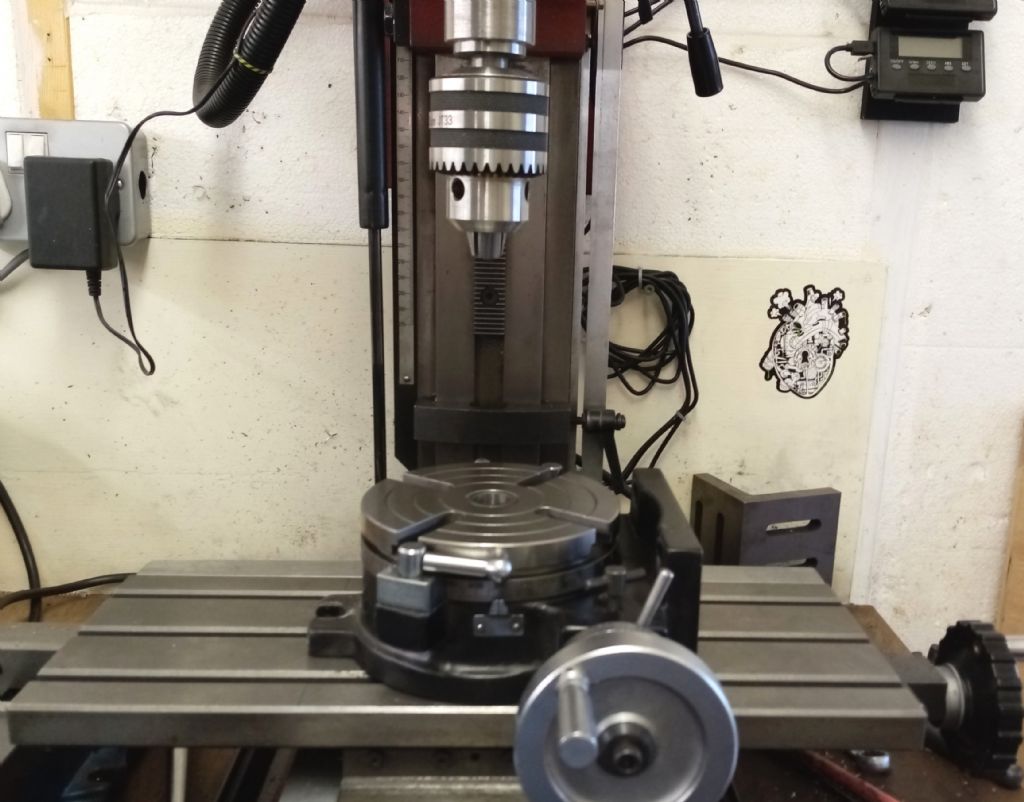

                              Ron Laden
                                @ronladen17547
                                Peter, I have the SX2P mill and apart from it having 25mm more height between table and spindle the table size and X and Y travel are the same as your SX1LP. I started out with a 4 inch rotary table (a cheapie dont go there) but I found it a bit too small. A 6 inch would be too big but came across a 5 inch which is what I went for, came as a set with chuck, tailstock and plates.
                                A picture below showing its size against the table which gives you some idea. With the 4 jaw chuck and backplate fitted and a Jacobs in the spindle there is only 45mm between the two chucks so I have had to resort to shortening one or two drills in the past. There is more space of course with collet mounted drills and cutters and without the 4 jaw there is 205mm between the rotary face and spindle.
                                Just thought I would mention it should you want a bit bigger rotary though a 4 inch version may well suit your work.
                                Ron
                                p.s. The 5 inch version is 90:1
                                Edited By Ron Laden on 12/08/2020 12:37:53
                                Edited By Ron Laden on 12/08/2020 12:52:21
