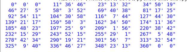

                                          On JasonB Said:
                                          Idon’t know what others are expecting in the way of accuracy in the home shop but here is an example.
                                          Daves 31T gear
                                          What tolerence do people actually need and what are you making that needs it?
                                          Wasn’t me who introduced accuracy! Presumably cropped up because my example 360/31 is 11.612903225806451 recurring?  I assumed, silly me, it was understood that the number of digits taken from a decimal number are adjusted to meet the needs of the job. Accuracy sufficient to meet the needs of the day, and no more.  In a 31 toothed gear rounding to:
                                          • 11 causes a 19° error – unacceptable
                                          • 11.6 causes a 0.4° error – might be OK on a traction engine, not on a DTI gear
                                          • 11.61 reduces the error to 0.09° – still high for a precision gear
                                          • 11.612 reduces the error to 0.028° – much more like it, at least on a small diameter
                                          • 11.6129 rounded up to 11.613 gets the error down to minus 0.003°.  Good enough for most mechanical applications.  Hopeless for Satnav though: a 0.003° error is over 330metres!

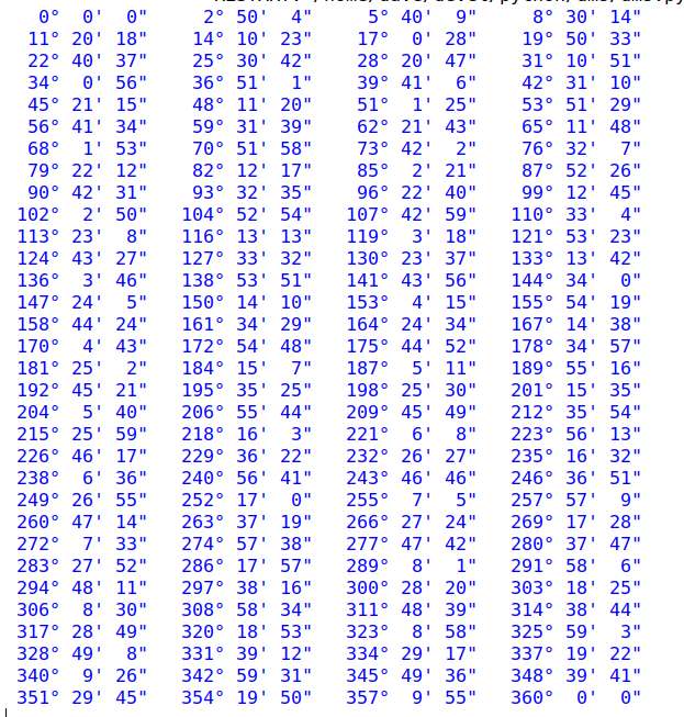

                                          Another problem to watch for is accumulating errors.
                                          Going back to the “do I need dividing wheels” question, that’s a different case.   Index wheels on a rotary don’t improve accuracy; they reduce human error.  Without them cutting a 31 toothed gear requires the operator to calculate and meticulously follow a table like this one:
                                          31teeth
                                          Gets worse as the tooth count rises, here’s 127 teeth:
                                          127teeth
                                          Assuming the manual is correct, dividing wheels get rid of the possibility the operator will get the sums wrong, and the clock/plunger/indexer reduces the risk he’ll miscount or loose track.  This isn’t accuracy as addressed by Jason, this is accuracy improved by avoiding mistakes!
                                          Having dividing wheels for a rotary table would be a no-brainer except better is available.  Turning the rotary table with a microcontroller further reduces the chance of human error, and  they’re much less tedious than manually clocking round an index.  Doing without either is possible, but bothersome unless the divisions are all simple or the table is rarely used for anything complicated.
