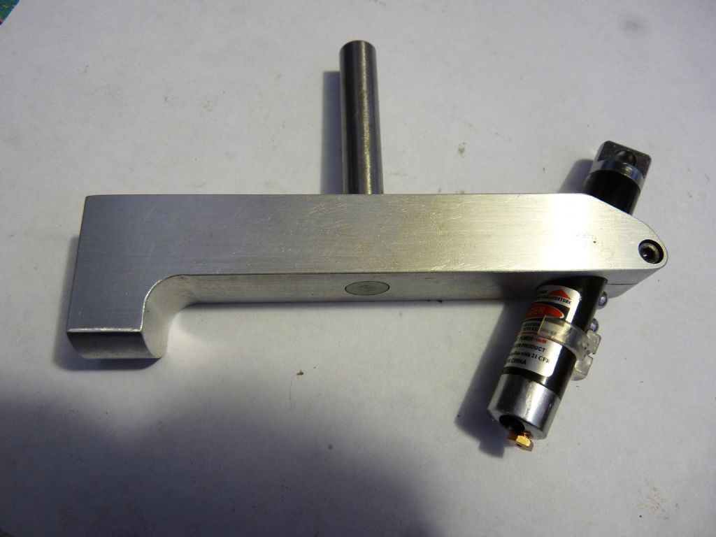

                            #184558
                            CotswoldsPhil
                              @cotswoldsphil
                              Here is my attempt at the completed device. It's balanced to within the weight of an M4 nut.
                              The main problem I find with it is, I can't get close enough (to the rotating mass) to achieve the accuracy I can achieve with a sharp point held in the chuck.  The other is I've yet to find a suitable white marking fluid Correction fluid (TippEx) flakes off.

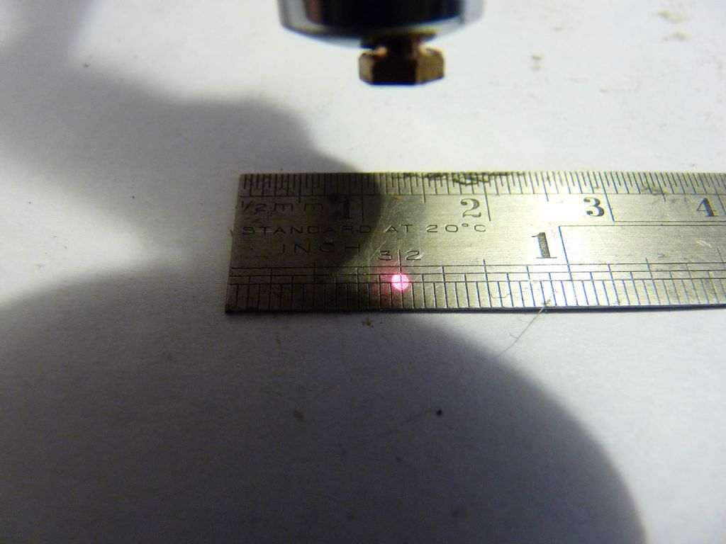

                                  #192080
                                  Vic
                                    @vic
                                    This is what I'm getting from my work in progress, looks like it will work pretty well I think.

                                      #192110
                                      Vic
                                        @vic
                                        It's the one in this picture John, 1mw 6mm from eBay. UK seller and cost a few quid if I remember.
                                        #192115
                                        John Stevenson 1
                                          @johnstevenson1
                                          Vic,
                                          What is the spacing between the rails, to give some idea of scale and did you need to use anything to focus this with please ?
                                          #192124
                                          Vic
                                            @vic
                                            Hi John, it was tracing a circle of about 23-24mm on the bed of my mill. I made a small aluminium "can" in which the laser sits. The bottom of the can has a .65mm hole drilled in it to "clean" up the Laser output. Without it most lasers give you a rather large oval than a dot. This is what you get with a suitable aperture:
                                            #192125
                                            Vic
                                              @vic
                                              This is the setup I used for a quick demo, I still need to work out how to mount the battery. I'll probably use a CR2 instead of the button cell used in the test, any 3V battery will do. If you have some scraps lying around you can make one of these for under a fiver including the battery! Mine is fully adjustable for angle so should suit lots of work pieces.
