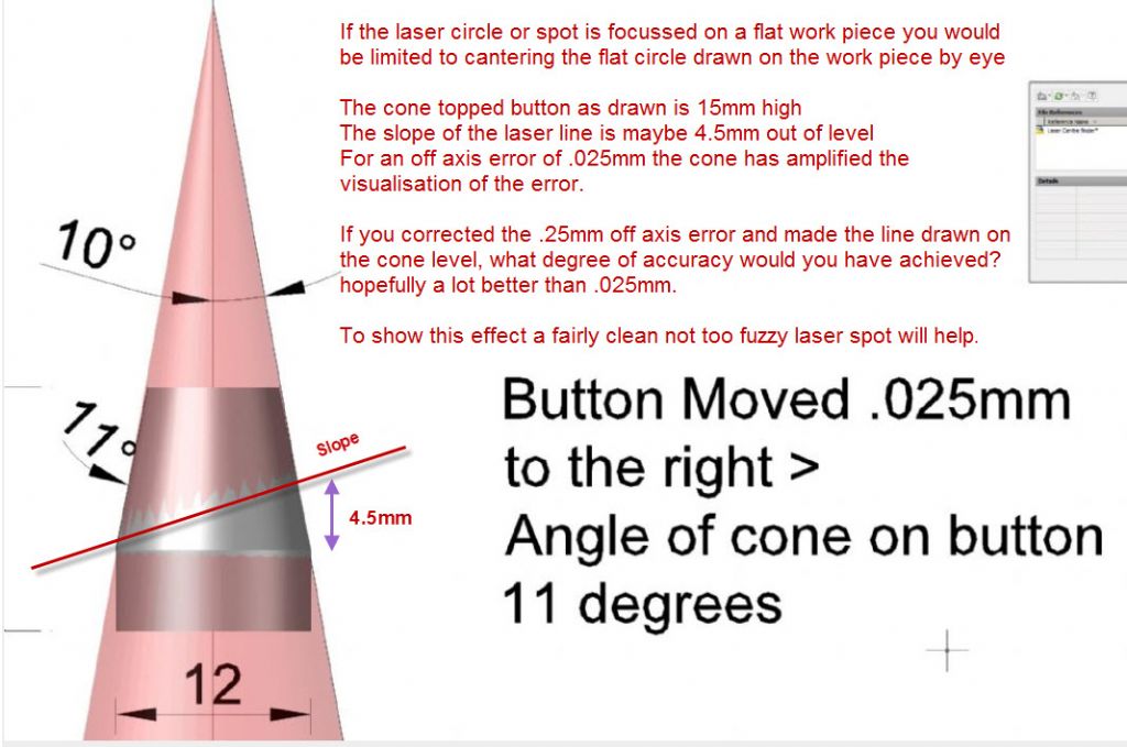

            Hi Garry
            The cone was discussed a fair bit on the second page of this thread.
            **LINK**
            My thinking was that a small cone shaped object may increase the accuracy of the devise when locating on marks on the surface of a work piece where the laser strikes at a constant depth.
            The cone provides an amplified slope to the horizontal of the laser unless the laser line (Circle) is cantered in a similar way Mr Gelbart shows V when locating over a cylinder.
            As soon as I can get my hands on a decent pointer I am going to make one and test the theory out.
            This is the first centre finder design I have seen that overcomes the zeroing in problem that laser pointers cantered in the collet or chuck have, and it does not matter if the laser spot is asymmetric when it rotates. Two sources of error eliminated.

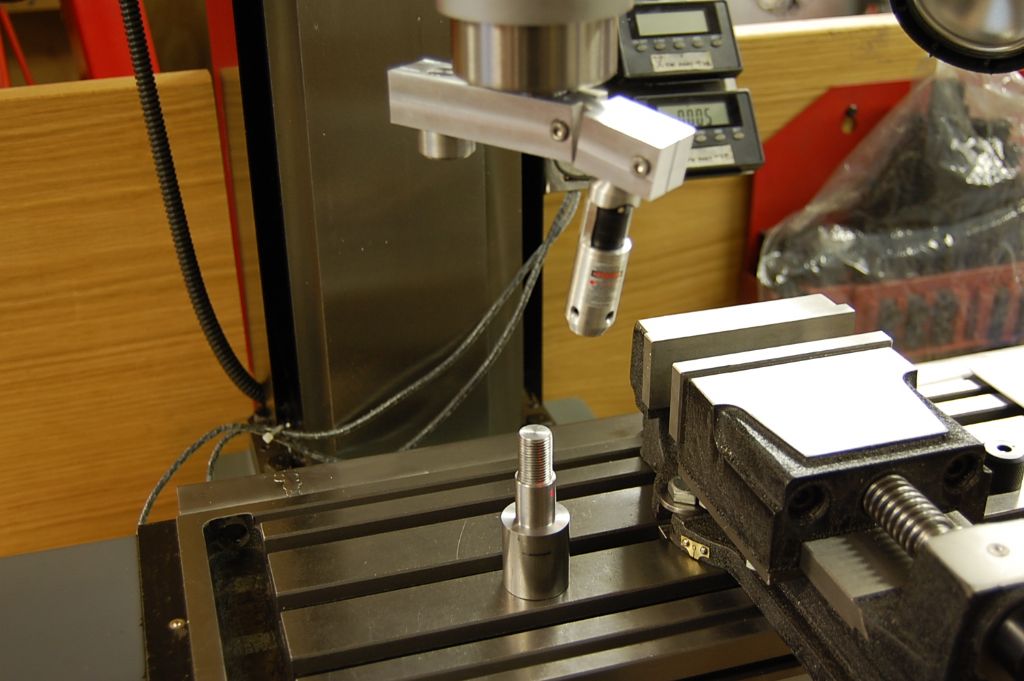

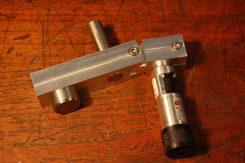

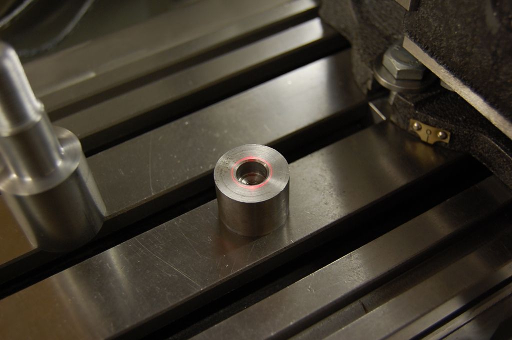

                Thank you to John for pointing us to the Dan Gelbart series. I have watched all 18 and they are excellent. It's a delight listening to someone who understands the science behind why stuff happens.
                His part 15 of 18 demonstrates the rotating laser centre finder and I was intrigued, as others in this thread have been. Never mind the theory that has been discussed, I decided to make one and try it out. It uses the commercial laser centre finders that have been discussed (here and ME?) before and fits into a 1/2" collet. I made the angle adjustable but it worked at the first try which is around 10deg from the vertical (20deg cone).
                The image worked at around 600 RPM and the polarising cap had to be removed to see it well. I obtained lovely tilting circles on machined steel for upright bar and holes. Dan Gelbart is exactly right (and who wouldn't believe his every word) when he claims 50 micron alignment precision. In my language that is two thou 0.002" and that is my estimate of what's achievable.
                I have been using the static, vertical laser to find centres and edges and with the eight thou spot size would have to try hard to get +- 0.004. Now, this device is a magic dream. I have put three photos below to show the device. I have also made a quick video and posted it on this link in case anyone has not seen the Gelbart original film.
                Video Link
                Who else has just made one?
                Norm.

                  Hi Garry Wooding
                  Maybe this will assist.
                  Regards
                  john

                    Hi Norman Lorton
                    Well it looks like you get the first prize…. The first Rotary laser pointer off the production line
                    Nice Job and a good video.
                    Can you machine up a button cone and test it please?
                    One with a small angle difference please. I notice you have made the angle of yours adjustable.
                    Great to see it in action.

                                            Michael, I thought about the rotary table and a centre (cone) sticking up from the Morse taper, and decided to try it on my newly built kit. A few minutes later I realised all this talk about conical surfaces might be off-target.
                                            Let's think about how the basic Gelbart idea works. A laser beam at, say, 10 deg strikes the vertical surface of a rod and draws a horizontal circle around that rod if the beam rotation centre is exactly coincident with the centre of axis of the rod. Displace one of the axes and the drawn circle will be distorted (to some sort of ovoid, but not egg shaped, neither is it an ellipse) and no longer horizontal. As you reduce the angle of beam incidence any misalignment of the two axes will amplify the distortion and further tilt the circle. When the incident angle is zero degrees then the sensitivity becomes infinite.
                                            It follows that if you increase the incident angle, for example by making the rod into a cone, then the sensitivity of the rotating laser, in indicating the centre position, is reduced. My thoughts are that this negative effect of a cone applies to the conical buttons theory (sorry John and Michael). I recon that the buttons will however work well if they are conventionally parallel and stick up about 1/4", but are quite wide, perhaps 1/2" diameter or more.
                                            I played with my rotating laser last night and found it more sensitive at 9 deg than at 11 deg, such that finding a datum point better than +- 0.001" in both axes seemed easier. You also need a target of around 1" diameter to properly judge the laser line being horizontal, at this sort of precision
                                            If I'm wrong on the cones I will eat plenty of pie, but I think they exited stage left with a few Dodos.
                                            Regards, Norm.
                                            I am adding this edit to clarify that all the above assumes you are working in the cone area above the laser point of intersection.  If you want to work in the conical area below that point, then conical metal targets become useable, but only if the the total target cone angle is greater than the total laser conical angle; ideally around 20 deg more so that the incident angle is around 10 deg.
                                            Edit number two: Hmmm, perhaps I should eat some pie as I now see from his diagrams that John was talking about using the laser cone below its point of incidence; sorry John for trying to kill off the cones. The problem with working in this laser cone area is that the distance from machine head to table starts to get a bit bigger.
