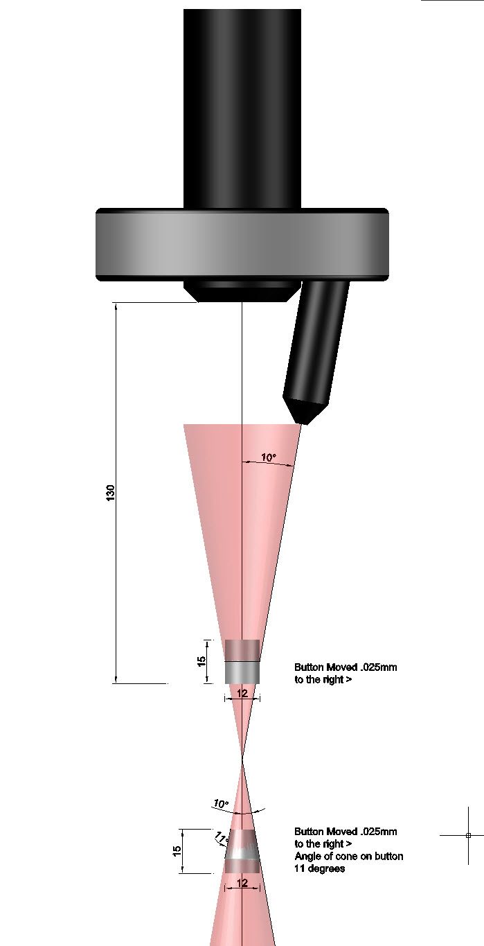

            I think Michael Williams has sparked an Idea with toolmakers buttons.

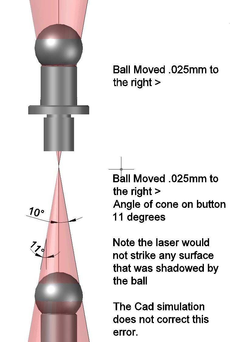

            He got me thinking and I sketched up using AutoCAD how a 12mm wide by 15mm high button might show up with the cone of the laser beam directed upon it.
            For the test I have displaced the button .025mm to the right therefore it is off the axis of the machine by that amount
            I have angled the rotating beam 10 degrees from vertical.
            As the image below shows the line of the intersecting laser beam does slope as would be expected.
            However not a lot. Thinking on this It made it clear that what was needed was that the beam and should strike the button at a smaller angle. This would amplify any spindle alignment error. An angled button would be better but that would be very difficult to place on the work, I therefore drew another button the same size but with a chamfer on it leaving the base parallel. This would make it easy to place the button in the normal way. while providing a surface for the laser to strike.
            As the following illustration shows the angle of the striking is now much greater as expected The cone displays the error very graphically over 5mm out of level. (note the displacement was not changed at .025mm) There would be little problem in correcting the .025mm error to maybe a quarter of that by levelling the cone.
            AutoCAD was even kind enough to make the edge of the cone fuzzy as it would show to a lesser extent with the laser. Reviewing Dan Gelbart's video confirms this the image was quite clear when he applied the laser to the side of a bar to centre drill it.
            He mentions 50 micrometre accuracy for his tool that's a fraction less than .002 inches. I guess he believes that is the minimum accuracy for all measurements possible with this tool? Cone on Cone I believe we can do a considerably better.
            Marking out to .001 inches is possible on a good day but we must add to that the error left by the spotting drill starting off axis… And that was on a good day.

              Clarification of the following sentence in the above post, it is not Clear.
              Should read
              Marking out (with a centre punch) to within .001 inches accuracy is possible on a good day but we must add to that the error left by the spotting drill starting off axis… And that was on a good day.
              The laser pointer can do a lot better than marking out… particularly when focussed on a toolmakers button with a chamfer.
              Regards
              john
              #141712
                John,
                Thanks for the AutoCAD demonstration of concept.
                … Very useful diagrams.
                Edit: If it's not too much trouble; would you be so kind as to try an Ickey Ball in that sketch.  I feel sure that this would be a superb way to set an "origin" datum point.
                Edited By Michael Gilligan on 26/01/2014 09:26:07

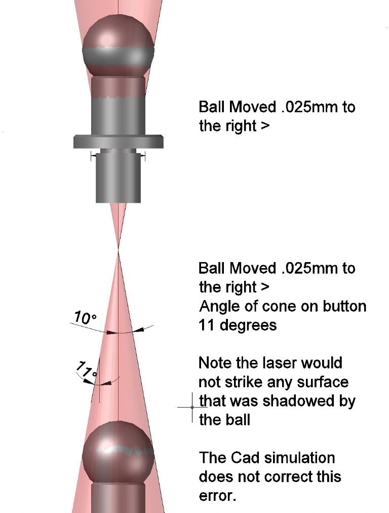

                      The Ball target as requested….
                      The cone works better, you need the length of the flat surface of the target cone to show the error. The small degree of difference between the beam angle and the cone angle is what does it. My example uses one degree, less than one degree might even be better.
                      it would also be a lot easier to make on the lathe. Just bore the hole, turn and lap the cylinder to exact size then and chamfer to form the cone and carefully part off. With care it should be pretty accurate, Not hardened but good enough for most work.
                      Regards
                      john

                                Hi Michael H
                                For referencing a workpiece A ball is not as good as a cone for centring with a Laser as shown above. However If you drilled and reamed a master hole in a piece that was to be removed and replaced in the mill several times you could place the cone target in the hole and reference the machine to that point each time. Or screw the reference cone to the workpiece for the duration of the job. making it absolutely rigid,
                                Various referencing targets could be made with different size spigots for different size holes,
                                Toolmakers buttons (with a chamfer for the laser not shown in the link below) just need a flat base to be screwed onto the work. **LINK**
                                Regards
                                john

                                      Posted by John McNamara on 26/01/2014 10:33:29:
                                      Hi Michael
                                      John,
                                      Sorry to labour this, but I've just realised that you have the light shining on, or near, the equator … I wonder if it would give more useful results if incident somewhere near the "Tropic of Cancer". [?]
                                      #141743

                                            John McNamara
                                              @johnmcnamara74883
                                              Hi Michael G
                                              Alas placing the beam on the tropics does not help make it more accurate.
                                              The beam strikes the ball at too steep an angle. It is confirming the beam is close (within .025 inches) but for greater accuracy you need a cone. Dan Gelbart quotes 50 micron typical accuracy. But he does not mention a cone.
                                              The cone is the best way with a one degree or less difference to the beam. Its a bit like; actually the same as the shadows getting longer near the sunset…
                                              There must be a geometer in this forum who can express it mathematically.
                                              Regards
                                              #141747

                                                  Posted by John McNamara on 26/01/2014 15:28:01:
                                                  Hi Michael G
                                                  Thanks again, John
                                                  What I was hoping was that the circle of light would become emphatically ovoid when the ball was displaced from centre. … But, thinking further; that would only be obvious when viewed from above.
                                                  #141750
