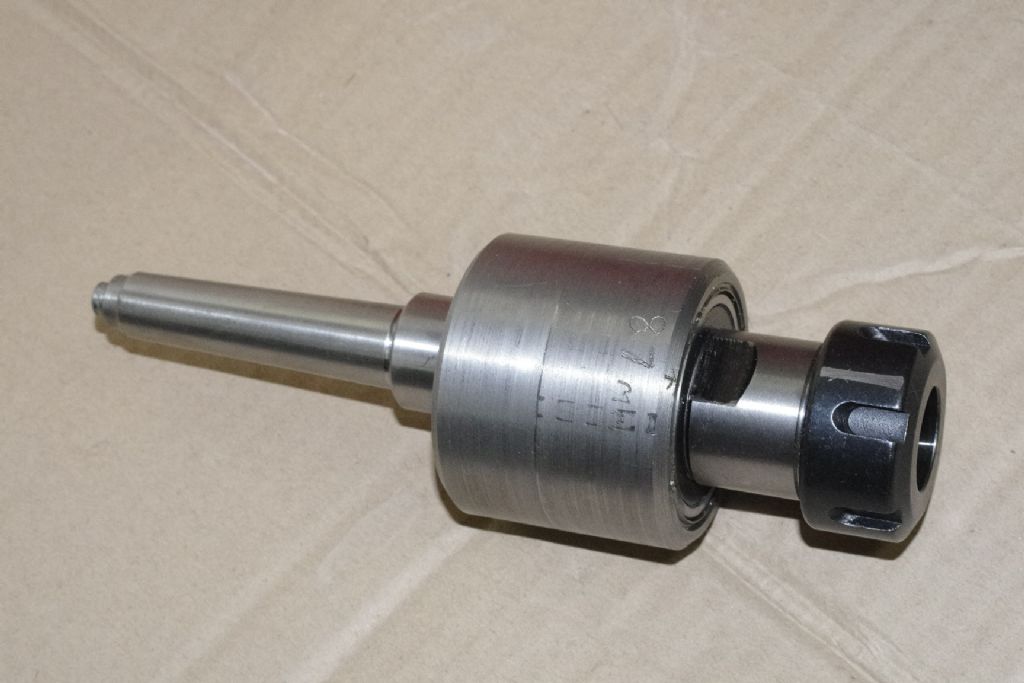

      I made one with an er25 collet with a pair of bearings on a MT2 shank. The cutting end of the tooling must project exactly to the null point or the tool won't work. I marked the length on the body whan I made it.

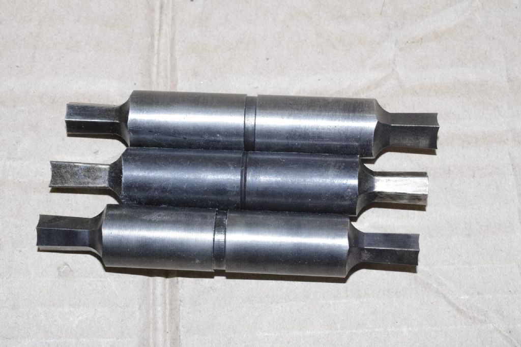

        Daniel , there will be 6 points of contact as it rotates and each point comes into contact once per rev. Out of interest I have made two of these , one to my own design and one of Hemingways design and both work well.

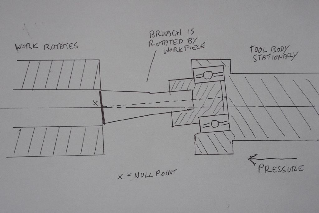

              As Malcolm very insightfully put, you should see no wobble in the broach, it merely turns on its axisbut the axis is off-set to the axis of the holder making it cut.
              Wobble broaches do not spin with the work, they are merely driven by a holder which wobbles. This is a wobble broach I made quickly to cut a 12mm hex pocket. It doesn't turn with the part as you can see.

                  _igp2487.jpgThis is what mine looks like, the null point is 87mm in front of the body, as marked. The angle it was made has been forgotten, but 1 degree would seem a good guess, hence the reverse taper on the tools to stop them fouling the hole.

                    Hi Daniel. 8mm hex so far, I don't tend to do big stuff.

                      The broach will turn with the part if the part is being broached in the lathe
                      And this one shows how the broach "wobbles" putting the load onto each corner at a time

                        When you design a rotary broach the exact angle and offset of the bearing housing must be calculated as well as the position of the null point where the cutting takes place.

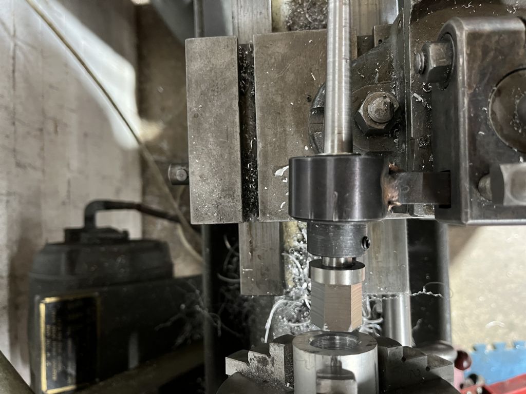

                                          It’s a good point but this is the bit I can’t get my head round. Surely if the holder was as per that slater diagram, then the cutting tool would just rotate on its own axis so as long as you centre it, the null point is irrelevant. As opposed to if the hole in the centre of the holder where the tool clamps was drilled offset, then you’d get ‘wobble’ when it spun? But what do I know.
                                          Anyway this was todays creation (sorry I couldn’t work out how to rotate the image):

                                                  My most successful broaches are ground from HSS blanks and have successfully broached 1.5mm squares, nobody more surprised than me!

                                                      Seeing the photo of the large tool in the rotary broach makes me understand why the broaching was a failure. You would need tons of pressure and the broach is bigger than the shank of the tool. Think of the cutting end of the broach being rotated with the workpiece and moving like your finger would if you pressed it onto a surface and rocked it about in a rotary motion. The tip of the finger does not move about sideways at all. Iwould take the workpiece and the broach cutter, not the broaching tool to some local engineering workshops and ask them if they can do the job for you. The hex could be cut on a shaper if all else fails.
