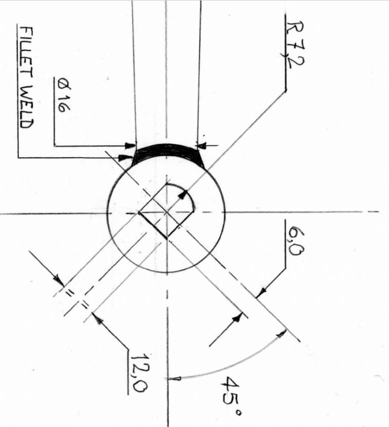

        I've an 'ole to make in a valve 'andle boss, like this:-
        I've a dozen to make, so I don't want to be filing out the radius and corners. People have suggested milling out a 12 mm wide slot in the bar the bosses are made from before parting, and then welding in a segment of a matching disc with a 14,4mm hole in it – but I've done no more than a couple of hours welding in 73 years.
        So I'm wondering if it'd be easier to buy/make a rotary broach?
        …and could it make such a hole?
        …or does it require balanced material removal all around, as in regular polygons?

          I think you may find it a difficult shape to broach, for one reason making the broach and also if the angular timing of the shape is important and if its only 12 to do think how your filing skills would improve!

            Looking at a company that makes rotary broaches web site, it would seem that it may be possible. The problem may be removing enough metal before broaching to get the broach to cut easily. When broaching a square or any shape that can be scribed in a circle requires a pre drilled hole slightly bigger than the final across flats size. It would be easier to just make a simple broach to form the hole in a press than lathe.

              I was thinking of a slot drill a bit over 12mm, fed over by about 1,2mm to elongate, and touch the rad inside. Still means there'll be more to take out where the rad corners out to the parallel faces than there is in the square corners.
              A multistep broach looks a lot more complicated to make.
              The angle can be set when welding the boss onto the handgrip part.

                      Is it me or are the dimensions wrong in the drawing? A 12 x 12 square isn't cut by an R7.2 arc as shown.
                      In his first post Mick mentions using bushes made from a rod with a slot milled in it. That's what I would do, and braze them.
                      Maybe the handle is designed with an asymmetrical socket with one curved side because a slotted bush of the required shape is easy to make and to fit into a round hole. The designer intended it to be fabricated with a bush? I could be completely wrong – maybe asymmetry is to stop the handle of a safety critical valve being fitted at the wrong angle, in which case a weak brazed bush is dodgy.

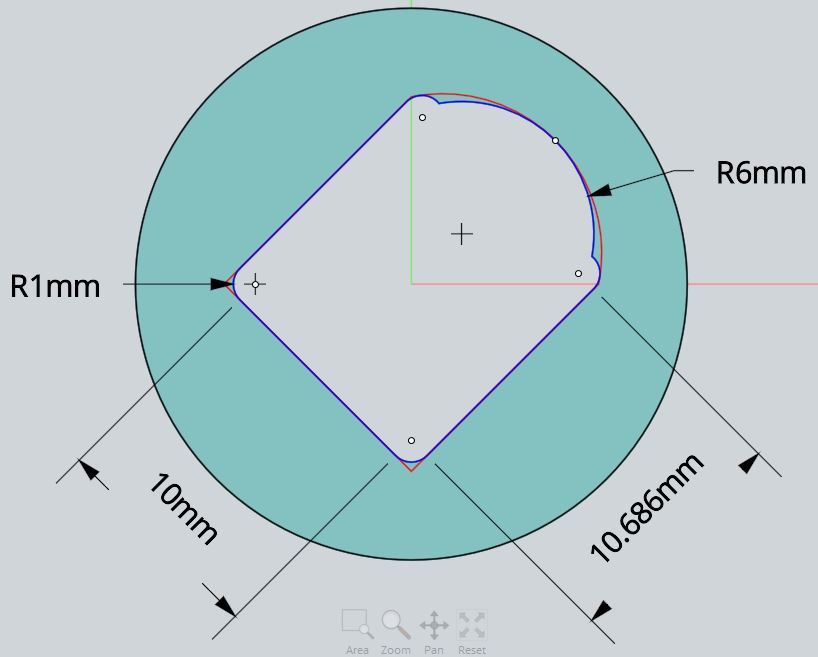

                                  Plunge into the centre with a 12mm milling cutter, move the table by 3.22mm to remove the majority of the material in the radiused area.
                                  Using a 2mm diameter milling cutter to square off the hole, travelling 10mm across the bottom and 10.686mm along the sides should give you something like in the picture.
                                  Finish the corners with a file.

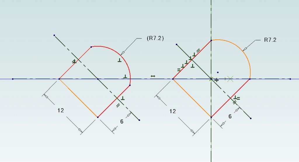

                                      Posted by SillyOldDuffer on 01/06/2023 21:14:22:
                                      It depends how you read the drawing, if just going by th e12, 6 and 7.2 dimensions you get one shape. If you assume the other two parallel sides are 12mm you get another shape. I would want to find out which is correct before making the hole as methods may need to be altered.
                                      If the valve shank was "milled & turned" as Mick says then then that raises questions as neither could be turned without the tool taking the corners off the "square" part

                                        Well, if I'm remembering the conventions I once used as a Tool Designer, that 7,2 rad is thrown from the CL of the boss,and there's only one way to read it.
                                        You're quite correct that the milled flats on the mating shaft leave a narrow line of turned diameter on the 'corners', and that might leave theoretical scope for milling the hole (as in eg. Blowlamps drawing), but with the boss being 22mm thick, trying it with a 2mm dia. endmill doesn't look an attractive proposition.
                                        I've shaped out keyways and square corners before using the carriage handwheel, but with a dozen to do I'm imagining the blisters already… surpriseblush

                                          By the same token you could say the corners of the "square" extend to the two ctr lines on the drawing which they won't if the 7.2 is from where the two lines cross

                                            Yeah, but most drafting sheet blanks have 'Do Not Scale' pre-printed on 'em, so the dimensions and conventions are supposed to take precedence over mere appearance!
                                            Perhaps I should've put an 'NTS' by the rad dimension, because it clearly is. But hey, I'm a volunteer, and I do these drawings so I don't have to keep measuring every part the railway ask me to copy.
