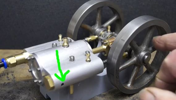

                              Is that hole open?
                              Also make sure the brass fittings don't have too long a thread which could be blocking the hole from cylinder to valve chambers.
                              Edited By JasonB on 03/04/2020 16:20:16
                              #462118
                              Ron Laden
                                @ronladen17547
                                No Jason it has a M4 grub screw locked in there and I will fill over the top on finishing. Also the fitting threads are short of the cylinder hole.
