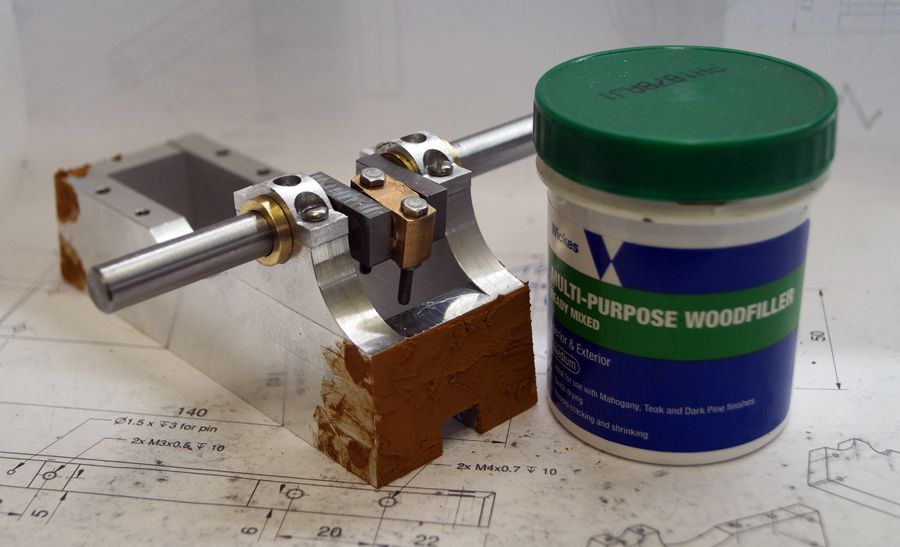

              Starting final assembly or at least to the testing stage prior to paint, first job is fill the frame ends and fixing holes to lose the made from bar stock look. Yes I know its wood filler but I have used it in the past on numerous materials, its good, quick drying, dosent shrink or crack and easy sand.
              I also lapped in the exhaust valve this morning, the inlet valve seat is in the screw in brass inlet seating which is fine but the exhaust seat is machined into the cylinder body which in my case is aluminium. I noticed that there was some very slight chatter in the seat face so lapped it out.

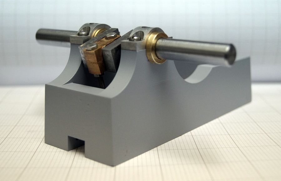

                                  The frame casting machined up well..wink a nice curved fillet around the feet when fitted should add some more of a casting look.

                                      Looking good, you can also get a bit more of a "cast" look by knocking off all the external corners with a file or Dremel so they are a bit more rounded and not so regular.

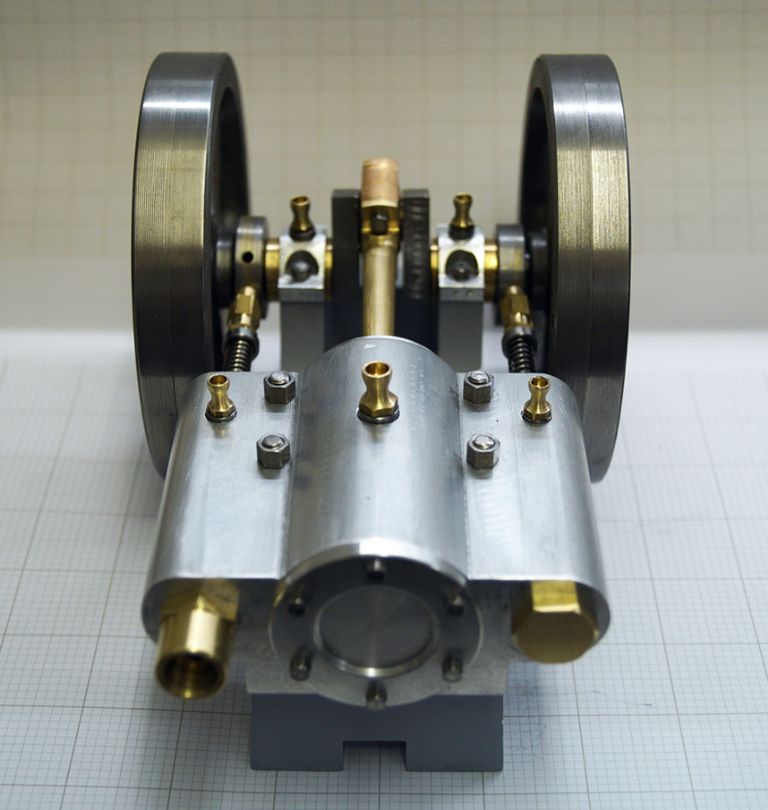

                                        Ready for a test run just waiting for an airline fitting to arrive, first time setting up eccentrics I think I have it right but we will see. Should it run ok just a few small jobs before paint, fit and blend in the feet plus a bit more shaping to the base frame, make and fit an exhaust and a finishing cut to the flywheel rims.

                                              Jason, you were quite right re the piston, now the engine is assembled it feels really good turning the flywheel it is really smooth. A good flick of the flywheel and it spins about two and a half times but it doesnt stop abruptly, I know you said yours spins about six times but mine is not yet bedded in so hopefully it will improve.
                                              #461541
                                              Ron Laden
                                                @ronladen17547
                                                Having a tea break, I have been playing with the engine for over 3 hours and cant get it to run, something is amiss but I cant fathom what.
                                                #461547
                                                  Is there any sign of the piston moving on the power stroke away from the head?
                                                  Have you plugged the holes on the outside of the cylinder?
                                                  Edited By JasonB on 01/04/2020 16:20:13
                                                  #461554
                                                  Ron Laden
                                                    @ronladen17547
                                                    Yes Jason when I flick it over it sometimes manages an extra rotation on its own as if its almost there. Also with the air on if I slowly turn it over I can feel what seems to be good compression as the piston approaches TDC..
                                                    Edited By Ron Laden on 01/04/2020 16:28:01
                                                    #461557
                                                    Ron Laden
                                                      @ronladen17547
                                                      Yes I have the holes plugged, how critical is the timing..?
