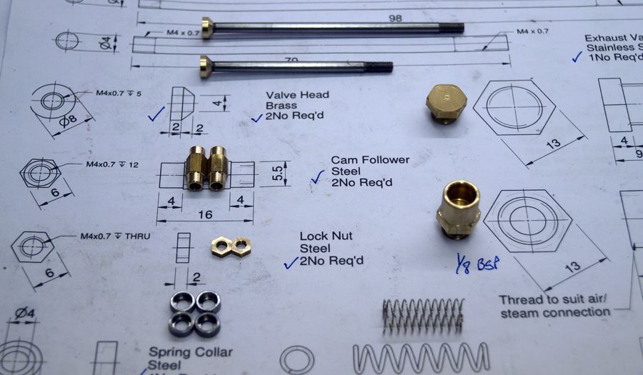

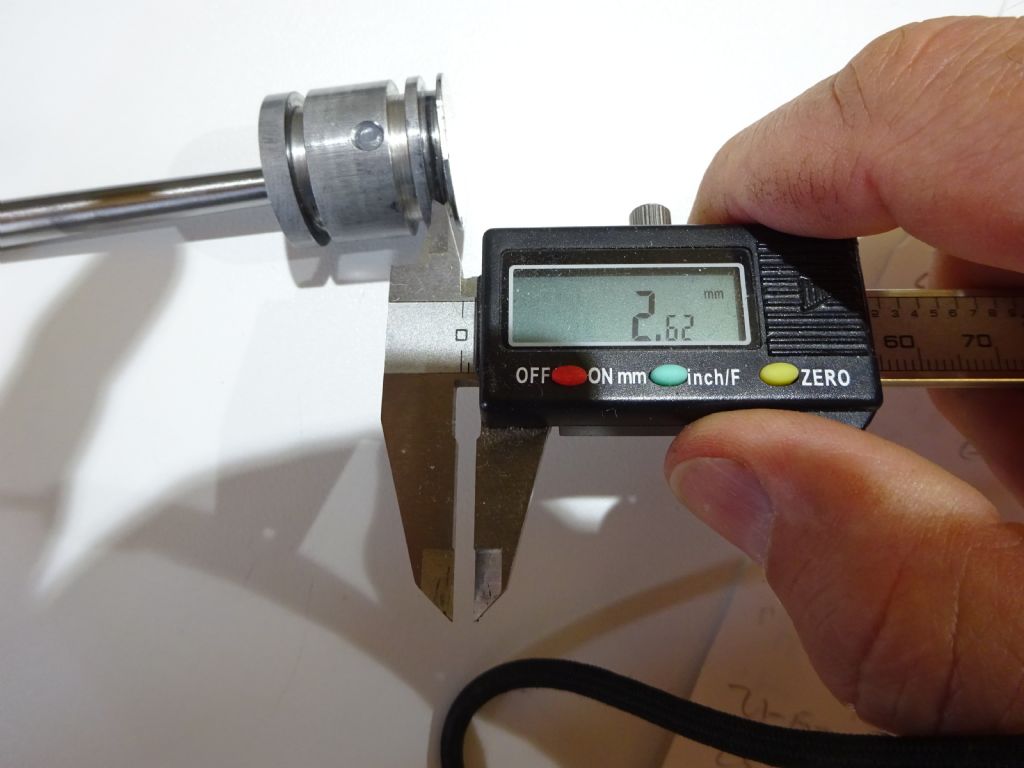

      Life gets in the way sometimes but managed a few hours in the shop yesterday and produced the valve parts.
      I used brass for the cam followers and lock nuts as I had 6mm hex on the shelf but no steel hex. I cut a pair of springs from what I had they are 5.5mm dia instead of 6mm but they are correct in wire gauge so hopefully ok. I slipped the inlet valve into the seat and held it vertical so it was just the weight of the valve resting on the seat and I couldnt blow through until I lifted the valve it so that seems good.

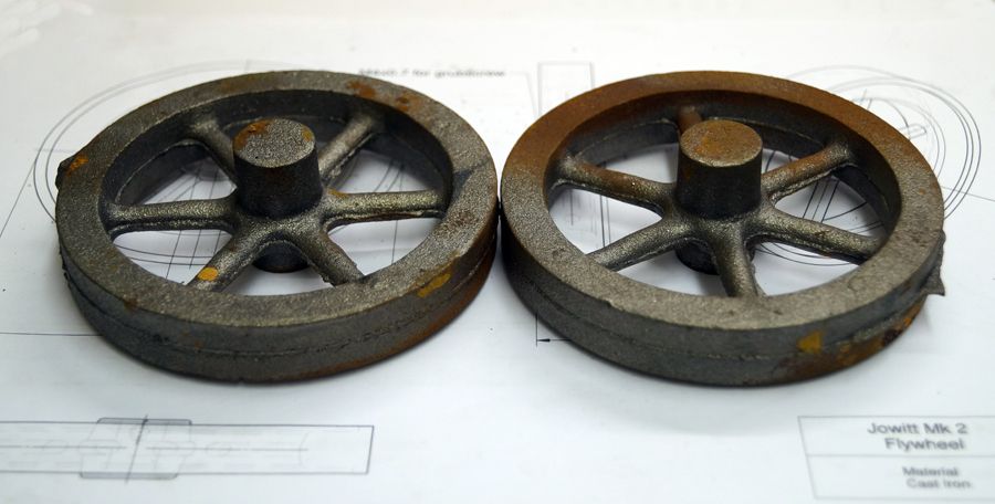

            I have a pair of Perseus flywheels on the way, Chris Gunn was good enough to sell me a pair. You probably know but Chris built 4 engines and had a fifth pair of wheels left over from a bulk buy.

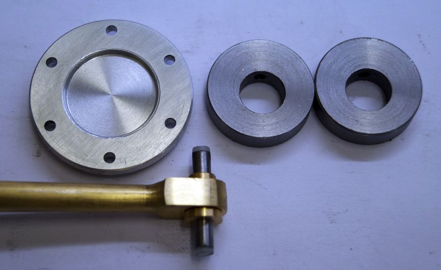

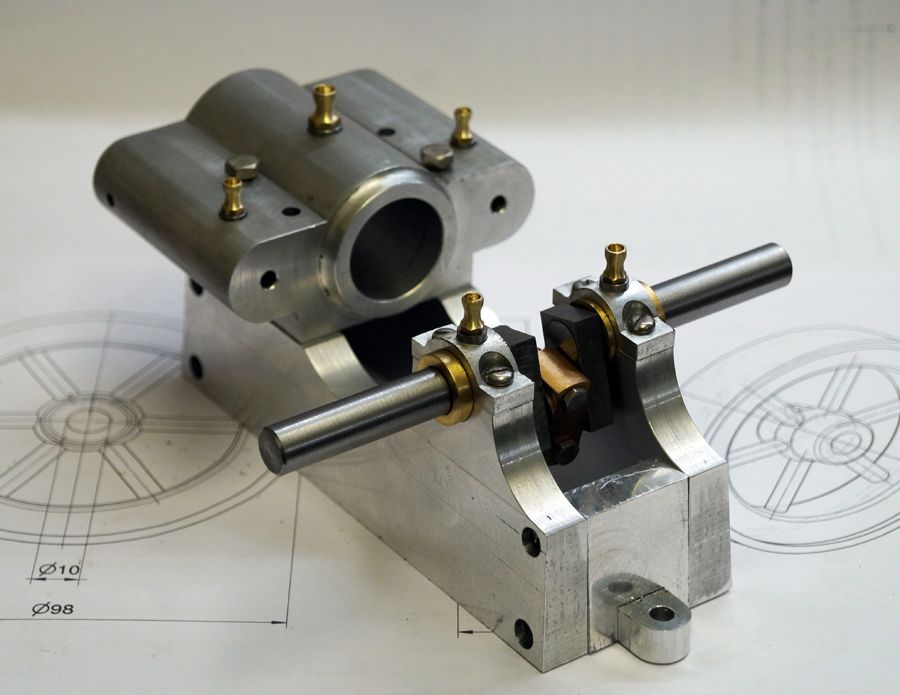

              Playing catch up so was up bright and early and managed to get some more done. The cylinder end cover, a pair of eccentrics (need a finishing cut) made and fitted the small end bearing plus made and fitted the wrist pin end pads.
              Only the oil cups and flywheels to do and I will have all the parts.smiley

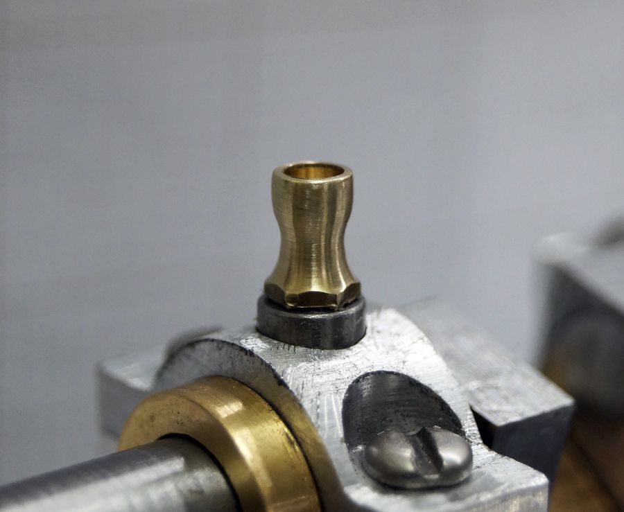

                My take on an oil cup, not quite the sexy shape as on Jasons drawing but I am quite pleased with it. I shaped it by hand using files and emery.

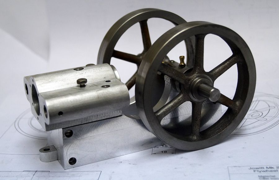

                                            The flywheels complete the parts list, now the fun begins or at least I hope it does..smiley

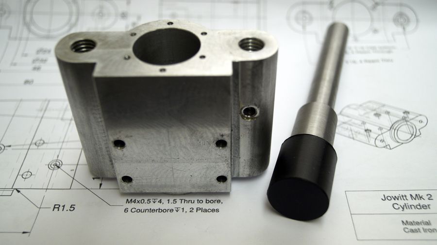

                                              A bit of an experiment that I hope will work, I have made a lap for honing the cylinder. I used a piece of wooden dowel on the little Muncaster cylinder which worked fine and I was going to do the same on the Jowitt but I have no suitable sized dowel or anything close other than metals.
                                              So I have turned up a piece of 66 nylon to size and hope it will do the job, will let you know.

                                                Well it worked fine, couldnt see why it wouldnt got a nice fit between the cylinder and piston I finished with 1200 grit so have a nice surface for the O rings to run on. I think I may well use nylon for any future cylinders.

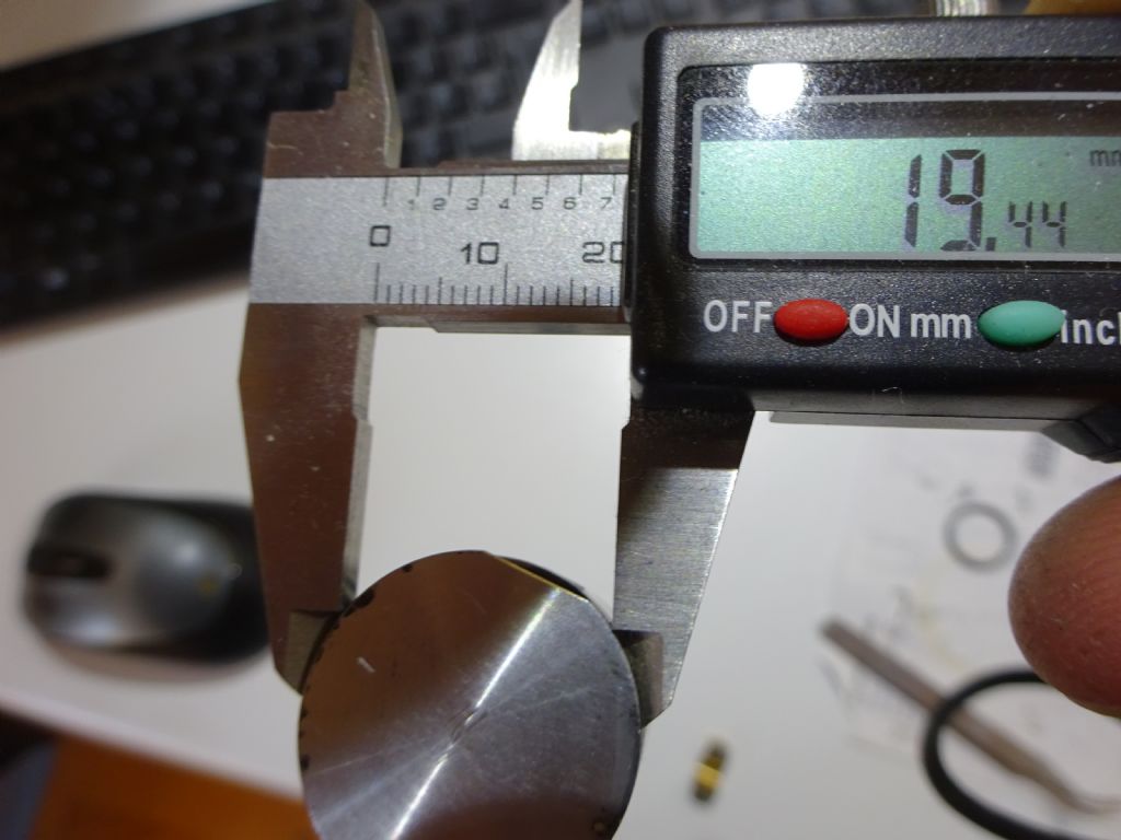

                                                  I have hit a problem or at least I think I have, yesterday I honed the cylinder and managed a good finish from end to end. This morning I thought I would try the piston with the two O rings fitted to see how it was looking but it was way too tight. I checked the dimensions, the cylinder is 24mm at the crank end and 23.99 at the other, the piston is 23.95. The O ring grooves were spot on as per the drawing 19.4 dia and 2.6 wide and the O rings are to the size recommended.
                                                  I removed the lower ring just leaving the top one and it was a bit easier but still too tight. I bit the bullet and reduced the ring groove from 19.4 to 19.3 and it was a bit easier but still too tight so took the grove down to 19.2 and easier still and thats where I am now. Having no experience of this I dont quite know what fit I should be looking for with O rings. I can slide the piston back and forth but there is some resistance which I would expect but is it too much..?
                                                  I watched your video a while back where you showed a piston slowly creeping down the cylinder under its own weight, cant remember if that was an O ring piston but if it was mine will not do that.
                                                  Can you advise what I should be looking for fit wise.

                                                    I would not go any deeper at the moment Ron, you will get a certain amount of initial bedding in of teh o ring which may well be enough to loosen things up.
                                                    Just took mine off the shelf and it will free wheel for about six turns with a flick of the flywheels that's with teh cam followers pulled back off teh cams. Then took the big end cap off and pulled the piston & rod out and there was quite a bit of resistance (one ring in the top groove) so I would say assembly and try it out.
                                                    A trial assembly without any rings would be a good idea just to check for tight spots as you can't feel them as easily with any ring resistance.
                                                    That video was just the turned piston with no grooves or oil so minimum drag

                                                      Thanks Jason, I will carry on just hope I havnt gone too deep at 19.2mm, I see yours is ok at 19.44.
                                                      One thing I meant to ask, is there any danger of the bottom of the piston touching the cylinder wall when fitted with just the top ring. It crossed my mind as if it did mine would be alu to alu but looking at your picture yours doesnt appear to have done that.
