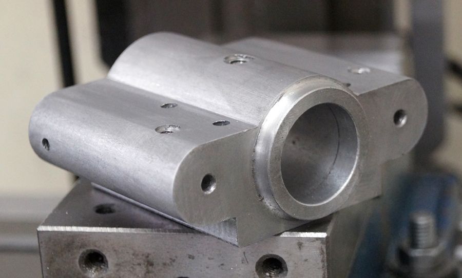

          Started the cylinder shaping using the exact same setup as Jason shows in his build thread, it works a treat.
          One pass for each turn of the R/T handwheel (4 degrees) it certainly produces a good radiused finish, cant see it needing much work with the files to blend in.

                The most involved part just about there, things should speed up a bit now.
                #454708
                  Looks good Ron and as you say the hardest part out of the way

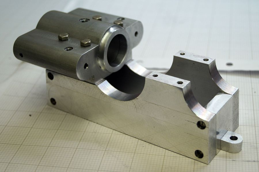

                    This morning I made the frame ends and feet which turned out well and the next job is the main bearings and caps.

                      Found a few screws just for a trial fit of the parts made so far, thought I had better check and all seems ok.

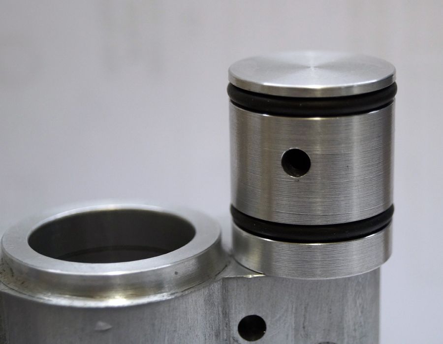

                        Well my first mistake, I turned up the piston today and bar one all dimensions are spot on to the drawing The diameter, the length, the wrist pin position, the ring groove width/depth are all good. Also the bottom ring groove position is good but the top one is 0.5mm too high, the groove top edge should be 2.0mm from the piston top but mine is only 1.5mm.how I managed that I,m not sure but thats what it is.
                        I am thinking it may be ok and not a problem in the operation of the engine, I,m sure Jason will be along to tell me yes or no. I can make another one if need be, not a problem but it seems a pity to bin it with all the main dimensions tight to the drawing.
                        #455402
                          That will be fine Ron so you can keep up the good progress.

                          Ron Laden
                            @ronladen17547
                            Thanks Jason, thats a relief, I will press on.

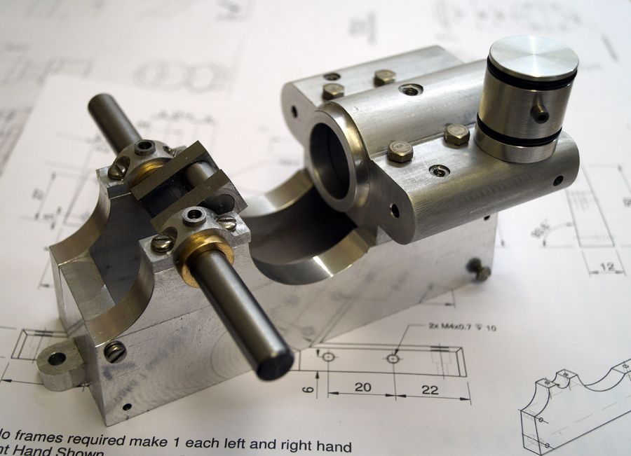

                              Progress so far, not had much shop time this week but its coming together slowly, slowly.
                              Just added the main bearings, the bearing caps and the crankshaft, the crank is a bit longer than the drawing as I havnt decided on the flywheels yet and dont want to find it short.

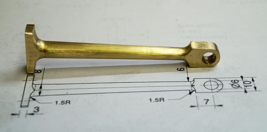

                                      I have been thinking about adding a personal touch to the engine but I dont want to change the design in any way so today the opportunity presented itself, the conrod. I have used brass instead of steel, the keep and the bearings will be bronze and the rod needs a good polish but I think it should look quite good when finished.

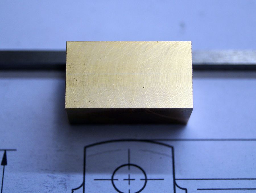

                                            I am about to start the split big end bearings would appreciate knowing the best approach for soft soldering the two halves, do you tin one side and lay the other on top and re-heat or is there a better method.
                                            Ron
                                            #456200
                                              Either tin both then sweat together or put a small amount of soft solder pain onto the joint and put together then heat.
                                              When tinning apply a very small amount of solder and wipe off excess while still liquid.

                                                Its the first time I have soft soldered any pieces of metal together, I dont have any solder paint only some 1.5mm solder wire. I cut a 1/2 inch piece of that which I pressed flat as not to hold the pieces apart too much and used a tiny amount of flux, seems to have worked a treat. The picture is almost a spot the joint, mind you it looks so thin it may well fall apart when I touch it with a cutter..lol
