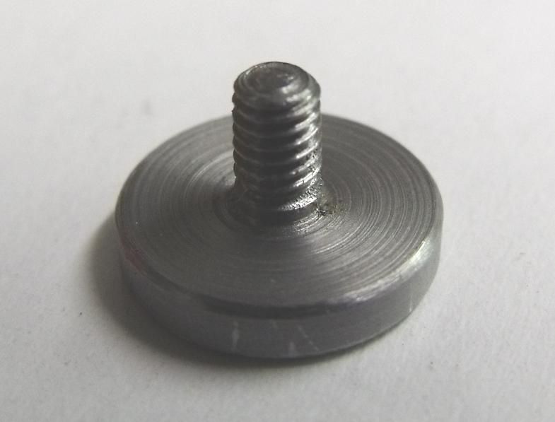

            John Baron
              @johnbaron31275
              Hi Guys,
              You really need to use an elephants foot on the dial gauge !
              This is mine !
              Edited By John Baron on 20/02/2020 21:04:46

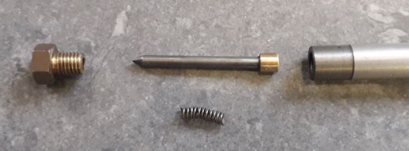

                #453359
                  Here you go Ron
                  main body has a Ctr drilled hole at one end, drilled 5mm at the other and partly tapped M6 to take the nut. Nut is reamed 3mm for the 3mm point that has a 5mm OD bush Loctited in place. Spring about Biro size or a bit heavier.
                  Drawing To Download
                  Edited By JasonB on 21/02/2020 13:46:34
                  #453363
                  Ron Laden
                    @ronladen17547
                    Thanks guys and thank you Jason for the breakdown and drawing of your sprung centre I will get one made up.

                      #453375
                      John Baron
                        @johnbaron31275
                        Posted by JasonB on 21/02/2020 06:55:20:
                        I've not found the need one you are not looking for a measurement just movement of the needle which will actually be magnified without the elephants foot so easier to see which way the work needs to move.
                        An elephants foot doesn't magnify anything ! It just presents a parallel surface to a round object.

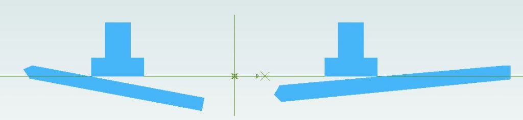

                        #453382
                          But does it present a parallel surface as the rod is tilting up and down until level, it will allow you to measure the highest part of the rod.
                          Spring is there to stop the rod loosening or tightening as the work is adjusted therefore keeping the point in the hole.
                          #453405
                          John Baron
                            @johnbaron31275
                            Hi Jason,
                            You can't have it both ways ! You are either looking for a measurement or an indication. With or without an elephants foot you will still get an indication.
                            [Quote] you are not looking for a measurement just movement of the needle [/quote] Your post.
                            The whole idea of using an elephants foot is that it provides a parallel surface to a round object. Though I do appreciate the exaggeration in your drawing to illustrate your point.
                            The idea of a long pointer is flexibility. A long thin pointer will follow the punch mark centre even if held rigid in a drill chuck at the tailstock end.
                            As far as a spring goes, yes I agree, it saves having to apply a little pressure to the tailstock wheel. My centre finder is simply a 10" inch length of 5 mm diameter rod, pointed at one end and dimpled at the other, no springs.

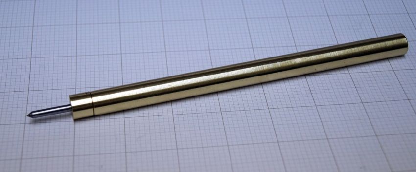

                                    Made a sprung centre this morning ready for working on the cylinder, its a delux version in Magnesium Bronze.wink

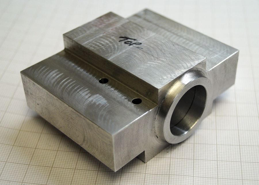

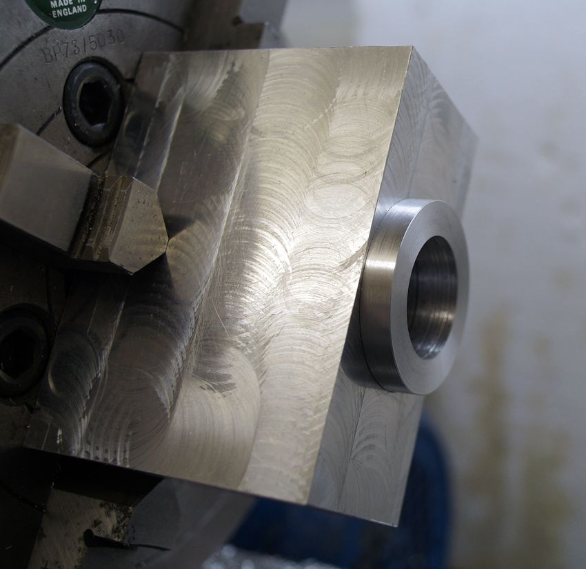

                                      The cylinder block is to size apart from adding a spigot ring, I machined it all on the mill using the 25mm end mill and its turned out nice and square so thats good.
                                      Its now set up in the 4 jaw ready for drilling and boring, I know a recent thread said the proper way is to go from the pilot drill straight to the largest drill size but there is no way my lathe will cope with that so am going with a set of drills and do it in stages. I am going to give a 6.0mm, 13mm, 16mm, 19.5mm and 22mm a try, then bore out to the finished size 24mm.
                                      I must admit I am a bit nervous about it I think the largest hole I have drilled on the mill to date is 13mm so I will see how I get on. One area where I may have a problem is the boring, the largest boring bar I have is 12mm with a GT insert which is probably too small but we will see. From 22mm to 24mm I only have to bore out 1.0mm so hoping a series of light cuts will work, but I dont know.

                                        #454020
                                        Ron Laden
                                          @ronladen17547

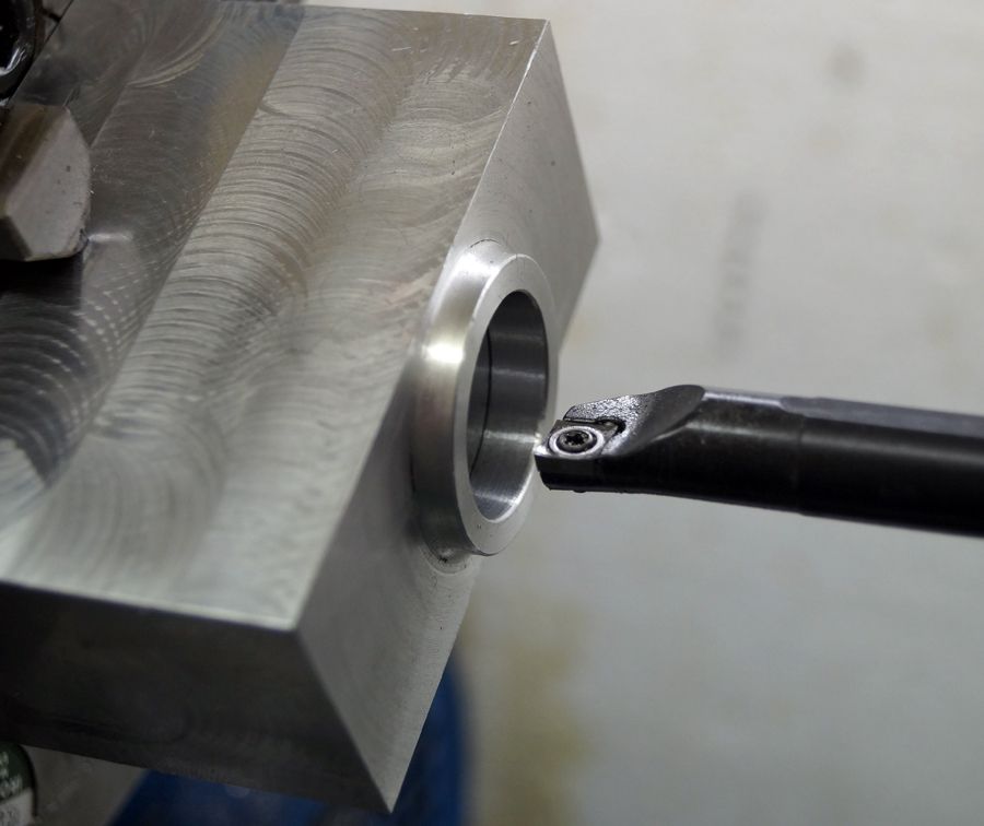

                                          I turned up a spigot ring as the alu block was just too short to allow the spigot to be turned from the end face. The spigot is fitted into a recess with 638 retainer and I have left enough meat for it to be turned to size.
                                          Next job is boring the cylinder to 24mm, currently drilled to 22mm.

                                              Up early and turned the spigot to size and bored the cylinder using the 12mm bar (biggest I have) with a GT insert.
                                              With a question mark over the size of bar I took it easy, 1.0mm to remove so went with 2 x 0.3mm passes, 1 x 0.2mm and 2 x 0.1mm all run at 650 rpm except for the last pass at 950 rpm. I may have just been lucky but as best I can measure using a Mitu Digimatic the bore is good to half a thou which over 60mm I am really pleased with.
