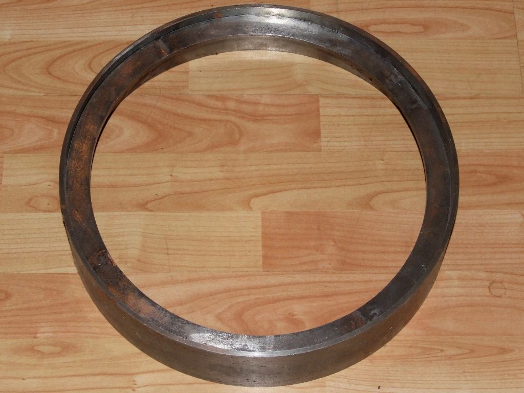

                When I made the rims for my traction engine front wheels I calculated as follows. The OD of the completed wheel is 15", and the thickness of the steel tyres is ¼", so subtract ½" to get 14½", the OD of the rim itself. The rim material is 3/16" so subtract another 3/16" to get the diameter of the neutral line, assuming that the neutral line is at 50% of the material thickness. The neutral line diameter is 14.3125" giving a circumference of 44.964". That's the length I cut the metal to; well an approximation as I used a tape measure to check the length. Once rolled and welded the rim was pretty much spot on the right diameter. The T-ring, which was welded from 4 laser cut arcs, is a tight push fit:

                    True for pyramid rolls, but not so for initial pinch rolls if you reverse the direction of the material at each pass. For rolling my wheel rims I made a set of initial pinch rolls:

                        I think it is rather more complex than that. Out of curiosity I measured the OD of my wheel rim in four places with a micrometer. These are the values I got (nominal size 14.5" ):
                        14.490" 14.480" 14. 491" 14.494"
                        I assumed that the neutral line was 50% of material thickness with a sequence of cut, roll and weld, ie, no adjustments. I used initial pinch rolls to bend the rims, so there were no flats that needed to be removed or re-rolled.
                        Intuitively the location of the neutral line will depend upon the relative compressive and tensile forces. Many formulae are quoted for bend allowances. The key here is that the bend radius is often equal to, or not much more than, the material thickness. Again intuitively for a small bend radius the compressive forces on the inside will be higher than the tensile forces on the outside, the result being that the neutral line moves towards the OD.
                        However, for rolling wheel rims, and smokeboxes, the bend radius is much larger than the material thickness, so it is likely that the compressive and tensile forces are nearly equal and hence the neutral line will be around 50%.
                        Andrew

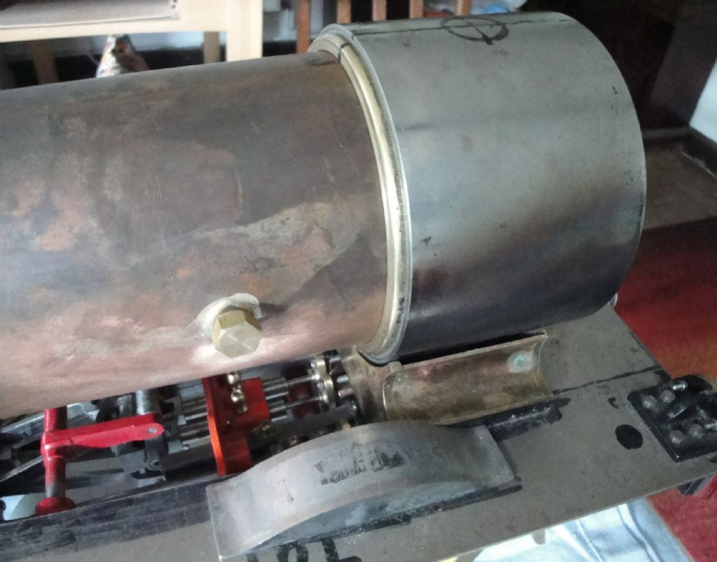

                                        Gentlemen, sorry to have been so long in replying, I can however report some success. I have now rolled up two pieces of brass using a set of George Thomas bending rolls and am very pleased with the result. I finally settled on an overall length of 17.395 inches which is 20 thou longer than pi times the mid diameter. Thank you all for your help

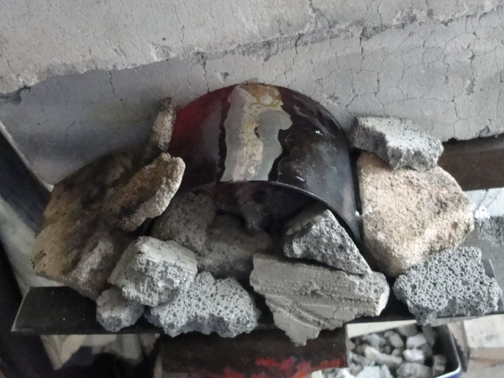

                                                I have an interest in casting come up – parts for a telescope that I can't turn up on my lathe. It will save a lot of waste too as it will be mostly a hole. He's the best source of info I have come across and watching him work generally I get the impression he knows what he is doing all round.
